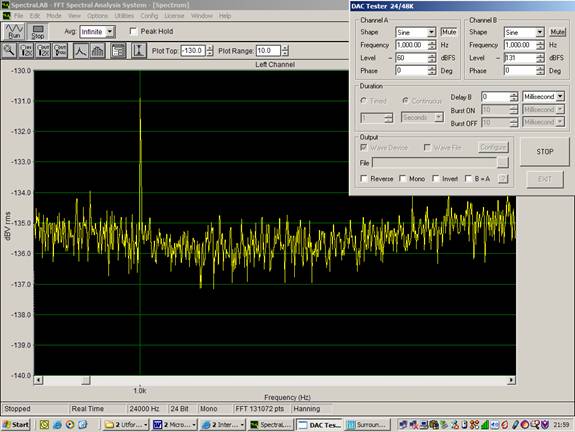

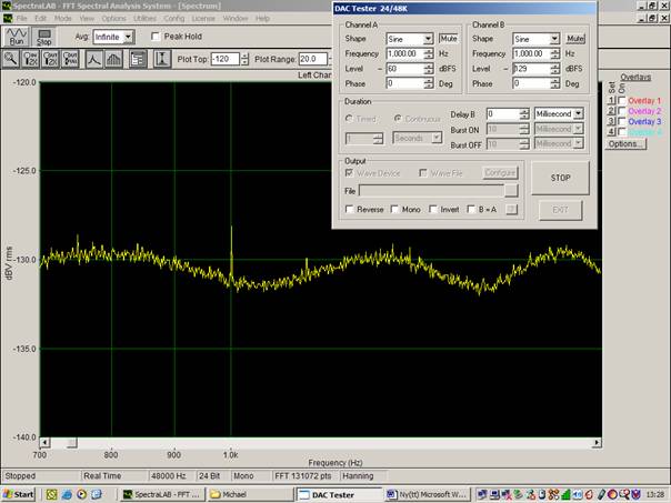

I dont think I've shown this screendump before but its from a dual diff 1704K prototype dac, actually hardwired using the DF1704, passive balanced IV and measured using some serious averaging. The signal is taken at a (I think+28dB) possible +32dB +- 50v poweramp output.
As some of you might know the human ear is pretty good at averaging so if you can play loud enough and have the material you might just hear a -129dB signal using the PCM 1704.

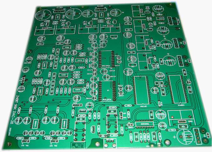

BTW, also have this board f.s. ("DAC-38" - PCM1704)
May i ask how much $$ for a board ?
