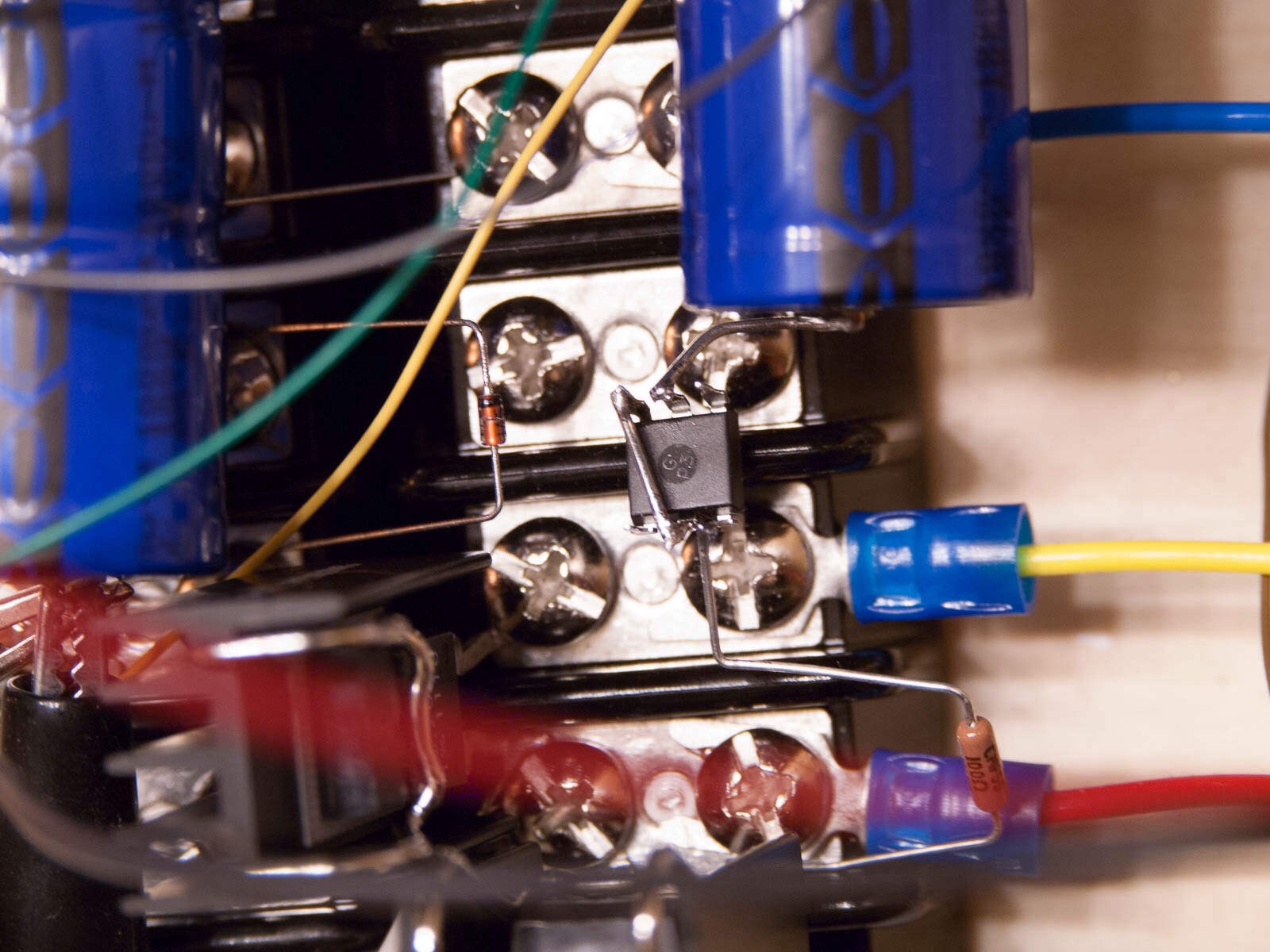

Pin 4 to (-) of 1000 uF cap
Pin 5 to (+) of 1000 uF
Pin 2 connected with pin 4 (is ok) and to midle point 0,2 R and hockey puck
Pin 1 with 100 R is ok.

It's not easy to tell the orientation of the device but Only 4 pins should be electrically connected
Well, I am completely stumped.
I traced wiring and found an error with the wiring of the opto, which I corrected. Here is how it is now connected, and is what the Generg-updated schematic stated.
1. Pin 1 to 100R
2. Pin 2 to 0R2
3. Pin 2 to Pin 4
4. Pin 4 to -ve of 1000µF
5. Pin 5 to +ve of 1000µF
But still no go. There appears to be some motor-boating at the speaker output, with DC oscillating between +15 and ??

The picture looks like 5 pins are connected. Can you take another shot at different angles. EDIT: OK looking at it another time appears I am seeing an illusion.

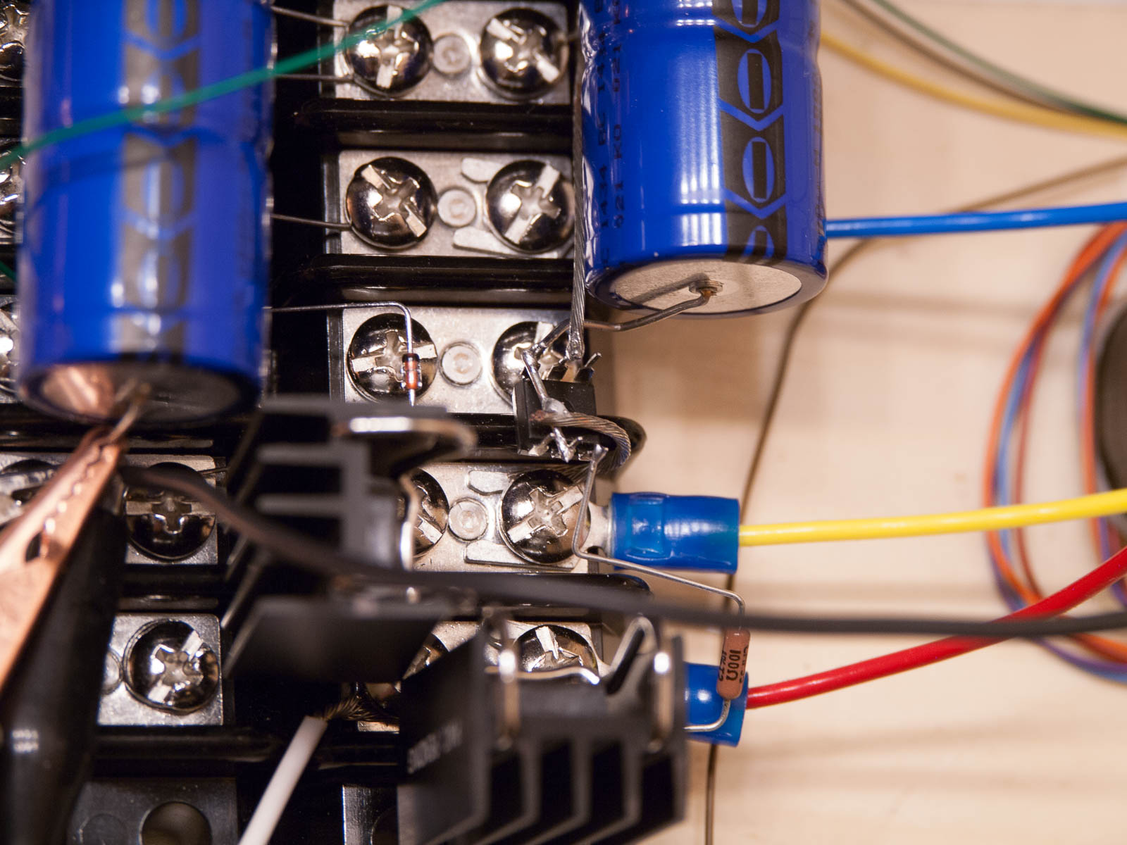

Another observation: the bench supplies for the +60 show much less than 1 A being drawn even when motor-boating. This may mean the drive MOSFET is not turning on properly, and no current is flowing. Certainly not 3.2A as per the schematic.
One other thing, I am using a 33000µF output cap since that's what I have on hand. Should make a difference but just in case it does....
I tested the opto before putting it in, and the diode read 1.06V. A little high but perhaps that's what it should be. I will put in a new one just in case, perhaps tomorrow. But they do not usually fail, do they? For $0.58 each, perhaps I should have reasonable expectations...

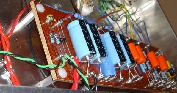

Socket adaptor for ic save opto from too hot pins temperature in soldering process so they are not cook to much.
Turrets point to point technique are interesting too( example on photo)
Always more secure to have only soldered connections.
Twice fun debuging and twice joy to be one of first Diyers :D Hahaha
to discover schade feedback vfet simulation in single-ended 50 watts topology from Papa :spin::note:
