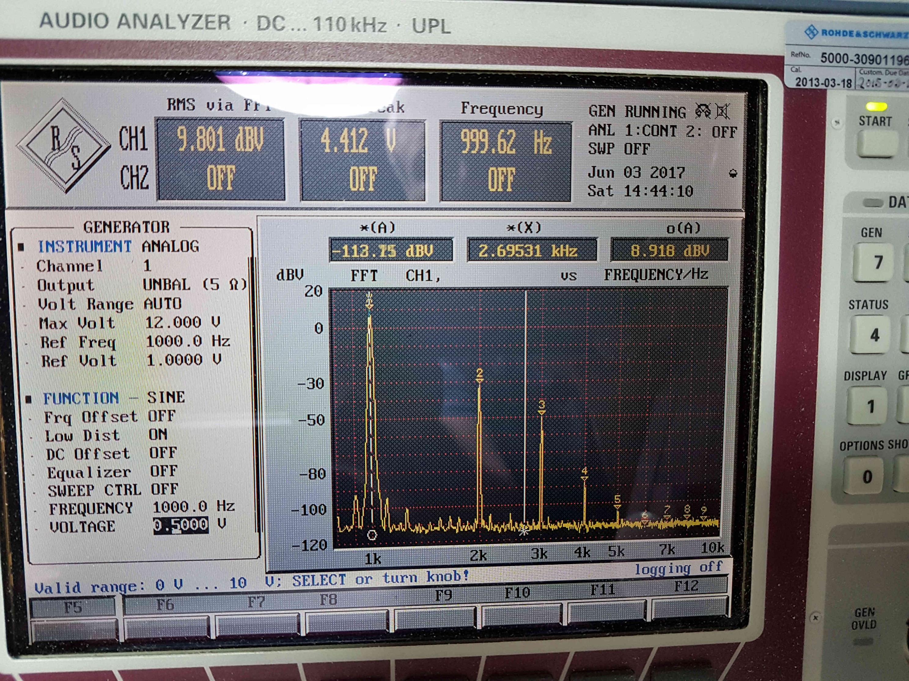

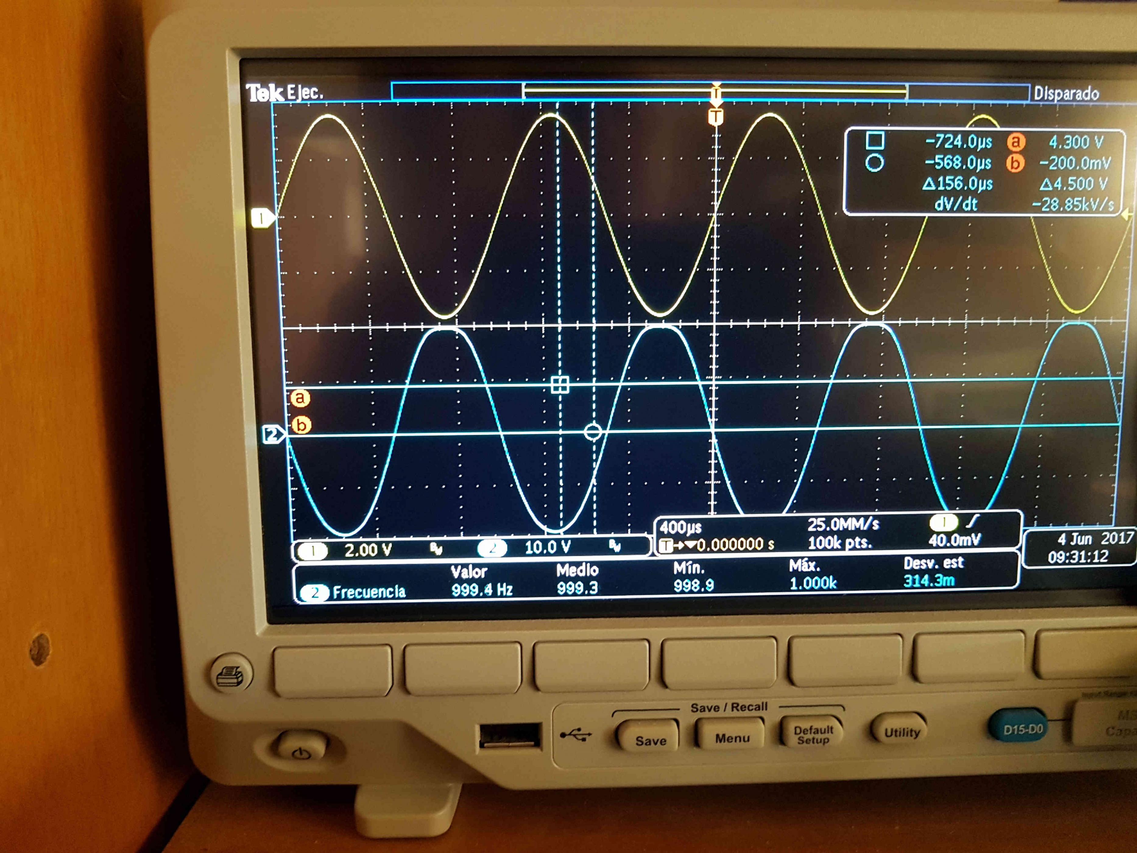

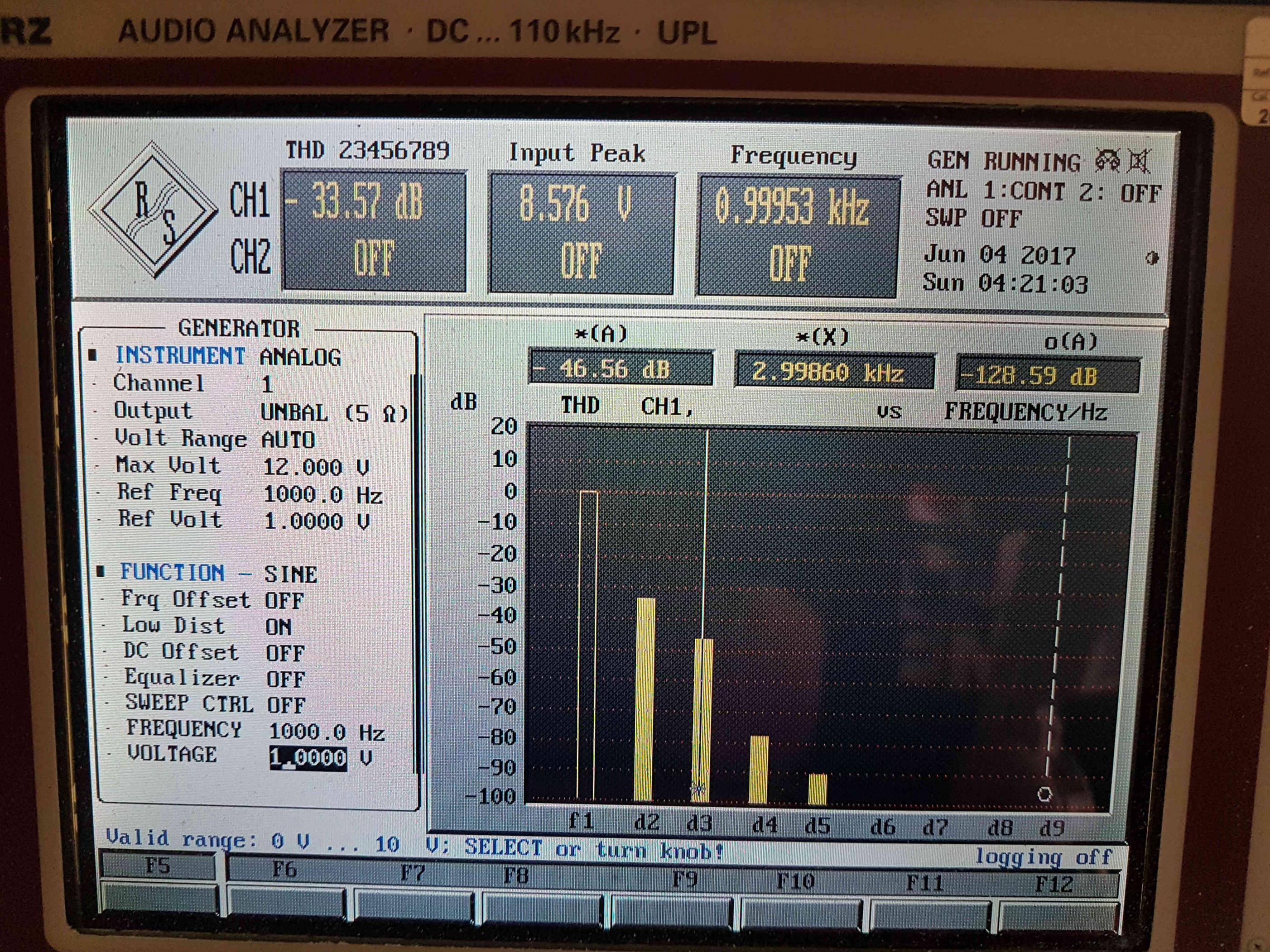

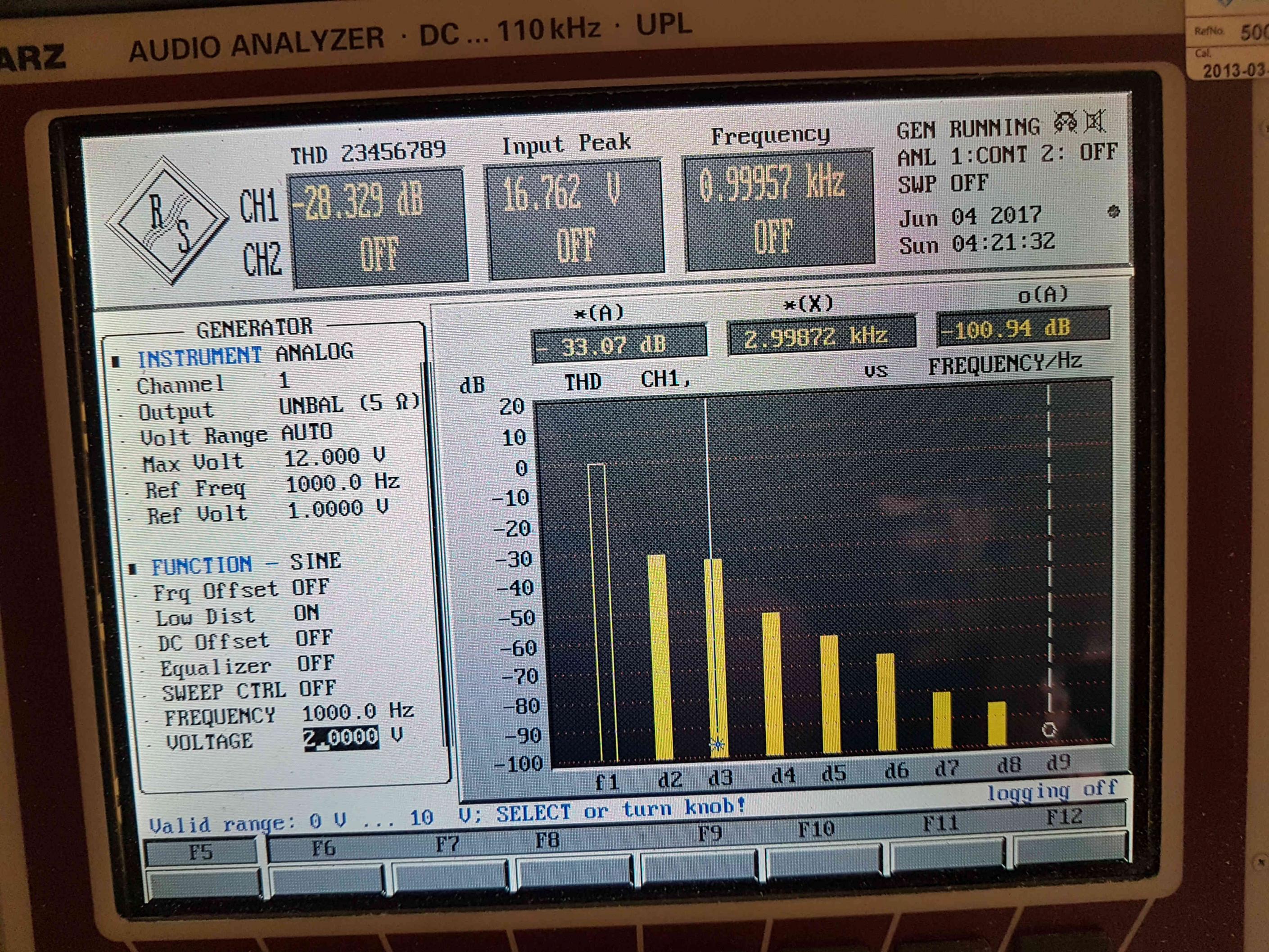

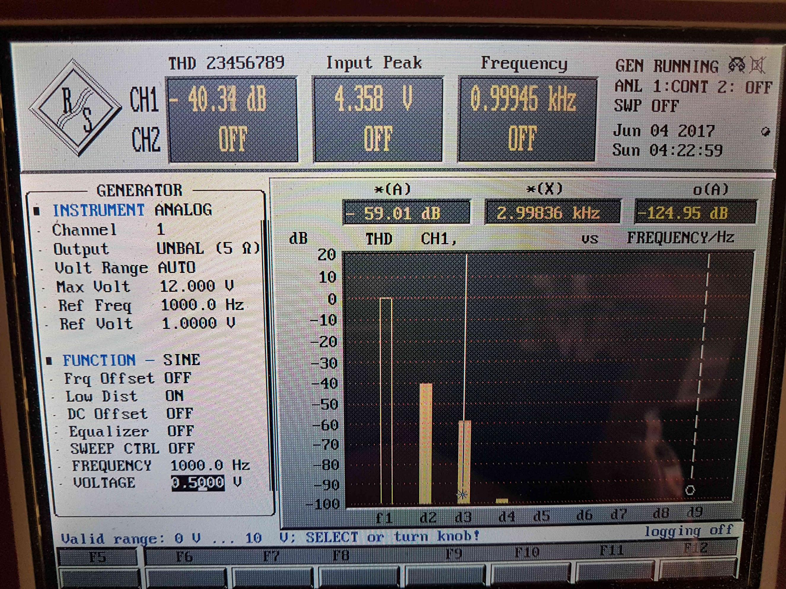

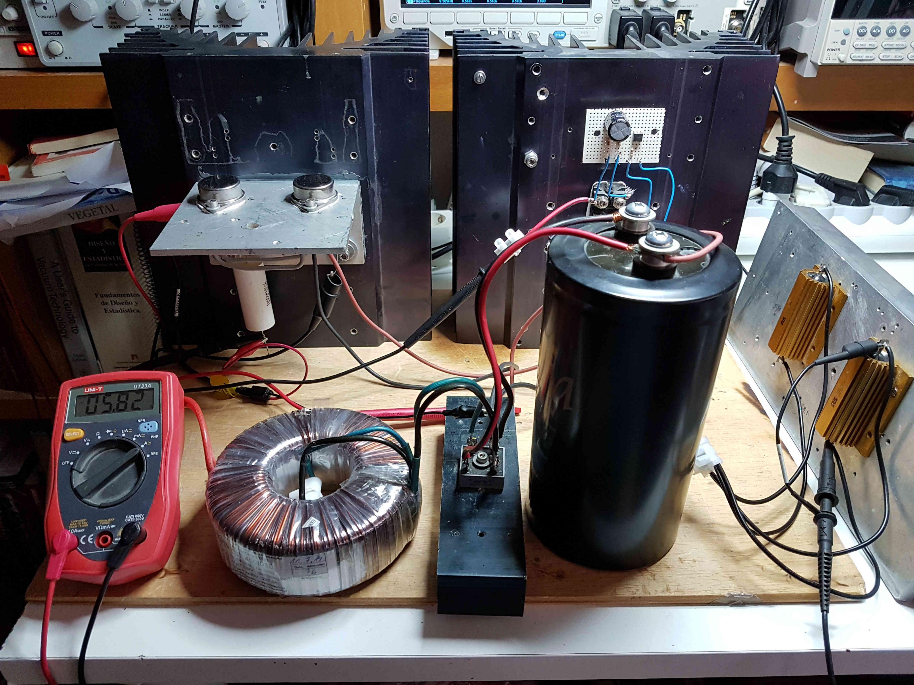

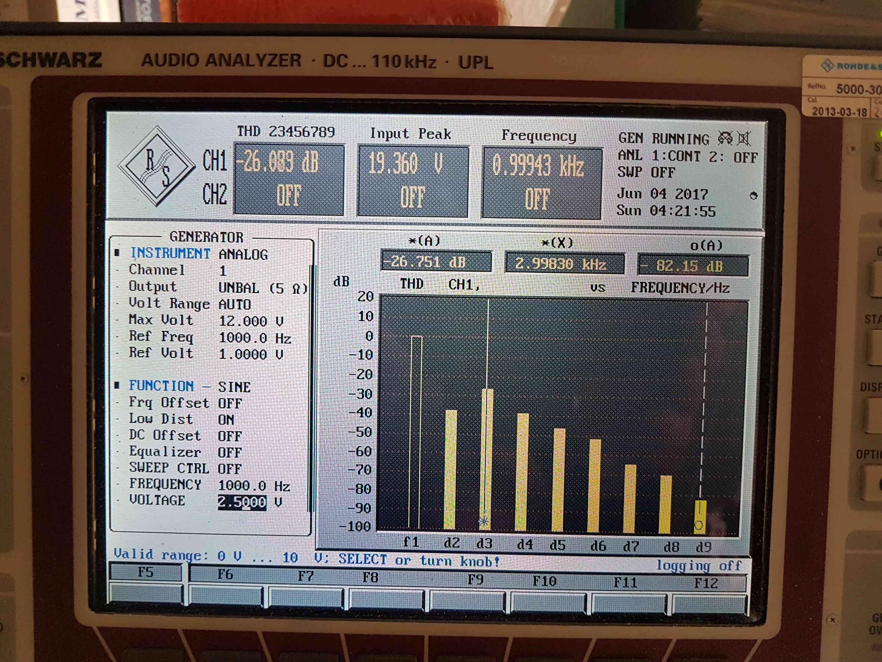

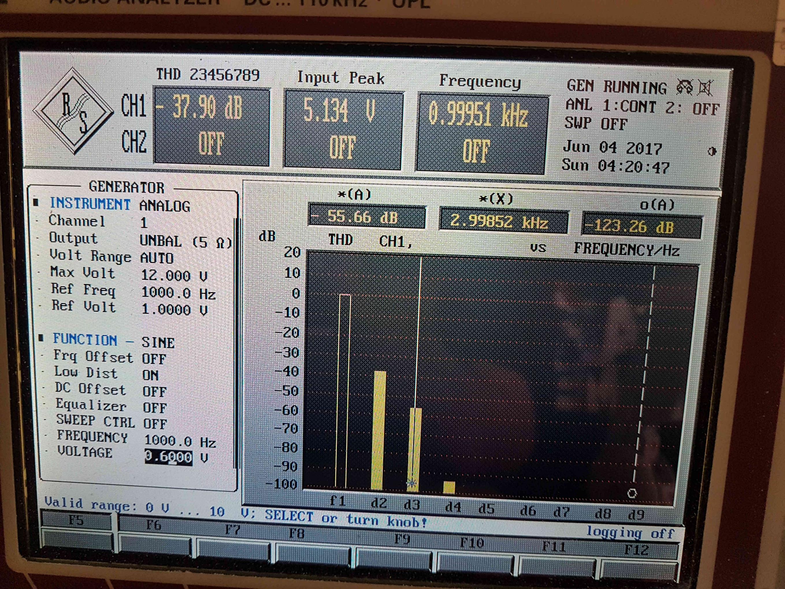

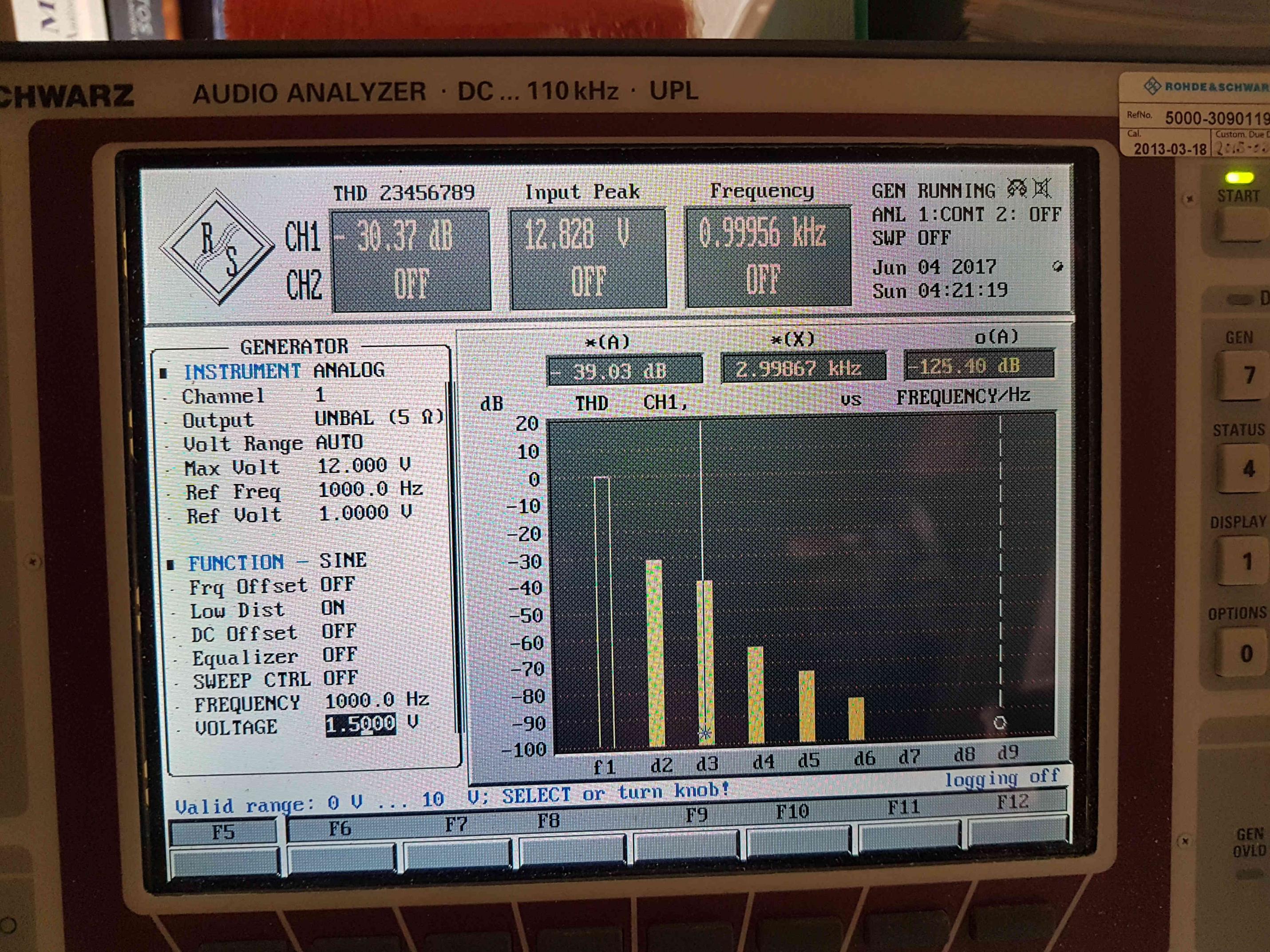

Hi all, just to complete information of big SE built on posts #651 to #667, I would like share harmonics pattern to some outputs at 4 ohm. I do not know how is the ideal pattern, but it looks nice. I did not heard it yet because I disassembled it until a few days ago that my good friend Steve asked me about this harmonics information.
Anybody knows if this harmonics pattern is enough good?
Now I want to built the second channel and adjust them to 16 ohm and hear..
Best Regards
