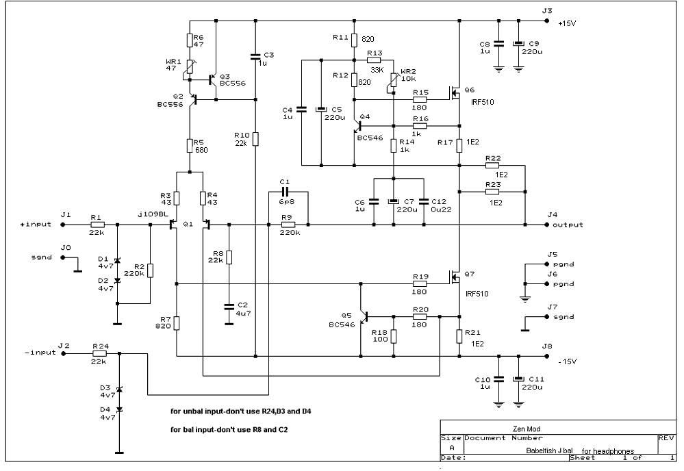

Khron said:Hi Choky / Zen Mod
I hope you'll find time one of these days, to advise me of the (exact) changes necesary to make a headphone amp out of your Babelfish
well - something like this
output mosfets - probably any of IRF5x0 or IRF6x0 thingies
for exact tweaking of output current - just play little with value of R13 , besides turning left and right funny WR2 ( increasing R13 increase current and vice versa ) .
schematic as is is drawn for approx. 500mA of current ;
it's wise to try - after finishing and setting circuit - switching off modulation of output CCS ( lifting one ond of R14, so base of R4 doesn't get modulation from output ) so output CCS is no more Aleph one ,but plain vanilla CCS
in that case little one became pure SE
if you have more Qs , just shoot
btw - that drek will make AKG 1000 sing like crazy
like always - all cudos to Papa

Khron said:........
I hope these details will also help others... Or maybe even make this a "Babelfish HP" (for HeadPhones )
I forgot to say - one of things (maybe ) needed for HP use is changing of overall gain ;
that is easy too, but I don't wanna scribe this now, because I'm lazy to cover both - balanced and unbalanced variant at once...
Khron said:Wouldn't reducing the 220k feedback R be enough to reduce gain? Although a minimum should be specified, i guess...
exactly ;
but not reducing it to less than , say , 110K ;
wel , while we are at it - in both cases ( bal & unbal) you must reduce R9 and R2 in same time, to same value............. without digging in actual problematic of real differential gain,impedance etc.....
Khron said:Well, i DO know that diff pairs should see the same impedance in both sides, but.. if we reduce the 220k AND R2/9, we won't get much og a gain reduction, will we?
R2 and R9 ARE 220K
Khron said:Would there be risk of any oscillation or erratic behaviour if i used some low-ESR electrolytic caps as the main filtering caps? (the 220uF ones)
nope .
