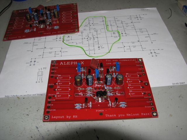

steenoe said:Oly, the pcb wizzard

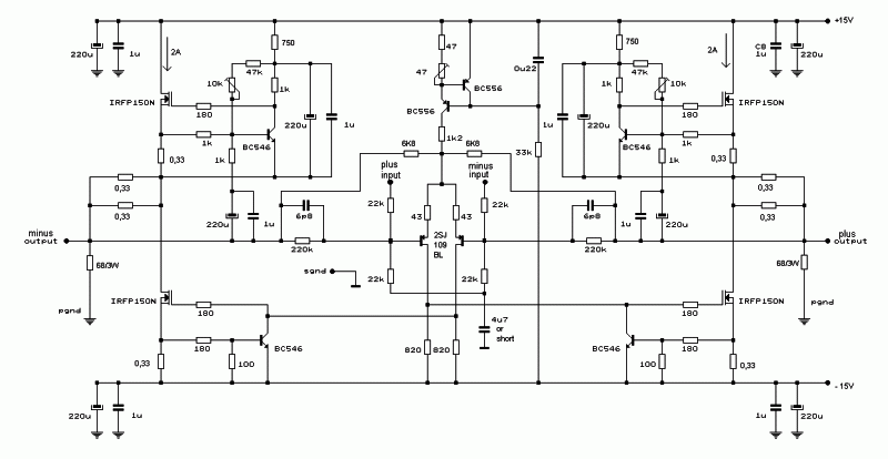

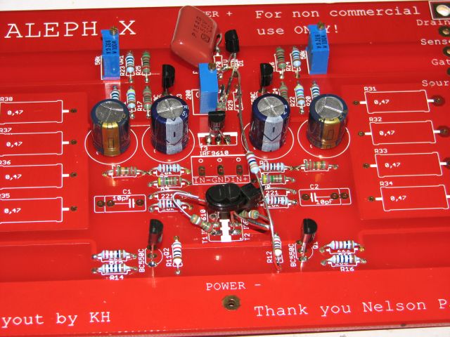

Here is a pair of heavily Choky'fied Aleph-X boards. Not as pretty as if Oly had designed them, but they will have to do for testing
This is as close to a Babbelfish-X as it gets
Steen
what schmtc exactly?
