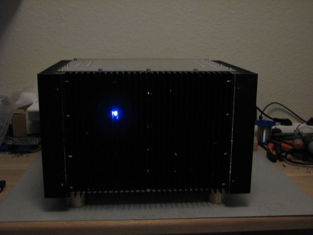

It worked right away (Again!) 1 hour warm-up followed by adjustment, and the amp behaves very well. Sounds pretty good on the crappy testspeakers too Here you go, blue headlight
The DC behaviour was pretty scaring with no load. Connecting a speaker made the amp calm down. With no load it managed almost 3 volts (on turn-off) With a speaker connected Its adjusted for very close to 0V offset. I actually adjusted it for 10mV plus.

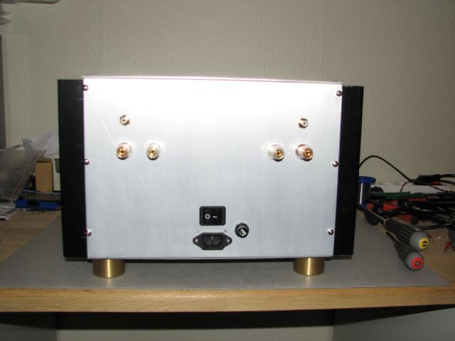

One more shot from the rear this time, just in case anyone cares. What the hoot, who does really Anyways, I didnt use balanced inputs for this amp since it will most likely be driven by my NS10.
You will notice that heatsink-compound is squeezed out between the heatsinks, I wanted to take full advantage off the frontheatsinks dissipation also. You will also notice that I am using fat machined brass feet

I am connecting the Aleph-J Wannabe to the mainsystem right now and a sound-report will follow

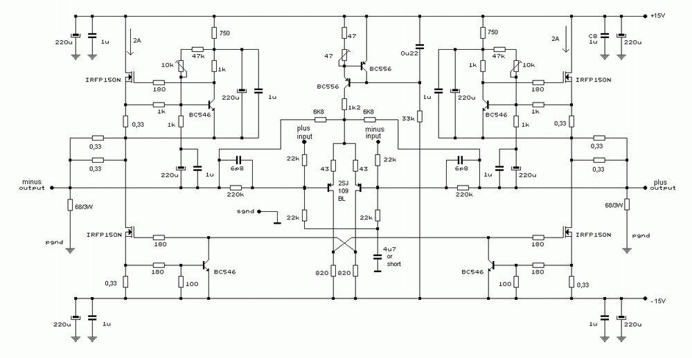

I can't wait to hear your impressions..............besides that -everything seems as I told ya
did you made some changes in schmtc.....0R33 etc............try with 30-40% AC gain later (in fact -check what you have now)

I changed the source resistors to 0,33r how did you guess that I also used a trafo of 2x18Volts. I am sure your hot resistors are caused by too high rails Isadore is the most important thing I might even take the amp to youdid you made some changes in schmtc.....0R33 etc............

as I wrote before-check what AC gain you have now and adjust it for your liking;
also-try amp without cap in feedback (in series with 22K to ground);
that will need maybe slight adjustment of offset.......but-your ears will decide is it worth the hassle
I can't see from your pictures -did you couple thermally two little bjts in input CCS?
addendum - I decide to change to 0R33 just for relaxing few param's ........you know - 2A x 0R33 is pretty close to Vbe voltage , in any case closer than 2A x 0R22 .....
and -if you try it with balanced input,they'll shine even more

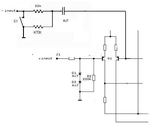

make a balanced input. I am considering to modify my Aleph 5 with a Toshiba J-fet input diff. like the Babelfish. Man, that would be great

on the second thought........besides number of gates you can drive with ~ 5mA through half of 2SJ109,it's also important what's PSU voltage in A5............little work must be done there to make little jfet critters safe of excessive voltage
Re: Balanced input on Babbelfish
try like this........it was somewhere in the thread
edit:
22K and 4U7 you see on pic are allready part of feedback net;
figure it how you'll implement this,just because in moment of designing pcbs we didn't think about bal input............some trace cutting where 4U7 is soldered to ground can make nice pad for additionall wire to XLR

May be you can show me and the others to convert your creation to a balanced input..
