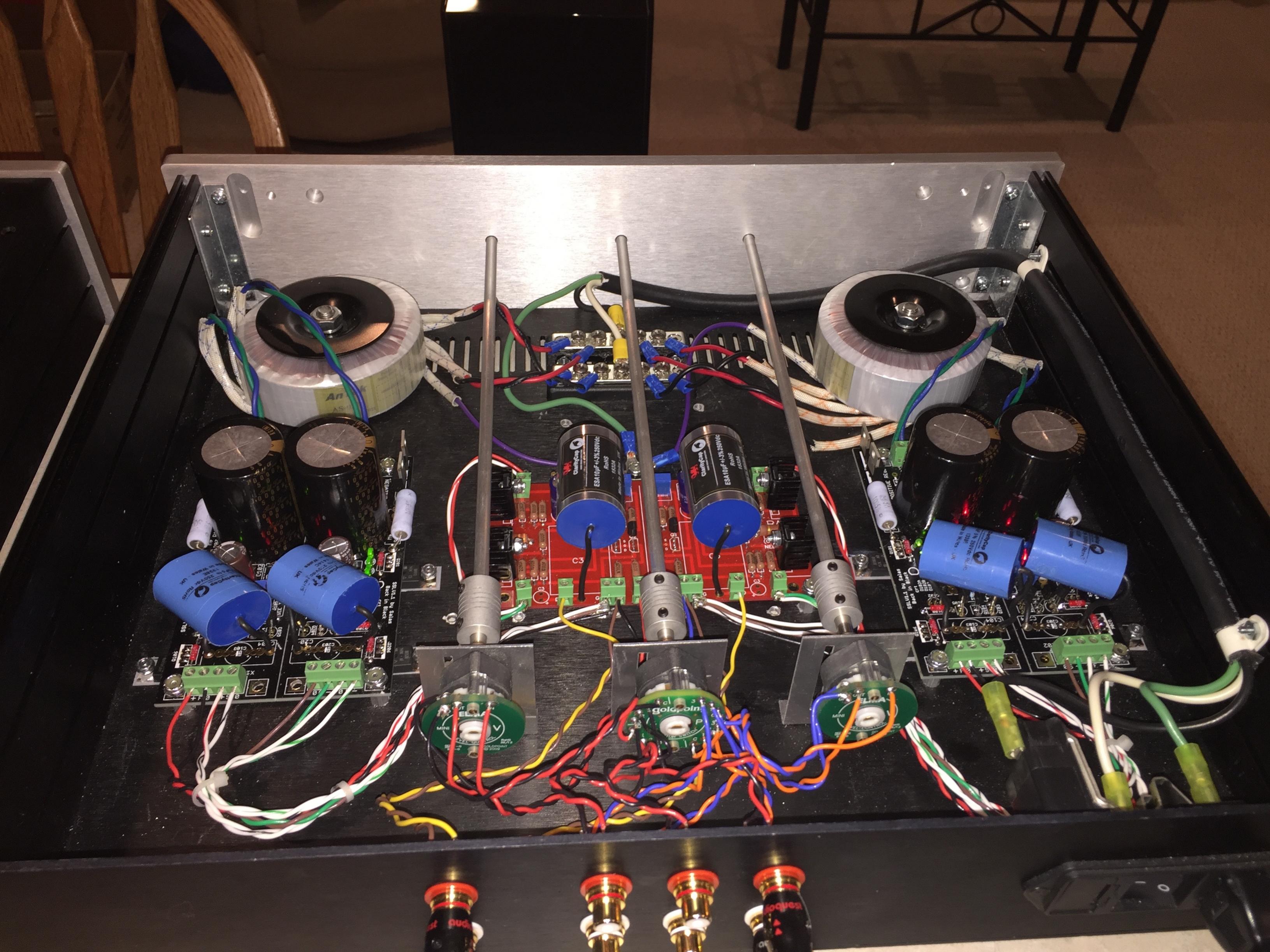

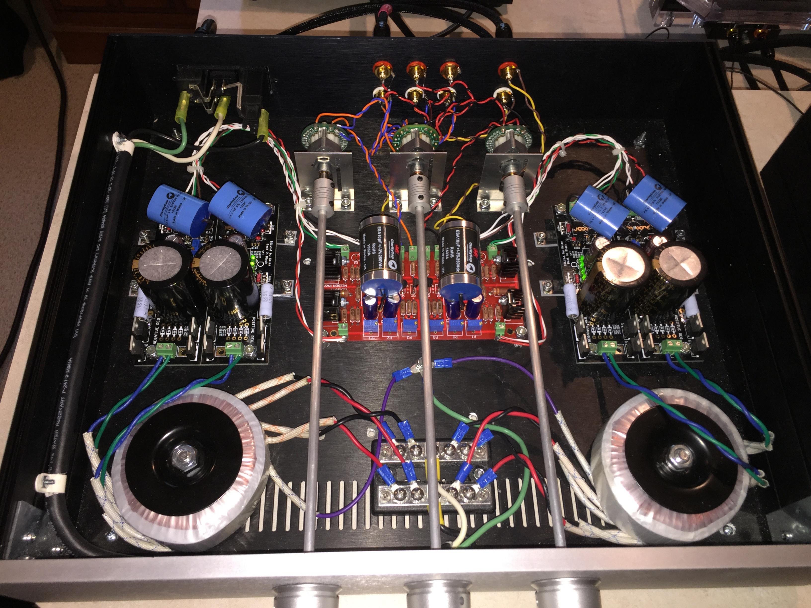

Finally finished the BA-3FE. What a phenomenal preamp! Wow!
Just wanted to thank everyone in this community for their help. Of course Nelson Pass for this awesome circuit, Jim for the build guide, Salas for all his help with the power supplies, and Marra for the clear pictures I used often as a reference (our preamps are essentially the same).
I started a thread about a year ago asking if I should build a BA-3FE or rebuild the B1 with better parts. The BA3-FE kinda of blows the B1 in the weeds. I'm using the preamp between a Pearl II and F5.
Also, in the meantime I bought (yes I admit it) an all tube preamp that I really love. I've only listened to a few albums so far but the BA-3FE is at least as good as the tube preamp. I haven't really done AB comparisons but the funny thing is I'm hearing more similarities than differences.
Another thing, the BA-3FE doesn't have nearly as much gain as I thought. I find it hard to believe it would drive an F4 in my system.
Again, Thank You
