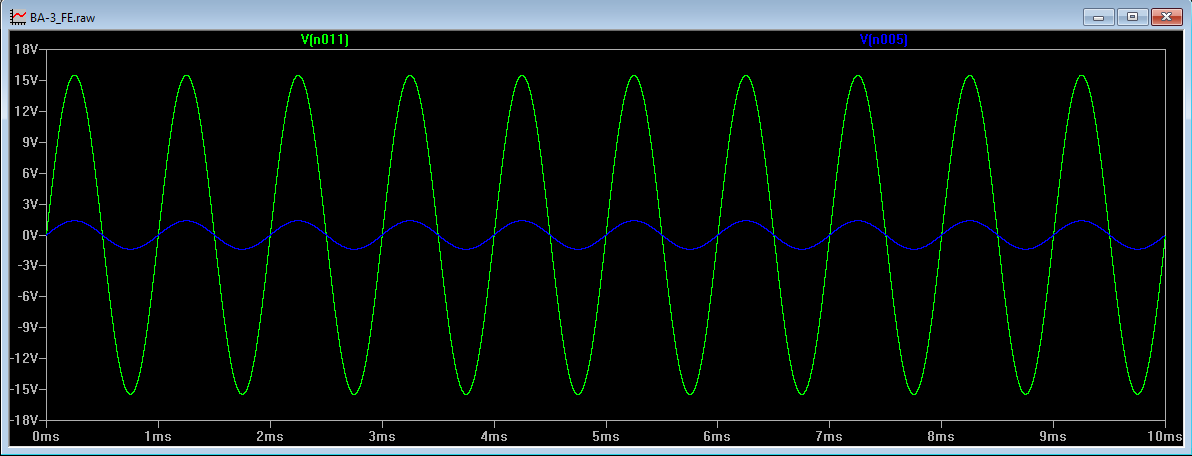

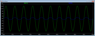

I made a quick simulation out of curiosity for the gain spec question thing and its indeed 21dB for R13=330R even if I used 12mA idss JFET models and IR Mosfets that I had handy in my models library.

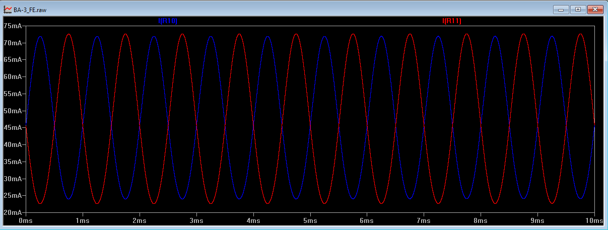

The Mosfets currents should become a little asymmetrical depending on the offset I guess. Here is how they go for mA swing on 1VRMS input and +73mV steady state offset simulation. On +/-24V PSUs. Bias current and its dynamic swing through Q3 Q4 can be translated across R10 & R11 as voltage drops of course.

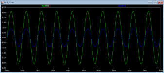

Based on my simulation, to have 30dB involves R13=1K and 35V supplies for 2Vpp max input after the pot i.e. 0.7V RMS real input just before clip. Make that 0.64V RMS or 1.8Vpp before the THD turns nasty for high harmonics anyway.
The dissipation on say 8mA biased JFET reaches 240mW while they have 30V across each. I.e. red line PJFET VDS and TO-92 mini-sinks territory. Long term JFET reliability comes in question. A worry for rare NOS matched devices.
The outputs dissipate 1.7W each. Heat goes higher up in all those semis when driven. Means double the heatsinks size than now to cope. You would not like the 9dB extra noise boost in the middle of the gain chain too. All in all better avoid temptation for such a gain mode IMHO.

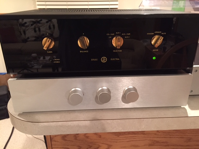

Yes! I am enjoying what a have. It was a preamp shoot-out at my house tonight.

And the verdict of the shootout is? Also, p3 has a pretty dramatic effect as you will figure out, really changes the depth and width if you play with it. It took me a while to get it where I wanted it.

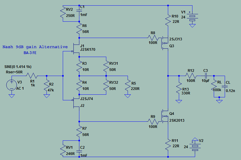

Thanks for sharing Salas. Waiting for the BiB boards to arrive before I build my BA3FE.
Like many others I am planning on a lower gain version than the stock which your simulation shows to be around 21db.. Would you be kind enough to plug into your simulation 24V rails, R6, R7 56R and R5 220R. All other values same as in stock schematic. What is your simulated gain?

I had a hard time telling them apart at first. I'm starting to get a handle on their differences. I think they are both pretty neutral, really letting the cartridge and Pearl II shine through. I think the Joule is a little more sweet, the BA-3FE a little more transparent. Of course my bias leans towards the one I built. Although I've really enjoyed the Joule preamp, I'll be showing it the way to the door (helping to fund new projects).

9.45dB if I got you right
