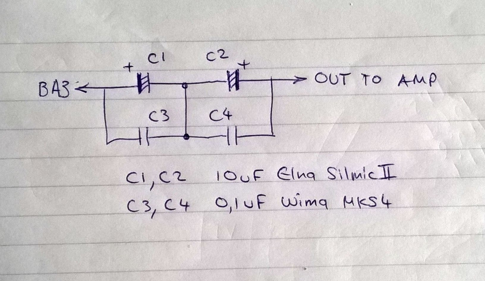

Zen Mod I was thinking of doing the same Elna Silmic II bypassed by Wima MKS4 that I have laying around.
My question is how would you connect the Elnas? Would you use 2 back to back with their negatives connected? If so what value in order to achieve 10uf in AC? 2x 20uf? I.e. like that below?

A picture speaks a thousand words...
Is this cheap way to replace the 10uf input cap correct?
C3,4 are optional
Should I increase C1, 2 to 20uf?
Could I use 1 bypass cap across both Elnas?
math says 20uF
The output capacitor pads are marked C3.
One is large enough to hold a big fancy film cap, the other pad, connected in parallel, is for a small 10uF can electrolytic. the electrolytic may be polar, and the small pad is marked for orientation.
The provision for an inexpensive (yet high performance) cap such as a Silmic or audio-grade Nichicon has already been placed on this PCB. You can bypass that with a small value film cap if you wish.
C1 and C2 are part of the bias voltage supply, and have nothing to do with the output signal.
don't bother with bipolar arrangement , just place single SIlmic and bypass it
Two are better than one.Thanks for the reply. Indeed Nichicon Muse have bipolar elcaps which is an option.
Wouldn't placing one polar electrolytic cap reverse bias it?
This from Bateman 2003 confirms that back to back Bi-polar when used as a filter have significantly less distortion than a single Bi-polar. Another para in the same report confirmed that back to back polar electrolytic are significantly lower distortion than single polar when used as a filter.Two better than one?

Bateman tested this and pooh-poohed the added film capdon't bother with bipolar arrangement , just place single SIlmic and bypass it
This is again based on the test method where the electrolytic is used as a filter.Using a Film Shunt.
Some writers advocate using a low distortion film capacitor in parallel with an electrolytic, to reduce distortion. Does it work ?
To find out I made a few measurements on these capacitors using a 1 volt test signal, unbiased then with 18 volt DC bias. As
shunt I used my low distortion 1mF MKP also a 10mF bank of three 3.3mF low distortion metallised PPS capacitors.
With 1mF shunt, second and third harmonics of the Silmic reduced by just 1 dB. Using the 10mF, both harmonics reduced by a
further 1 dB. This small reduction is not worth the additional PCB space and extra cost, because even with a 10mF shunt,
distortions far exceed those of my metallised PET assembly.
Thank you Andrew, that's very interesting stuff.
It makes sense that a single polarised cap will have more distortion, however I'm not too hung up on distortion - as long as it's low enough.
I am more worried about damaging the resistor with reverse biasing, as well as the sonic qualities. For the latter, I guess there is only one way to find out!
Bateman 2003 tells you.By the way does anyone know how bipolar elcap are constructed? Are they essentially 2 polar back to back?
Thanks Andrew very interesting read. What I take away from that is... use 2!
