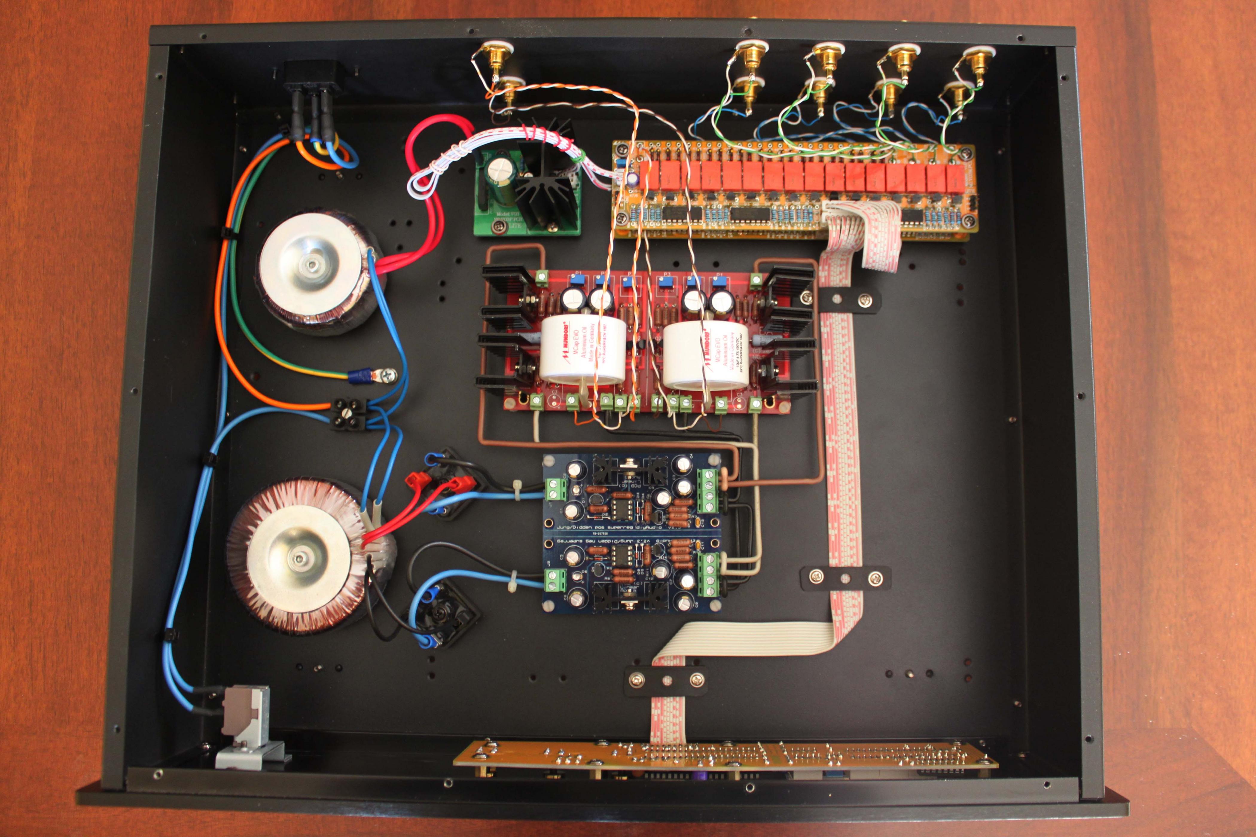

Loving the crystal clarity and big sound stage that I‘ve been enjoying since installing the BA-3 FE into my setup.
I’ve finished the rebuild and pictures will follow.
