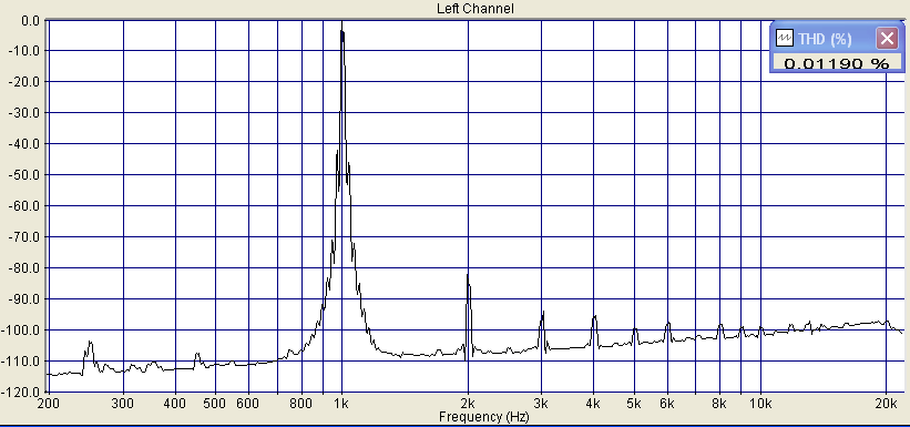

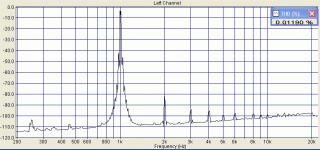

I just run a B1 FFT measurement again. Second order is higher than third. Mine has +/- 10V supply and no coupling capacitors. This card has 0.007% residual THD and 100dB noise floor in the last octave.

I will see near that when I will get my new EMU 24bit I guess. You must be using AP2? The main question is do you still see more second than third harmonic in your FFT like I do? I used 0dBV input, volume fully clockwise, about 3k card input Z.
