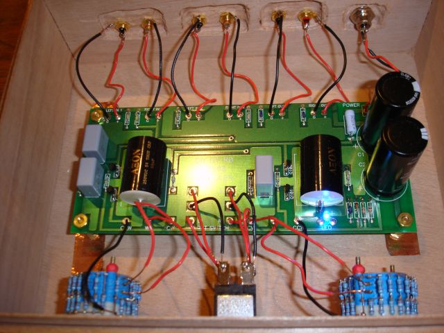

My Cigar Box B1 is completed and is powered by a 18V wallwort I bought at the local Goodwill computer store. The blue LED lights up. I have not tested it in a stereo system yet. I will report back about it when I do. This is my first completed DIY effort.
vonfilm said:Cigar B1
Congratulations, before you know it you'll be scratching the back of your head why the thing you're assembling has a timing device.
