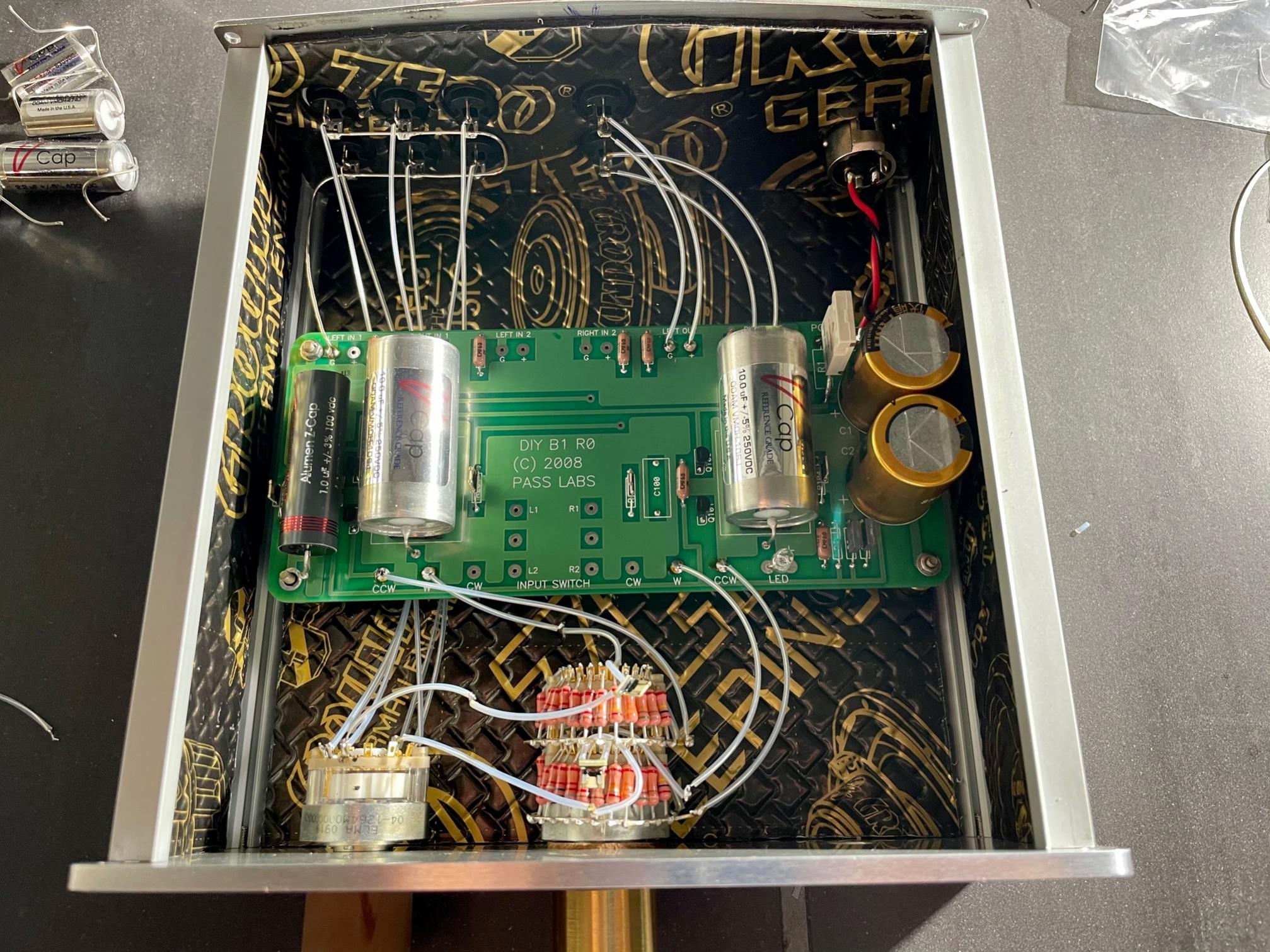

Hi, I have now played for 3 days.
But last night I lost sound i right speaker.
I tapped the Jfets in right canal, sound come back for awhile. Then lost it again.
1- Can it be that the Jfets is overstressed (damage) because I use 100R as output resistor and my crossover is at 20K (next after B1)?
2- Can it be that I have put my Jfets very close to PCB ( short legs ), and damage them then solder them ?
