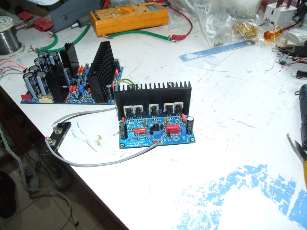

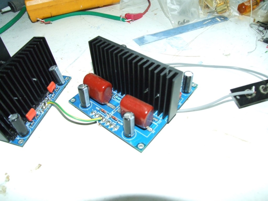

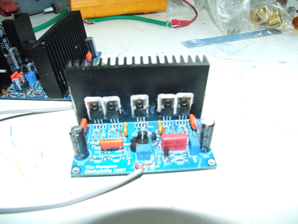

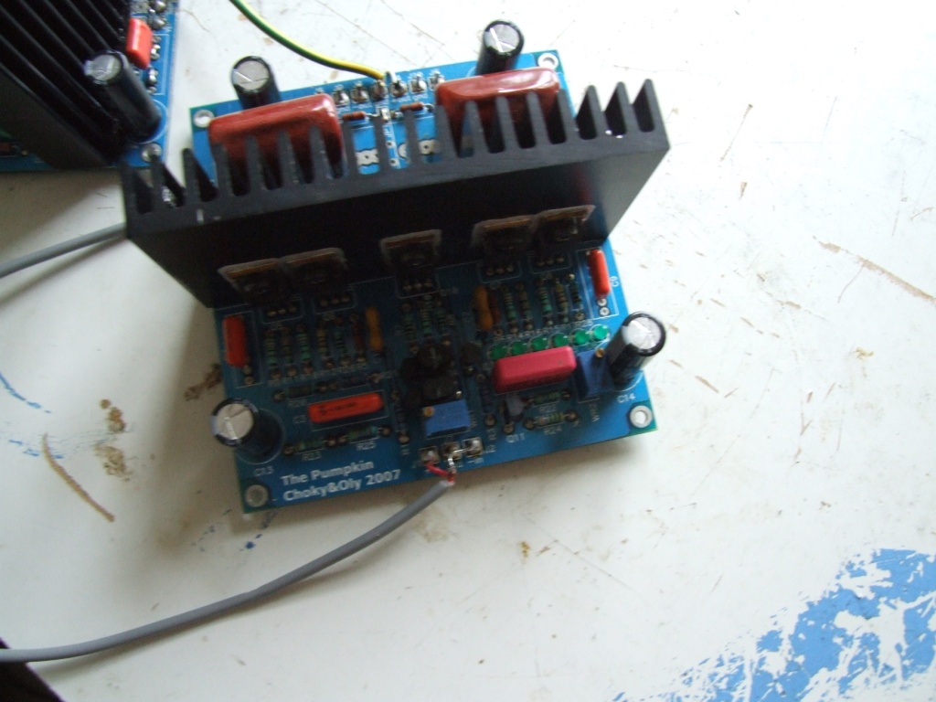

My Pumpkins
In my opinion, I've used good components where required.
Any comments about the odd noises would be much appreciated.
The cheap - tacky - screened leads were just there for testing.
All resistors were 1% Metal Film types.

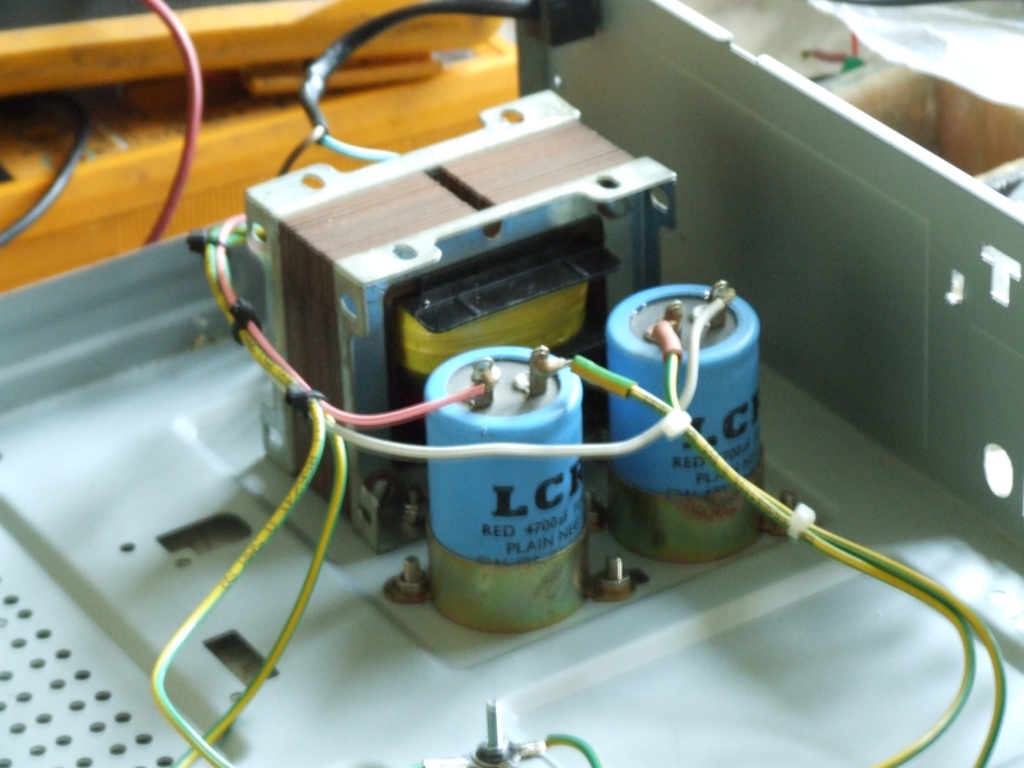

OK its back to basics with the Pumpkins.
It doesn't get more basic than a 100VA 32-0-32V transformer, a Bridge Rectifier and 2 x 4700uF Caps.
One question.
Off load the unreg supply is approx 42-0-42V DC.
The Pumpkins are nominally 36-0-36V.
If I resistor load the PSU with 500R 100W resistor then it drops to approx 36-0-36V (as intended). - Across the + - - (84V DC) = 170mA
What is the quiescent current of (1) Pumpkin - I am testing them individually.
ZenMod tests the Shuntkys at 80mA each.

hi KatieandDad,
you are really fast!
my recommendation with 32V was thought for use with 7915 and 7815 with the scheme I sent you...
I think it is better to have the regulation, you can then choose between +-15V to +-36V for all pre´s!

The Pumpkins run at +/- 36V.
I've got the 7915 and 7815 regulators, don't you think the transformer will put their inputs a bit close to their limits.
I'm not sure that the Pumpkins will run properly as low as +/- 15V.
