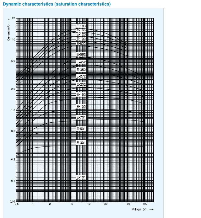

The current limiting diode in place of Q101/Q201 is a better choice because you don't have to select from a pile of 2SK170's to find one that gives you the desired current. The CLD's are calibrated in milliamps already and they are exactly the same kind of circuit as Q101/Q201.

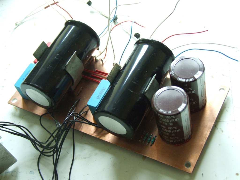

With my CRC supply + C1 and C2 on the B1 I've got over 40000uF of caps in the supply line.
For a unity gain Buffer that is INSANE.
Nearly as crazy as the 1.5F (yes Farads) that I've got in the Aleph 4 that follows it.

Sorry I cant get probes into mine because of the huge Obligatto caps.

In its basic format it works perfectly with a CRC PSU. I use 18V Transformer and a standard W001 bridge with 4700uF 2R2 4700uF which is probably OVERKILL.

The bias voltage is exactly 9 volts, from the 10k/10k divider, of course. That doesn't tell me what the operating point is though. I don't know Vgs or Vds, for example. The amount of current set by the lower jfet is also unknown, and it can apparently vary over 3 milliamps depending on which particular transistor you stick in there.
It may be best to just stick with the CC jfet instead of a CC diode, since the current regulation of the higher value CCD's are not that great. I don't know if a strapped jfet is any better, since these CCD's are basically strapped jfet's anyway. It's better to use a smaller value CCD apparently since the current regulation with changes in voltage is better.

I think I'd like to replace C1 with an 18V zener, bypassed with 0.1uF capacitor, and select R1 based on the supply voltage. Then I can replace R2 with a 0.9mA CCD and replace C2 with another 0.1uF capacitor. The bias circuit draws essentially zero current so there's no need for a huge capacitor there. I assume Mr. Pass picked 18volts for the supply for a reason and not just randomly.
