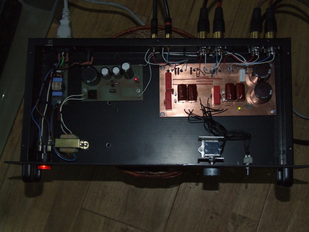

Am I right in reading that the B1 has unity gain ?
Yep. B1 = buffer 1
Have I just built a volume control ?
Well, yes. But one that doesn't have any weird input/output impedance issues, and can drive a good length of cable. But technically, any preamp is a 'volume control'

The question was, and has been missed by everyone, my CD player has an output of 2V RMS.
How much pre-amp gain do I need to drive the Aleph 4 into approximately 6-8 Ohms.
The B1 and the Aleph 4 together are completely silent - except of course the music.
If my rusty maths is correct.
Voltage Gain = 20 x Log (Vout/Vin)
28.3V RMS into 8 Ohms is 100Watts.
Therefore the total gain required is 20 x Log (28/2) = 23dB
If the Aleph 4 has a voltage gain of 26dB then it will achieve FULL output with the 2V RMS signal from the CD player. The B1 will do the job.
Yes the calculation is correct, B1 does the job. Even a passive solution, a simple pot would do the job....

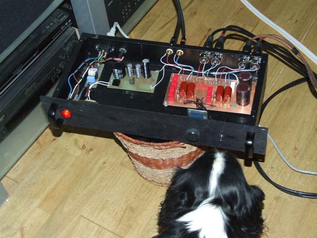

I only built the B1 as I happened to have nearly all the bits in my spares bin.
I only had to buy the J-FETs.
The result has tidied up my DIY lounge and the results are really very pleasing to the ear.
I also used the exercise to add an input selector which had previously meant having to swap cables.
The B1 only has two inputs. (1) the raw input from the CD player and (2) everything else through my AV amplifier.
The rationalle being that I didn't want anything in the signal path from the CD player.
If you look closely you will see that the bracket holding the ALPS pot is actually an old heatsink scrummaged from a rotting TV set.

thanks for the nice picture!
