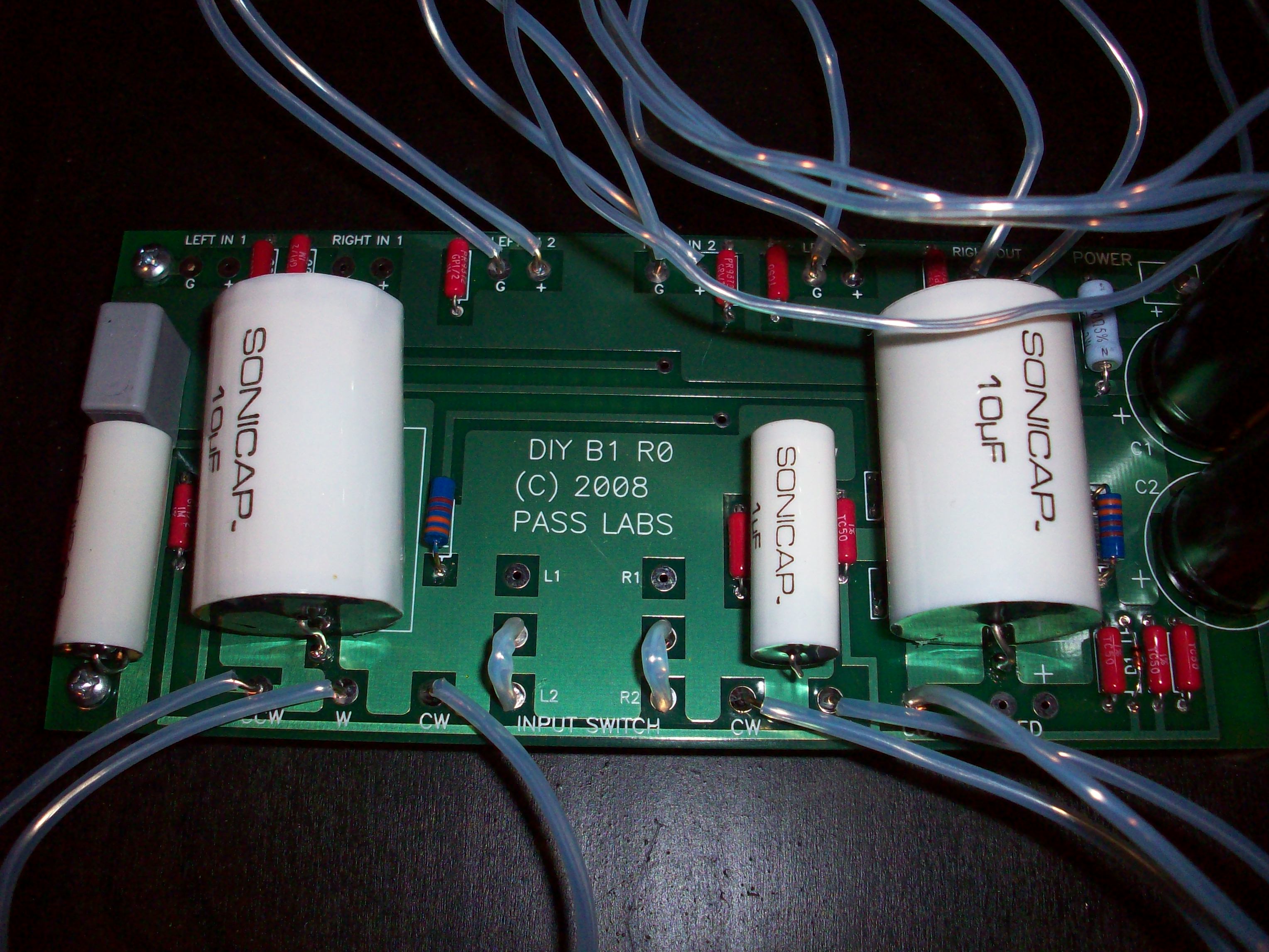

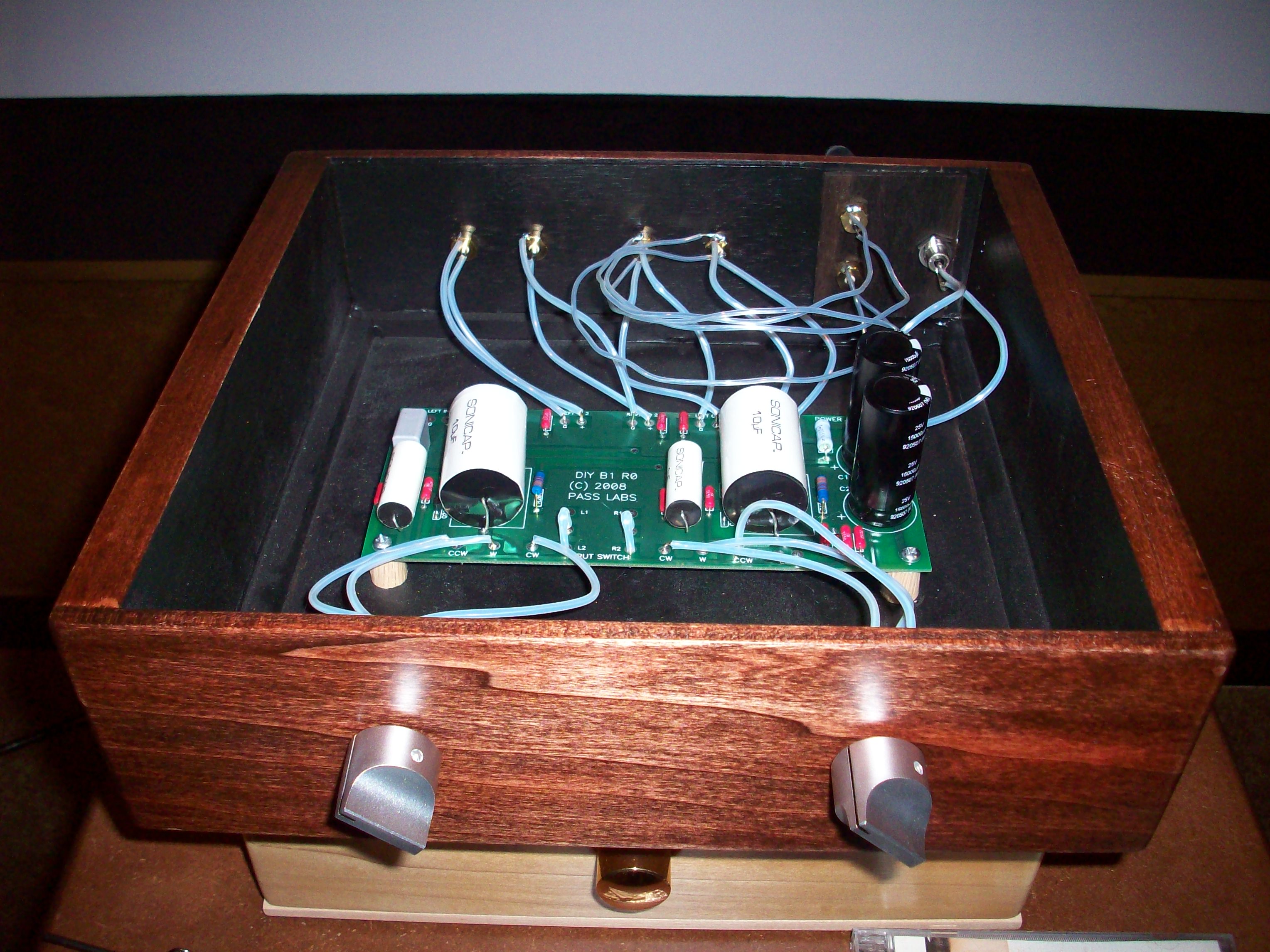

Hey Guys
Just thought I would post a couple shots of finished B1.

The pic is posted at above 2573.
It is very simple just come off of your existing output RCA
jacks.solder a wire from ground to ground on another RCA.
then simply solder a wire from center pin to center pin .
all you are doing is wiring 2 more RCA parallel off existing Jacks.
just look close at the picture the smallest wire is feeding
the Sub outputs.
can you post a picture to see how it is done?
