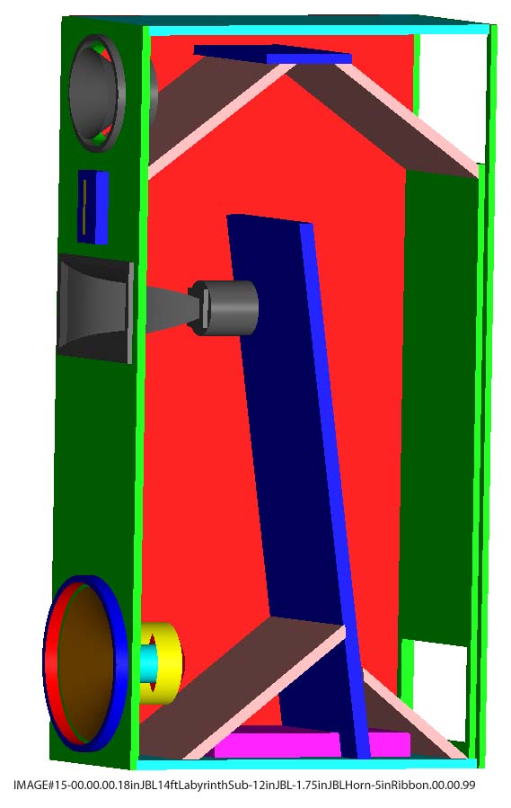

Picture is of my speakers which require a 100Hz x-over between the 18in JBL2242 in a 14ft transmission line labyrinth(low frequency optimized backwave-frontwave cancellation is 20Hz) and a 12in JBL2202 mounted in a short backwave horn for use between 100Hz and 500Hz, from 500Hz to 4KHz I have a 1.75in titanium diaphram JBL2525 compression driver horn loaded, and above 4KHz a Foundtek 98db per watt 5inch ribbon. My speakers efficientcy is 98db per watt 100Hz to 40KHz which requires the quality of the B1 x-over, below 100Hz I am using a sub harmonic synthizer 26-100Hz.

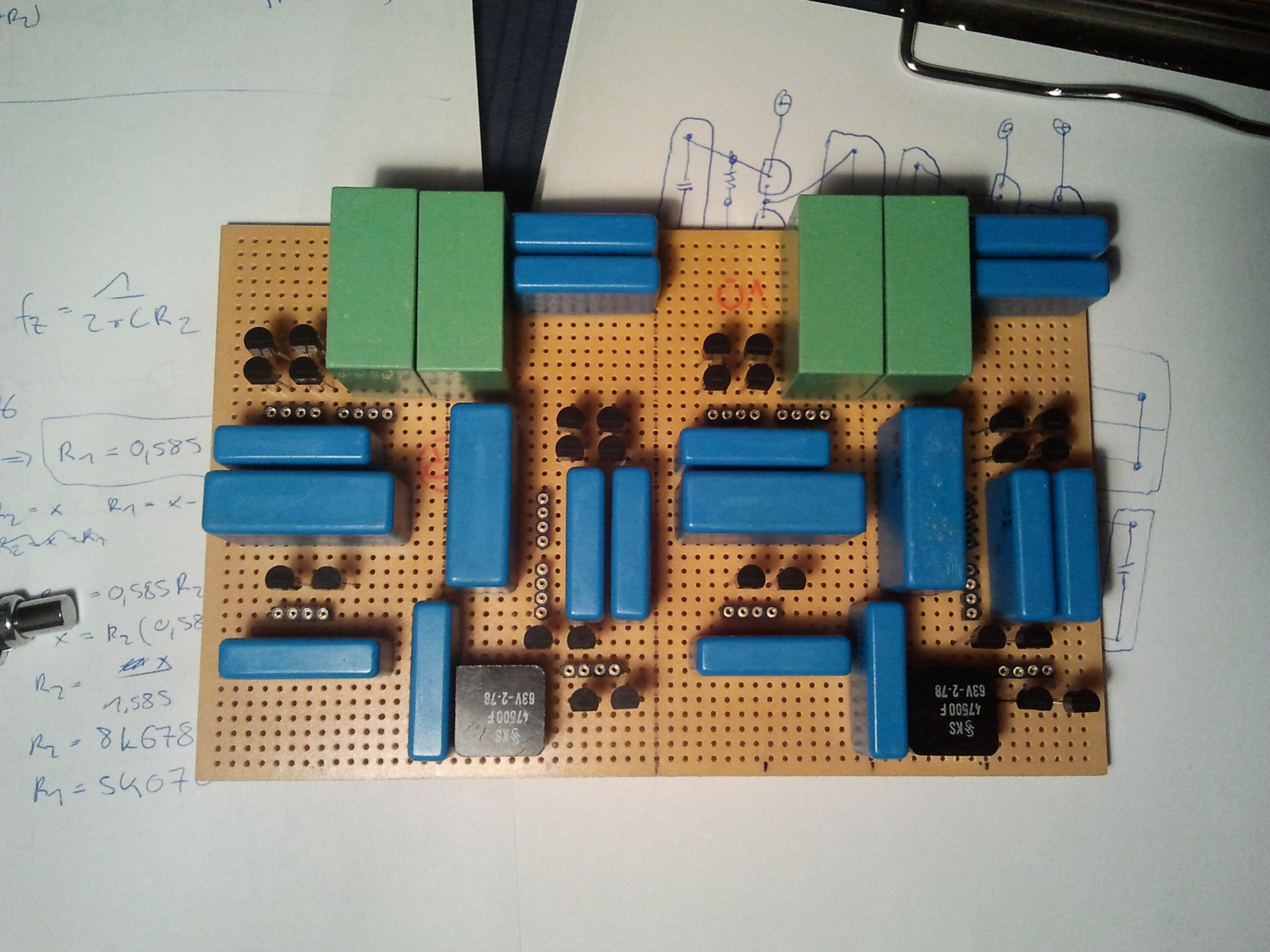

4th order B1 buffer crossover Calcs
I am trying to put together a stereo 2 way 4th order crossover with preamp source switching (2 sources) and overall volume control.
I have a pair of Snell E with a crossover point of 2700 Hz.
To configure the values for this cross point I referred to the Grey Rollins' article: The Xenover - Part II Article And Design By Grey Rollins
The resister and capacitor numbers corresponds to Grey's Schematics as indicated. I don't have a way to change the values on the attached PDF.
Butterworth high pass (Schematic 7)
C = C1 = C2 = C3 = C4 =.002
1st section: R5 = 0.9239/(2*Π*F*C) = 27.2k
1st section to ground: R6 = 1.0824/(2*Π*F*C) = 32k
2nd section: R11 = 0.3827/(2*Π*F*C) = 11.3k
2nd section to ground: R12 = 2.6130/(2*Π*F*C) = 77k
Butterworth low pass (Schematic 8)
R = R5 = R6 = R12 = R13 = 22k
1st section: C1 = 1.0824/(2*Π*F*R) = .0029 uF
1st section to ground: C2 = 0.9239/(2*Π*F*R) = .00247 uF
2nd section: C3 = 2.6130/(2*Π*F*R) = .007 uF
2nd section to ground: C4 = 0.3827/(2*Π*F*R) = .001 uF
As I proceed with buying the resisters and capacitors I would like confirmation that those calculations will work for the B1 buffer crossover using 2SK170BL devises. I may use a discrete opamp for the preamp gain stage.
  • LR4b DCB1XO 4th order.pdf
Values
Thanks Andrew,
I take it the calculations are correct for this buffer crossover.
I will buy a 100ea 1000pF caps and some other values that can be paralleled to achieve the values above. I have a capacitor meter for matching. This will be perfboard construction so I can do what ever necessary to reach the values.
Thanks for the help.
Rush

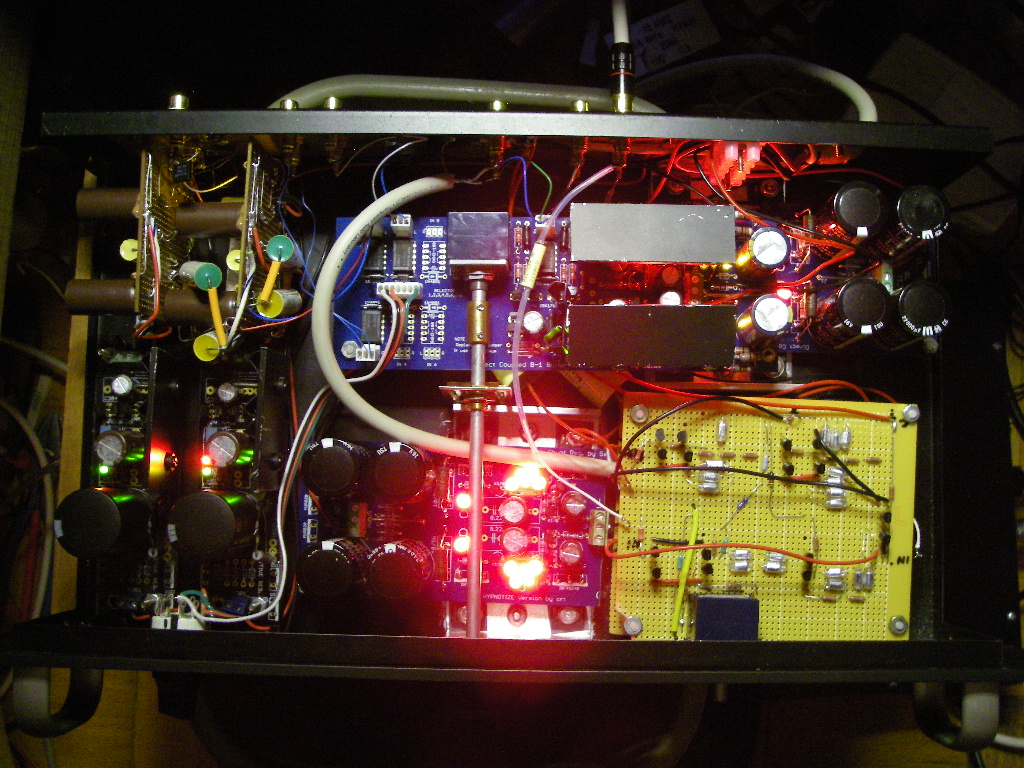

Finally finished the 2 Hypnotize regulators for the 2 way stereo crossover, had to cut off the B1 part of the boards to save space. I populated the bread board crossover 6 months ago, the Salas Simple phono pre amp and regulators were finished 2 months ago along with the Mesmerize DCB1. Put it all in the box, cranked it up on the bench and noted the DC offset of around .2 volts on each output. I chose to cap couple the output and not deal with rematching jfets. The high pass was a small .02 uF styrene cap, the low pass I used a 7 uF Kimber cap that was lying around, I may change this later as I only need a 1 uF and can afford a better cap in this value.
Hooked up the bench tube amp and crappy speaker and found a loud buzz on all the crossover outputs. So I took a .22 uF cap, attached one end to ground and started poking around the crossover. Found that when I touched the top leg (plus rail) of the top jfet on the input buffer, the buzz went away completely. That was easy, needed a little decoupling. Soldered them in and it is pretty quiet.
Listening now for the last hour or so and it sounds great! I am sure the parts will break-in over the next few weeks. I will leave it on.
I have a separate box for the 2 power transformers each is switched so if I don't want to listen to records, I can leave that transformer off and reduce heat and electricity consumption. Needed 2 transformers as the voltages were completely different.
I wired the transformer box to the pre amp with a 4 conductor cord and 4 pin XLR, each rectified raw voltage (48 VC and 17 VDC +/-) shares the same ground wire. Wasn't sure that was going to work and I worried about how I was going to ground all that in one pre amp box.
Worked it out with some fiddling.
Thank you Jacques Merde for all the help. This thread has given me a great sounding crossover.
I will also thank Salas for his regulators are everywhere, 8 of them in one box! (5 positive and 3 negative)
Rush
Removed the output caps
I was in a hurry to finally listen to the pre amp/crossover after debugging it. I threw those caps on the output and did some listening.
But of course I can't leave well enough alone. I remeasured the DC offset and found none, .001, .003, .002, .000 and said what? I must have measured wrong or after 24 hours of burn in it settled out? Naw, I must have measured wrong. I didn't remeasure the offset after I added the caps to the plus rail, could be that, or?
Anyway, took the coupling caps out and hooked it back up. Sounds even more better without the caps. I guess you can hear caps.
I am an amateur after all.
That saved me a ton of money. The V-Caps TFTF were going to set me back a couple of large ones!
Might still buy them for the phono pre, but not at this time. I'll wait for Christmas, buy them tell the wife they cost half what they did and she can give them to me for Christmas. Then I won't have to buy her so large a present in return.
That has served me well for 19 years of marriage.
Rush

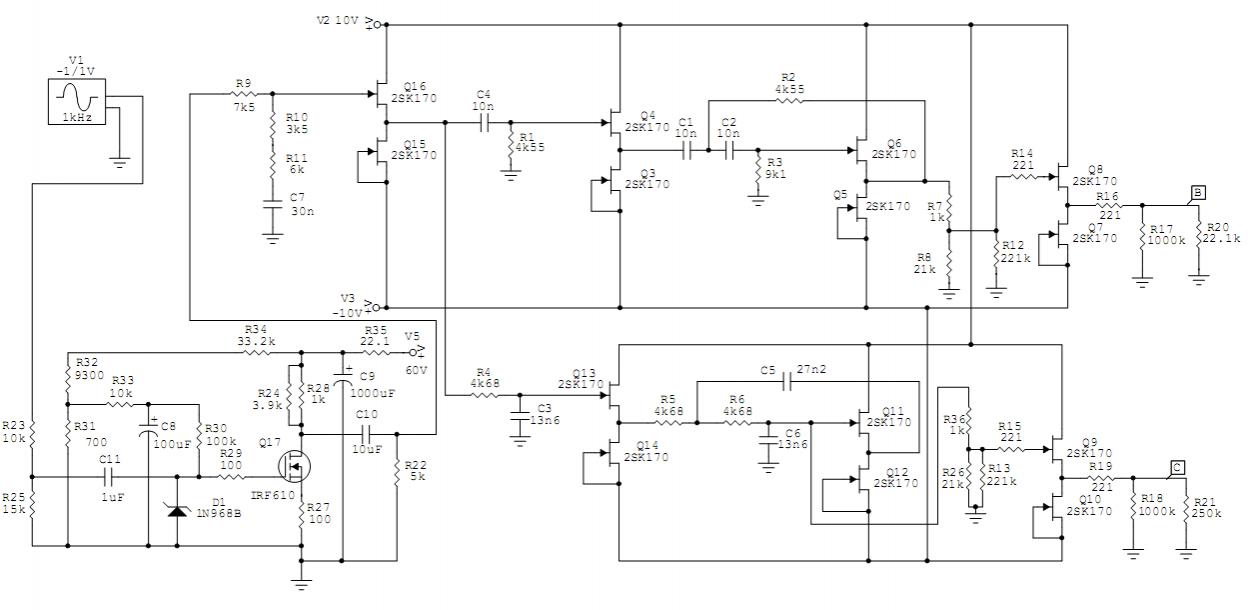

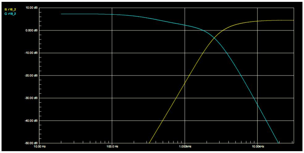

How does the attached circuit look like?
It's a Bride of Zen feeding a passive RC shelving lowpass followed a 3rd (cascaded 1st and 2nd) order high-/lowpass network employing unity gain DCB1 buffers.
I have the BOZ, a ready-made DCB1 blue edition, a DCB1 Mezmerize pcb and numerous pairs of matched 2SK170BLs. The additional JFET buffers would thus be fed from the DCB1s' shunt regulators.
With the present values the passive BSC should give a pot-adjustable attenuation past 500Hz for baffle step equalization.
The part values of the crossover that follows the BSC are based on matched capacitor values I happen to have on hands, and it's supposed to be a spread frequency crossover at 2500 and 3500 Hz. Level setting pots are provided for each branch.
What would you change, add, ditch? More gate stoppers perhaps? Supply decoupling caps I would certainly add in the real design then. Something else?
I also have one of those red JBOZ pcbs from ebay, which means i could build enough amp and buffer stages to move the gain stages to the output. JBOZ for highs, BOZ for lows, with JFET input buffer. Would that be preferable?
And does anyone have a link to that version of the JBOZ with the bipolar supply, please? I can't seem to find it.
Thanks for your critique,
Dave
