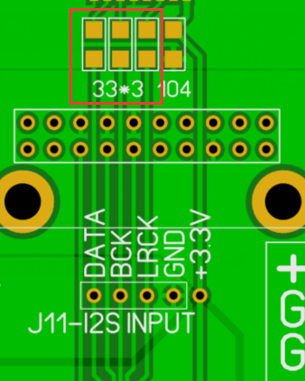

2. I also want to connect raspberry pi to AZ1021 SK. Do I understand that I have to remove three 33 ohm resistors?
When I remove these resistors, will not this be a problem with use amanero?
1、Your pix is ok,nothing will damage.
2、J11 link i2s over hdmi,the USB port is independent of j11. Remove the resistances and the HDMI can't be used. USB is not affected.

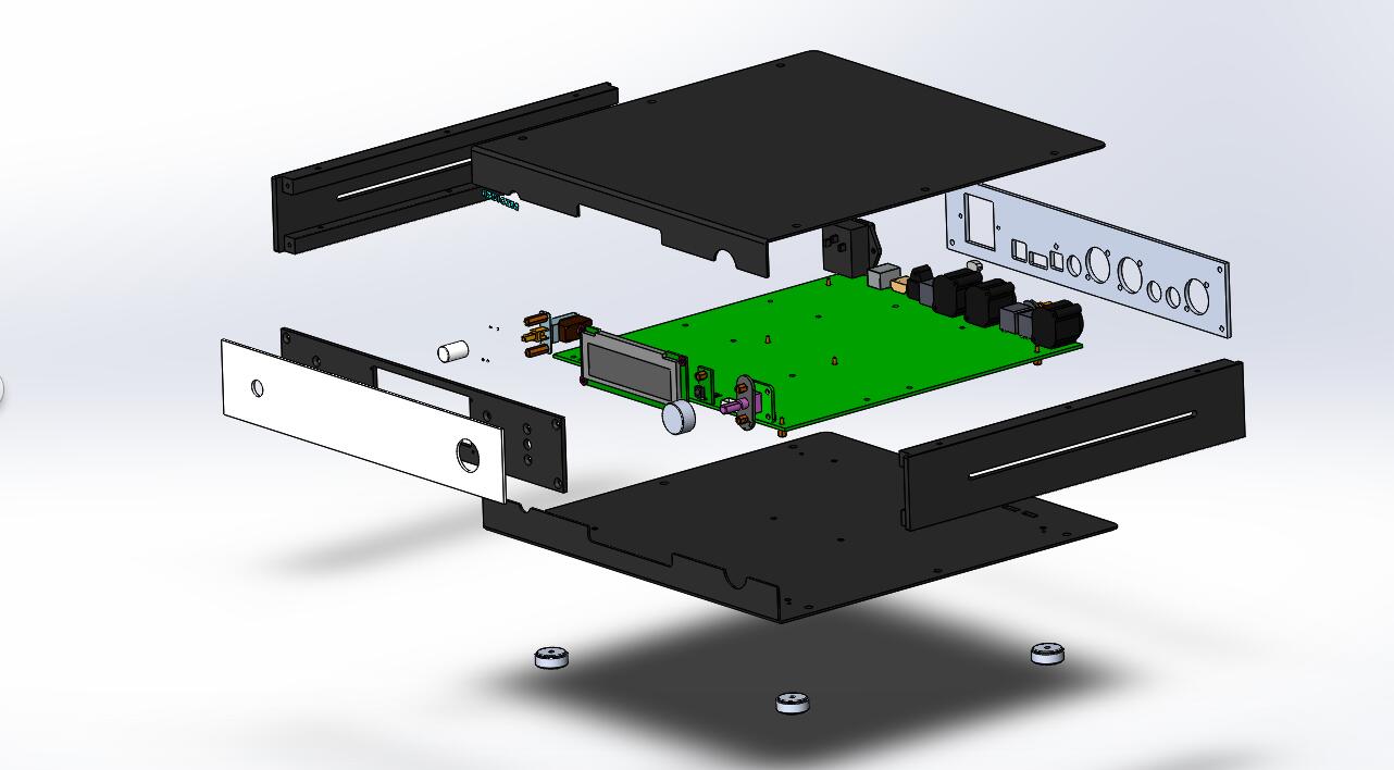

Is there anybody on this thread who has made enclosures yet? It would be fantastic if somebody had .dxf files - or drilling templates - for an enclosure that they would share.
A nice board like this deserves a nice enclosure..
Thanks in advance.
Yes, working on it. I have the machined parts and I'm about to start assembly...
I'll post some pictures in a few days.
