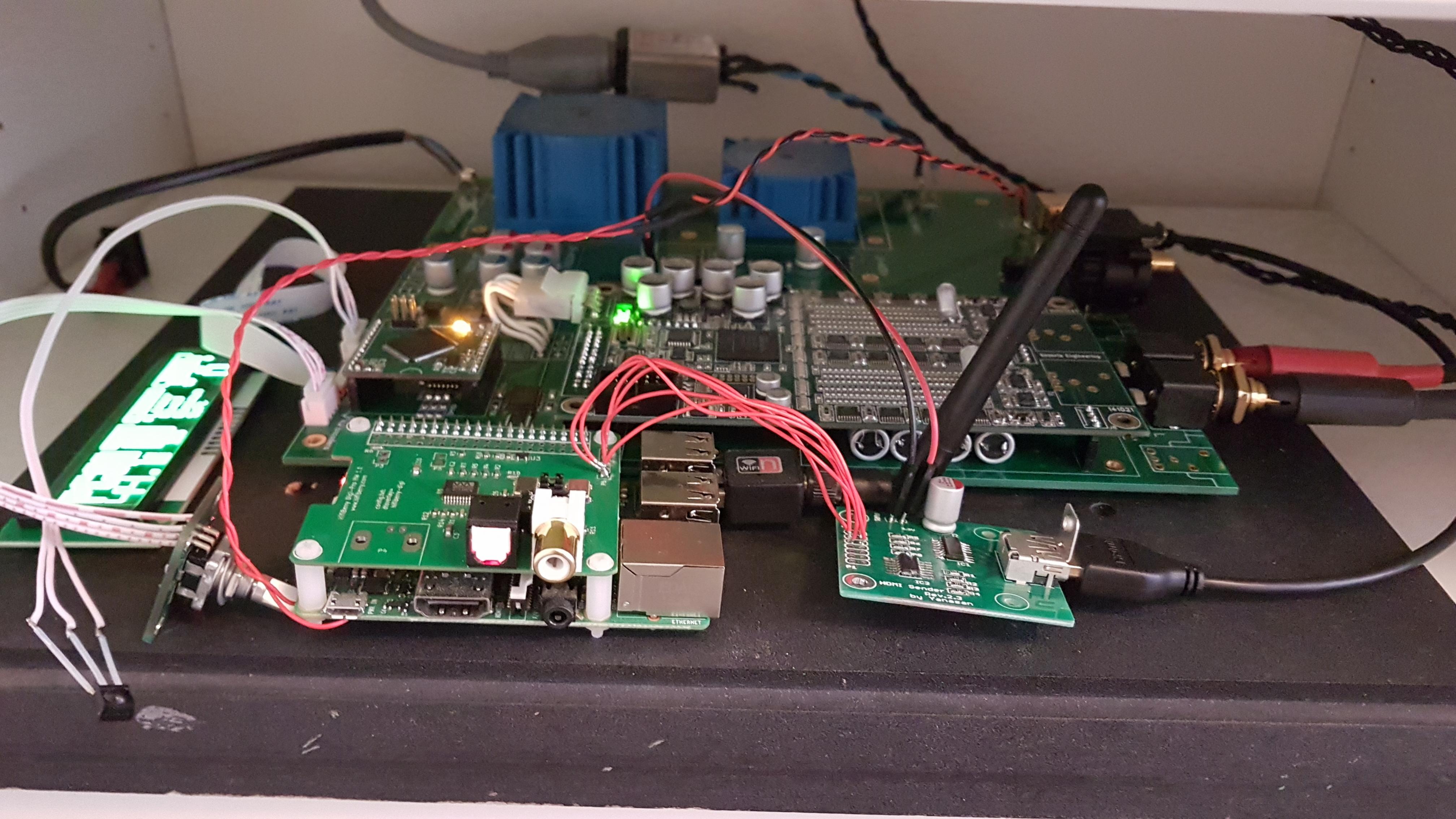

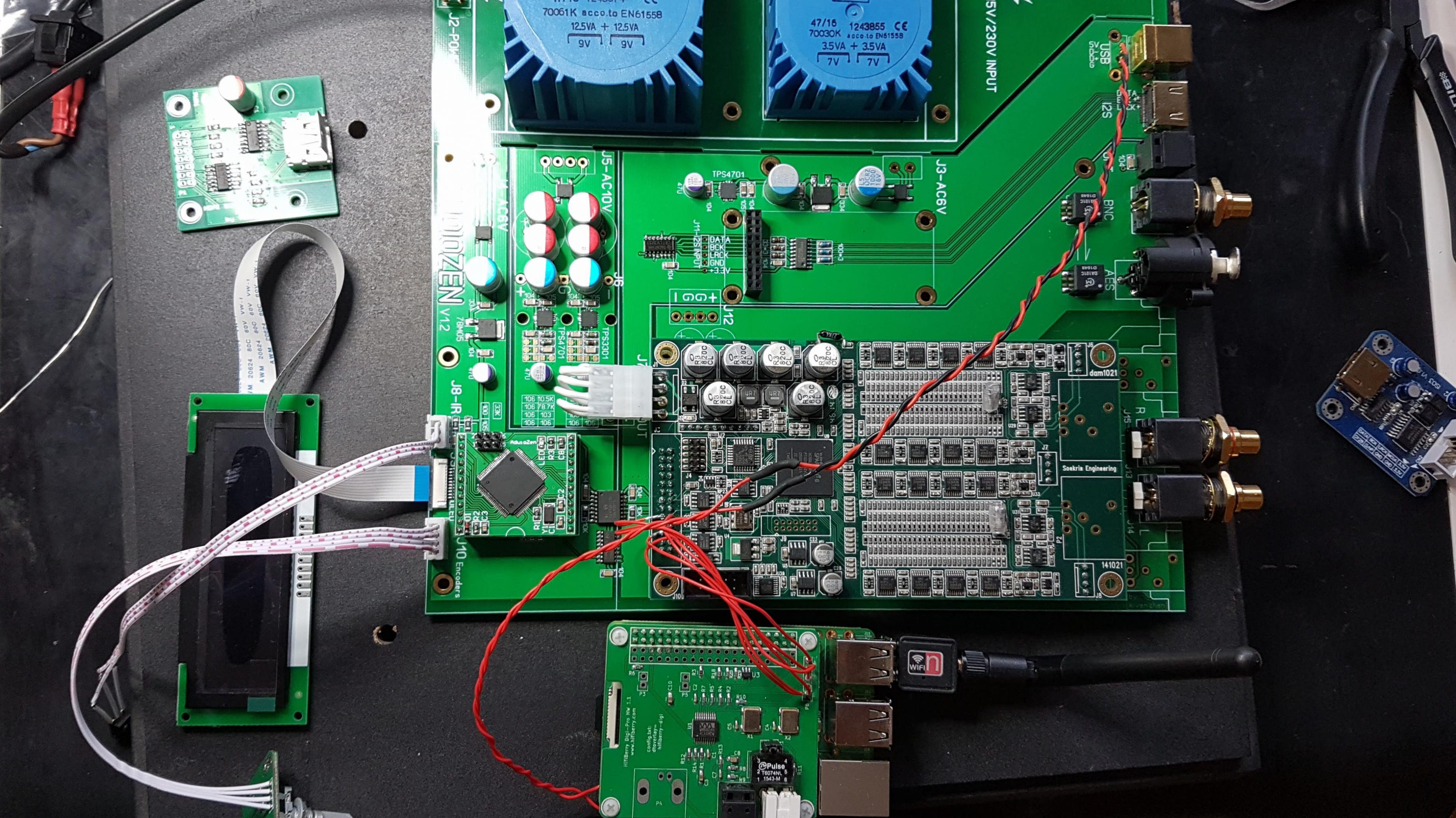

Are there any advantages of converting the rpi i2s to i2s(lvds/hdmi) and using the sk1021 i2s(hdmi) - in?Using J11 to connect the raspberry pi, you need to remove three 33 ohm resistors. This way, the i2s is the raspberry pie, but the hdmi i2s isn't available.
Or is it just as good as connecting rpi i2s direct to the sk1021 via J11 or direct coupled to the dac as I have?
I will test both options as I have several small pcbs i2s to i2s(lvds) - hdmi tranceivers produced.
Under is my prelimenary setup. rpi direct coupled via hifiberry digi+ pro to the dac for the time being. Tapping 5vdc to the rpi from the sk1021.
Prototype i2s-hdmi tranceiver upper left.
Success. Testing rpi i2s to i2s(lvds/hdmi) and using the sk1021 i2s(hdmi) - in.
Works like a charm after some "fiddling".
Unable to tell if there are any changes in sound between i2s direct or converted to lvds.
They both sound excellent With this setup using the rpi as a standalone streamer to the sk1021/dam1021 will be a great setup

Thanks for testing! So it doesn't matter how I connect it, they both work fine?
With hdmi is neater, but more parts Else I need to make a nice 5 pin connector. Or put the rpi in the dac hahaha!
