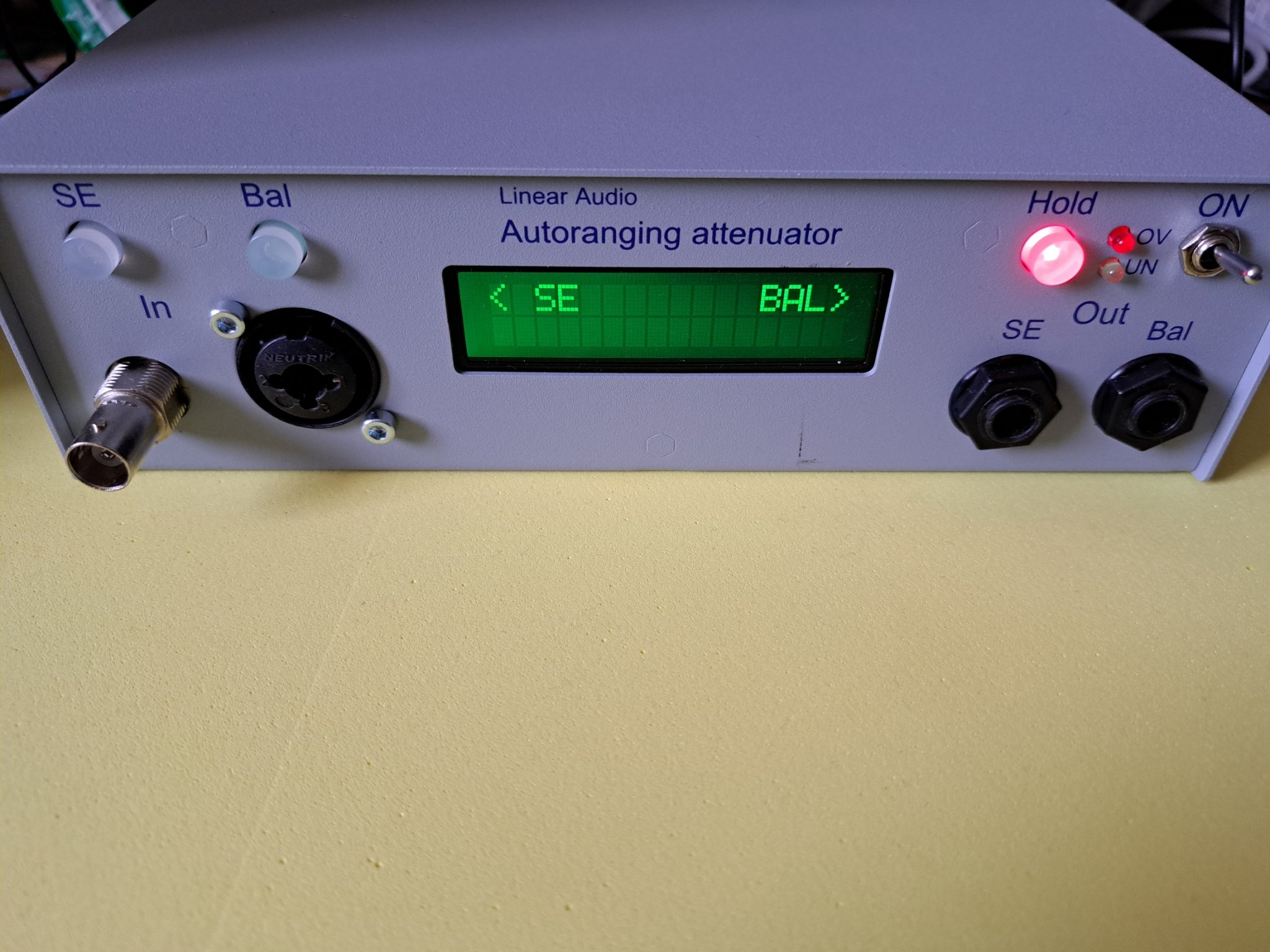

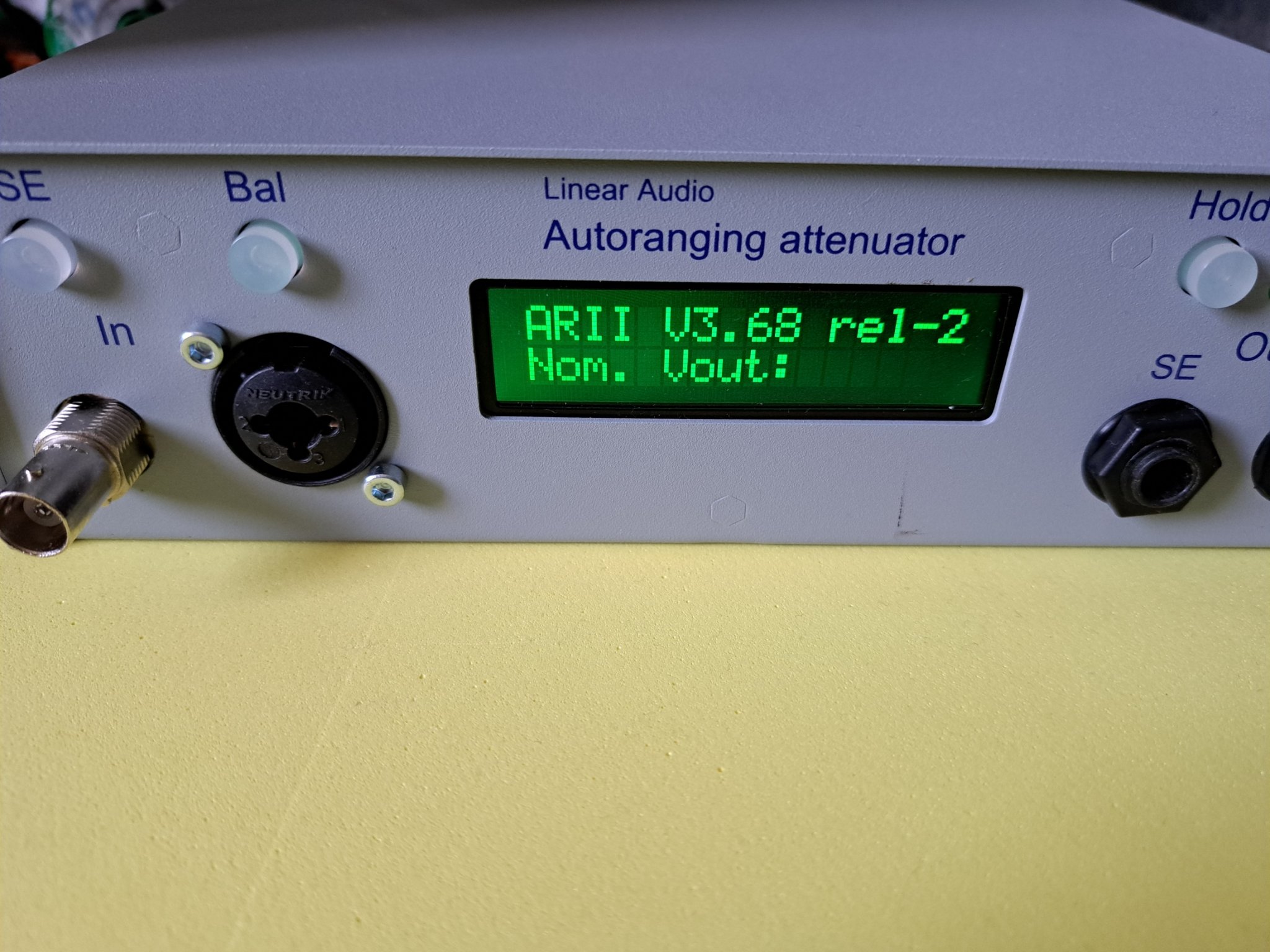

May someone halep and give advice,
I like to adjust the output volume but it seems that function not working,
(methode Power+ HLD button)
