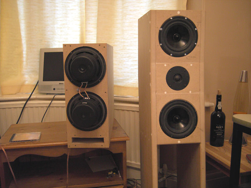

Hopefully I'll get a chance to screw the thing together tonight, and then I'll give it a blasting.
There's happilly a natural lack of midrange coming out of it. My housemate has already expressed interest in taking this prototype in his car boot when I'm done with it... There really shouldn't be much waste, and I don't *have* to go ahead and use this design in my real hi-fi.
Hopefully I have enough parts lying around to make a 2nd order low-pass filter, and a 2nd order high-pass too! Or they could even be first order I guess, maybe crossing around 200hz. Any thoughts?
richie00boy said:I'd personally try both 1st- and 2nd-order. Also, you could also try a low-Q second order filter. I can send you a very basic/simple program I wrote to easily calculate the values for second order filters, if you want.
Ooh, yes please
Right, I understand Q in terms of loading a bass driver, but not in a filter...
I intend to make the x-over variable using two pots (or switched resistors) for testing purposes. I'm not sure what the result of using a single bass speaker will be tho.

Hmm, the problem is I need to build around my current speakers, which only really leaves the part underneath them.
Now that I've had a dirrrrty fryup I'm working on screwing this box together...

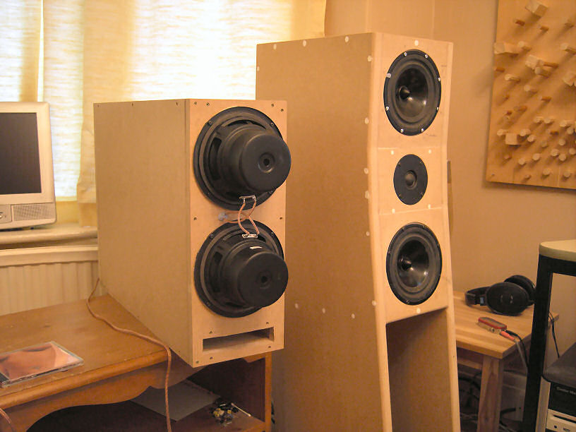

It definately needs glue, lol. The panels rattle when the going gets tough, and I think the leaks are sort of unloading the drivers, so they move more than expected. The sound is fun playing garage or speed garage and it allows me to turn the sub up to match the mid and upper bass with extra low stuff.
I can now get enough midbass to feel it in the chest, which matches the subs forcefulness better. It was actually slightly scary listening to some music! (it was pretty loud..)
This little experiment was encouraging, and I can see two of these x'ed over at 150hz 1st order matching the main speakers and sub well.
People may not realise why I'd cross so low, but the reason is simple - I often listen to electronic music, and the power distribution is clearly skewed to the bottom end!
It'll free up my main speakers to do their thing more cleanly. Can't wait to hear it all properly now.
It's all glued apart from one side panel (for access). That side panel was rattling a lot inspite of being attached with over 10 screws. The two large side panels desperately needed at least a small brace to break up the large untouched area. The glue is drying now. Still more cone movement and also port wind than I expected... Will report more when I've secured the side better tomorrow.
