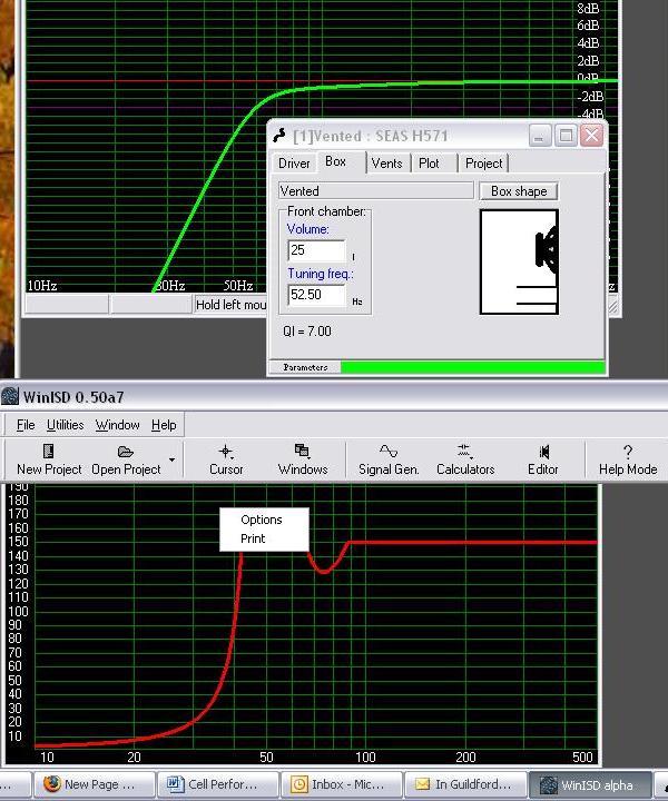

SimontY said:Hello,
Here is a flow chart making clear what we're talking about doing.
Hmmm.........
An inelegant solution to an ill defined problem.
Sorry to enter the discussion at such a late stage but.....
I'm going to play devils advocate and assume that in fact there is
nothing wrong with the Seas drivers, so therefore there must be
something wrong with the "current system", I think there is.
Frequency response
Transient response
Distortion
I can see possible problems with all three.
1) FR - not enough BSC
A maximally flat reflex design with full BSC will sound bass heavy
due to the influence of room gain. If the bass level is set by the
level of BSC applied the end result will be an lack of upper bass.
i.e. by setting the level of bass below 100Hz with BSC, whilst
BSC should apply to ~ 150Hz to ~1.5Khz you cause a dip.
2)distortion
Lots. By definition any bass your sub is producing the speakers
are also not producing as they are operating below the reflex
cutoff frequency. What they are producing though is lots of
distortion. Reflex power handling below cuttoff is very poor.
3)transient response
Any arguments such as sealed vs. reflex go out of the window if
you introduce a 4th order LR c/o at 50Hz. The resultant group
delay of adjacent 4th order high and low filters would give most
subwoofer designers nightmares.
Possible solutions
The speakers reflex alignment should be severely detuned to
give power handling down to the lowest frequencies.
Usually this means a port frequency of 26 to 32 Hz.
Alternatively they could be sealed and and a 2nd order electrical
high pass applied to give an overdamped 4th order overall.
Either of the above strategies should aim for overdamped bass
which should allow full BSC to be applied. The room gain below
100Hz should kick in to give reasonable bass extension.
The sub should have an overdamped low pass roll-off. I'd suggest
adjustable frequency 2nd order Bessell. The frequency and level is
adjusted to suit the speakers response in room placement.
For optimum transient response the subs high pass alignment
should also be somewhat overdamped, though at 20Hz its
arguable that transient capability is really an issue.
A minor point to the above is I believe MTM 2 ways are fine for
home theatre but flawed and very difficult to get right for hifi.
Using full BSC would allow them to be 2.5 ways.
I hope this helps...........
/sreten.

sreten said:Hmmm.........
And what a nice way to enter it.
I must disagree. The problem with the Seas drivers is they can't play bass well enough for my needs.
Frequency response
Transient response
Distortion
The speakers seem to have been designed (Seas Pontus is the design) with no baffle step correction. Obviously, this didn't suit my ears. And can I just say that we can't buy our first speaker kit or design our first speakers knowing everything about speaker design. When you pay good money an assumption is made that the design will be sound. It wasn't.
You are correct in your assumption that the balance of bass is that of a lack of midbass and moreso upper bass.
This sentence doesn't quite make sense (I am tired though).
2)distortion
So you think they also designed the speakers to be distorted. I'm not sure what your point of reference is here, when you say "lots". Most speakers are not controlled below port tuning, are they?

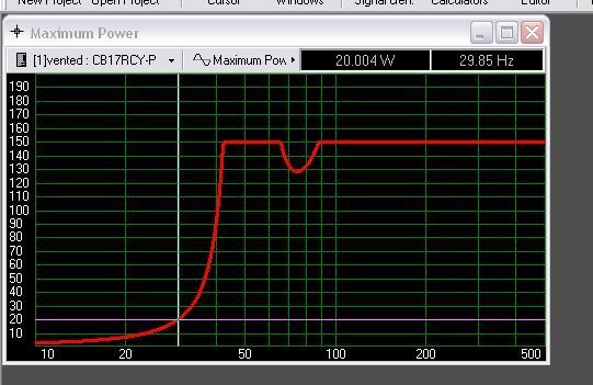

The implied assumption here is not borne out in reality. This system *needs* 4th order lowpass and not 2nd order to integrate the sub and speakers. I'm not saying it can't be better, but there is a reason for everything, Streten, including my putting a x-over there.
Possible solutions
I don't like this solution. I can't imagine it would provide the correct bass impact. Two low xmax 6" drivers seem to be insufficient. The speakers would also overlap with the sub's output, and there'd be a weak midbass area, or so it would seem.
The sub should have an overdamped low pass roll-off. I'd suggest adjustable frequency 2nd order Bessell. The frequency and level is adjusted to suit the speakers response in room placement.
Ok, I see the logic when you combine this with the above, but with this shallow rolloff I'll be hearing a little too much of that big subwoofer again.
High pass, on the sub? Is that a joke? It is tuned to 20hz. There is no need for a hi-pass filter on it.
Perhaps a passive 2.5 way x-over will get the BSC sounding right. This is something I'm yet to try, but I don't know that it's appropriate if I'm adding a bass only section.
/sreten.
Well it certainly has opened up deeper thoughts on the subject.
I do wonder why, when you want help, some people only contribute when it's already somewhat too late.
all subs have an acoustic highpass (followed by lowpass) response.
Otherwise they would play down to DC.
I'm sorry that it took about a week of mulling it over before I thought
that I could explain most of your problems without the Seas drivers
being at fault.
Edit : and that a reflex speaker with a 50Hz acoustic L/R alignment
would have serious distortion issues below 50Hz if driven full range.
The inelegant comment referred to using two 6.5" in large boxes
for the range 300Hz upwards, when a single 5" could do the job.
It wasn't intended to be derogatory.
/sreten.
sreten said:Hi,
all subs have an acoustic highpass (followed by lowpass) response. Otherwise they would play down to DC.
Ok, well considering I don't intend to play music containing DC I'm not going to start worrying about distortion in that range.
I'm sorry that it took about a week of mulling it over before I thought that I could explain most of your problems without the Seas drivers being at fault.
You make it sound like your sole purpose was to exonerate those drivers, lol
I feel touched that you mulled over my problems.
