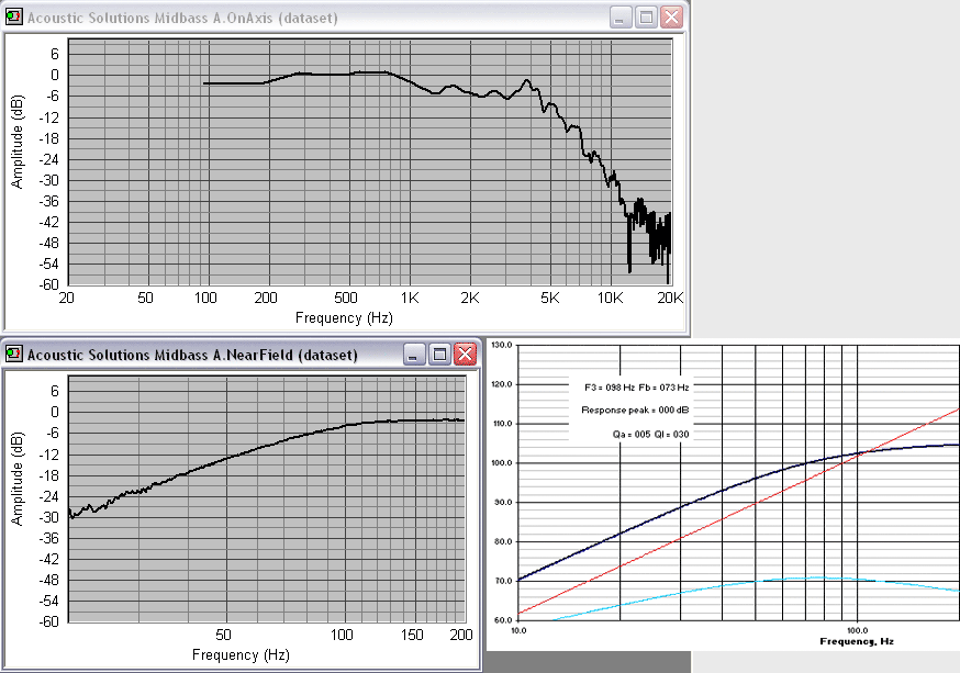

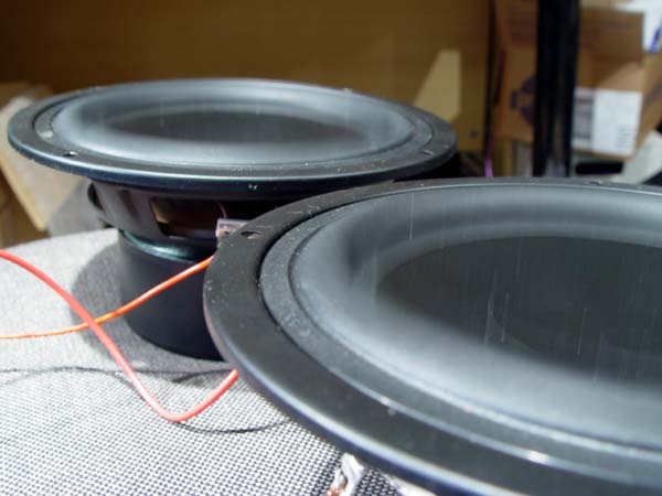

Drivers measured straight out of the box:
Not very consistent, but not out of the ordinary either.
Attached is the FR measurement in a sealed 240mm cubed enclosure (13.82 litres) using Driver A. The FR is quite well behaved and extends to 4k before a smooth drop off. I've also shown the modelled response based on the measured T/S to compare.
The drivers are being run-in now and I will measure again after a couple of days.

Hi Vikash,
Great work! It's nice to see such an ideal frequency response. I'll have to try them as mid/basses in a 2-way or 2.5-way speaker project.

The smooth rolloff could make for an easy tweeter integration in a 2-way. Infact I have some tweeters lying around which might work here...
FYI Unibox reckons 88.4db efficiency 1W 1m, and models well in a ported enclosure of 18 litres tuned to 56Hz. F3 of 50Hz.

There will be a slight difference after run in for sure. How much I don't know, but more importantly since the run changes compliment each other (Fs and Qts go down, VAS goes up) the modelled response is not usually that different anyway. I just like to be thorough
Also I used a cubed enclosure that was lying around to take the FR . I'm not sure how measursable the effects of standing waves are, but the FR might be smoother once run in (skeptical) and in a proper enclosure

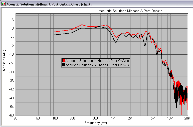

T/S after 48 hours break-in:
The drivers show little relative T/S changes between pre/post break in. Certainly less than the consistency between drivers.
Attached is the FR of both drivers (measured at the same distance!).
Hi Vikash,
Thanks for that. Very nice graph. It shows if u wanted to make anything really good with these drivers you'd really have to measure each one!!
I will model an average of the results, maybe even including my results, in WINISD and see how the box I made looks..
Simon
