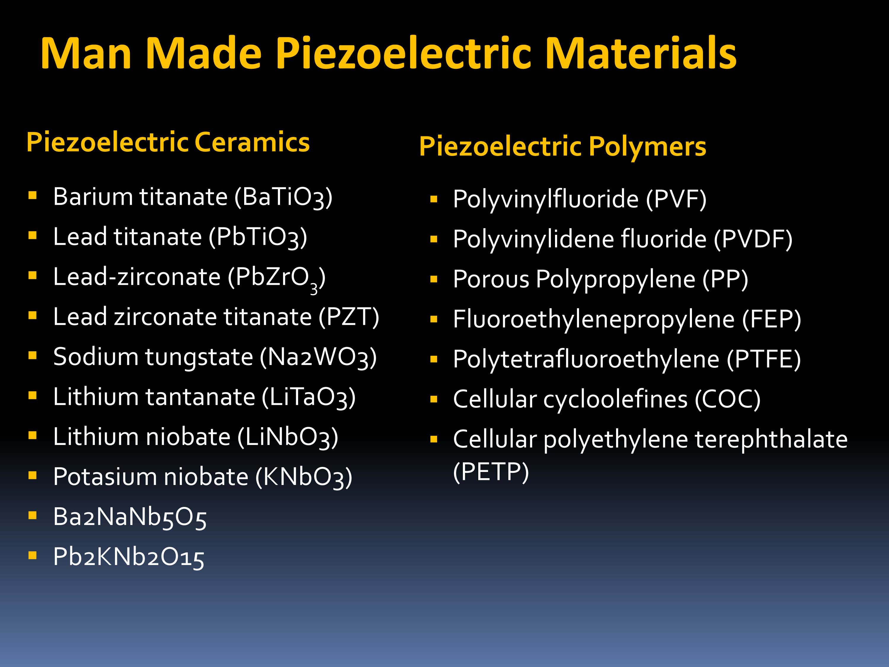

I had a bad experience with teflon insulated wires, I don't know if it was piezoelectric or triboelectric or whatever…
As Morgan Jones correctly pointed out, PTFE is both, piezoelectric and triboelectric.
When a cable is mechanically stressed through twisting, compression, or flexion, the cable itself generates noise, referred to as microphonics.
This noise is due mostly to piezoelectric effect, triboelectric effect and capacitance changes.
