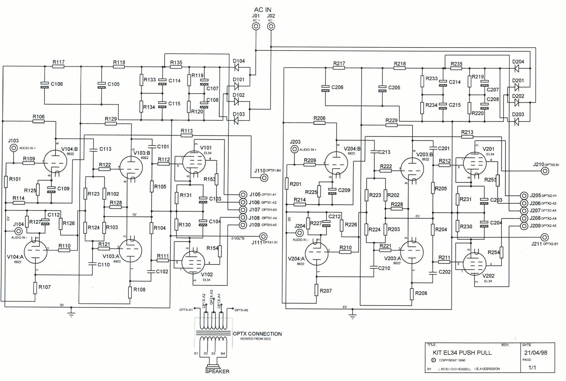

>We found a big difference making this cap a poly one.
Do you have experience with this circuit, in this amp?
It doesn't matter really! The last PSU cap is for SURE in the signal path. Class A is the best case scenario but still not perfect.
Electrolytics caps are leaky and lossy, more than any other. Very good as resevoirs but bad for filtering.
Yes, the Grant Fidelity RITA has the same topology, with a paraphase splitter > LTP > UL output stage. It made a significant difference modifying the 1st stage to a CSS loaded LTP.

...sorry, but just because you might have fixed some Chinese Yaquin push-pull, doesn't mean you have experience with this amp. Suggesting modifications "that significantly improve it" before even listening to it has the same value as suggesting more salt by looking at a picture of a soup.
Ok, let´s see, here we have a circuit with a well known topology. Many people can judge the audible merits just by looking at the shematics. Pharaphase splitter, ok, can be good, BUT nowadays that´s been superseeded with LTP.
NO bad circuit can be salvaged by throwing in the most costly parts available
And the notion that polymer caps can be formed or bettered by time, that is utter BS. What happen is, that your ear becomes accustomed to the sound, not that "some" part changes it´s properties. Your ear is much more customisable than any of your gear (in small propotions)

Electroharmonix EL34 vs Genalex Golden Lion KT77
This has been probably discussed quite often here, but I would still like to open a new thread on it. After about 1200 hour the Electroharmonix EL34EH tubes in my Audion Edison 60 amp (class A) are showing signs of fatigue, with one particular tube generating a lot of short bursts of white noise in the warm up phase. By exchanging the tubes, I could exactly identify the culprit.

Thank you or all the answers. Here is the schematic of the amp, the pin 1 is already connected to pin 8 (originally came with EL34EH), and its an autobias.
