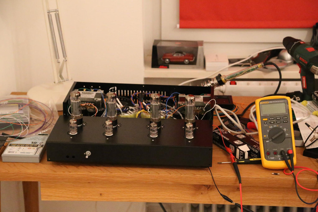

I finally defeated my laziness and decided to write a short Audion Edison 60 building report:
Edison 60 prices and options

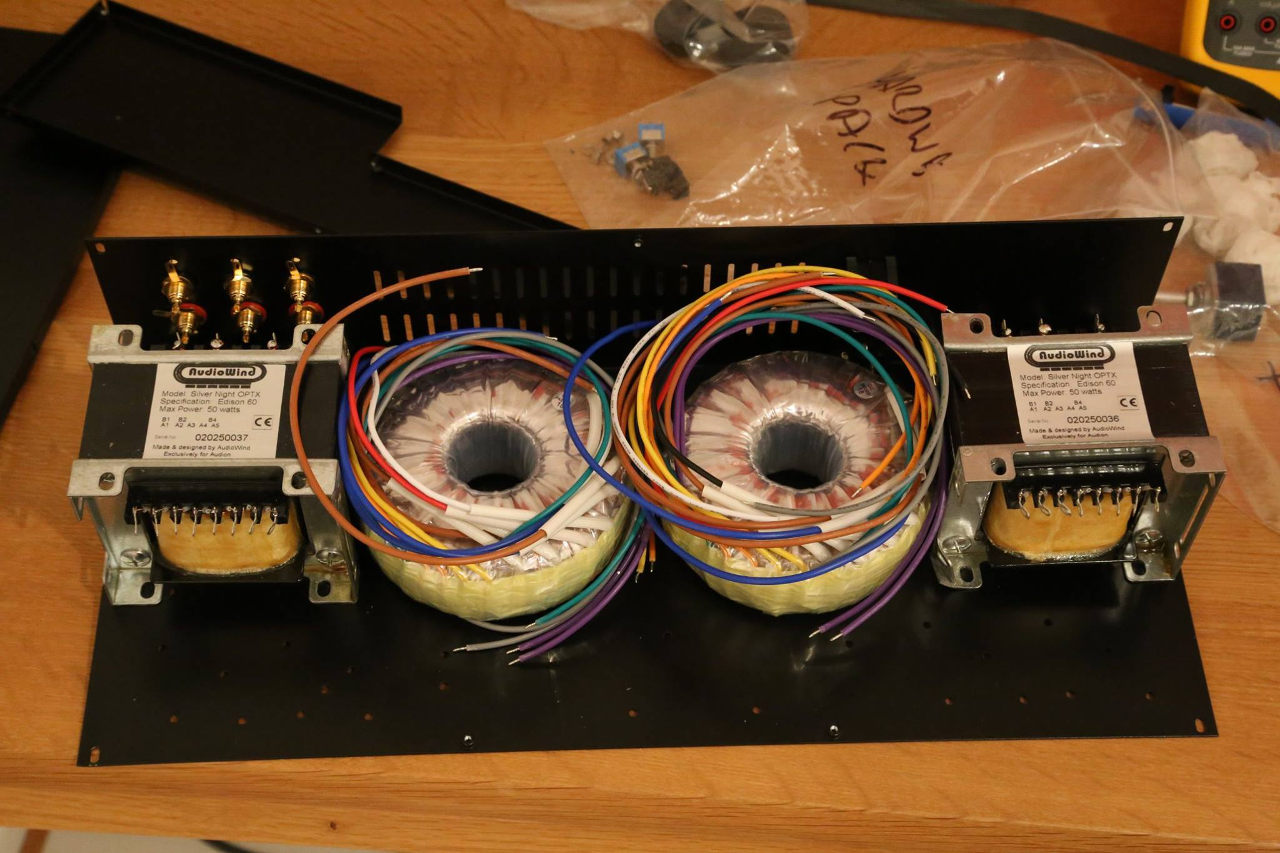

I have got all the available options (incl. tantalum and foil capacitors), but not the silver wire. The variant built here is the Edison 60 plus dual monoblock 30W push-pull Class A amp, with the Silver Night output transformers. As a short background, I am an Electrical/Software engineer, with limited background in High Voltage (think >30.000V) applications, and significant experience in low voltage (48-1200V) region.

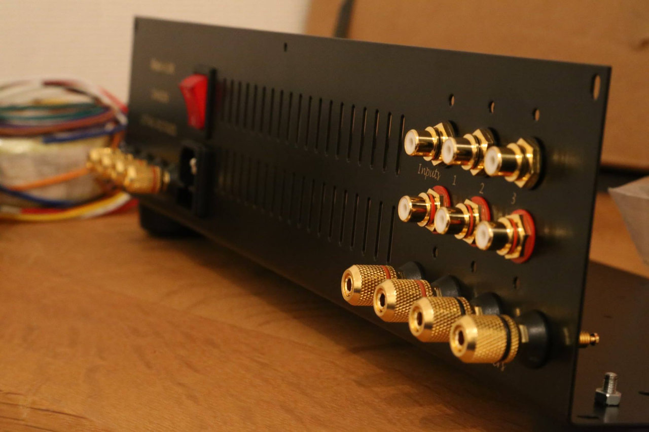

The kit was delivered excellently packed, in just a few days after placing the order. I found it impressive that the output trafos were wound and baked after the order was placed. This configuration, as seen in the pictures did require some careful planning and hole drilling, in order to allow a symmetrical transformer arrangement.
Although this was not my first build, it took me a significant number of days to finish it. I do take a lot of pleasure in working slowly and to perfection, while anticipating the final result. The kit does offer a lot of satisfaction from this point of view.

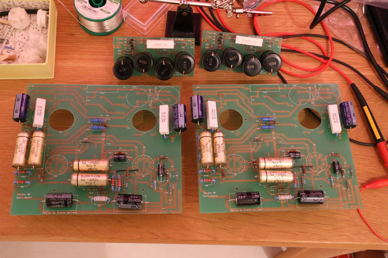

As seen in the pictures, the "Plus" kit comes with two power supply toroids+boards. The amp itself is a hybrid between point-to-point and board soldered constructions. The soldering itself is not particularly challenging, with parts this size.

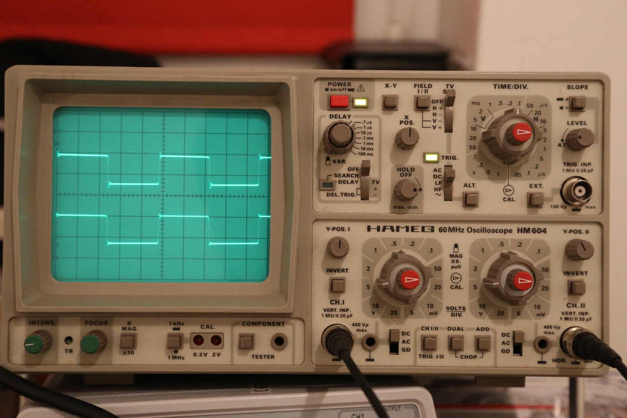

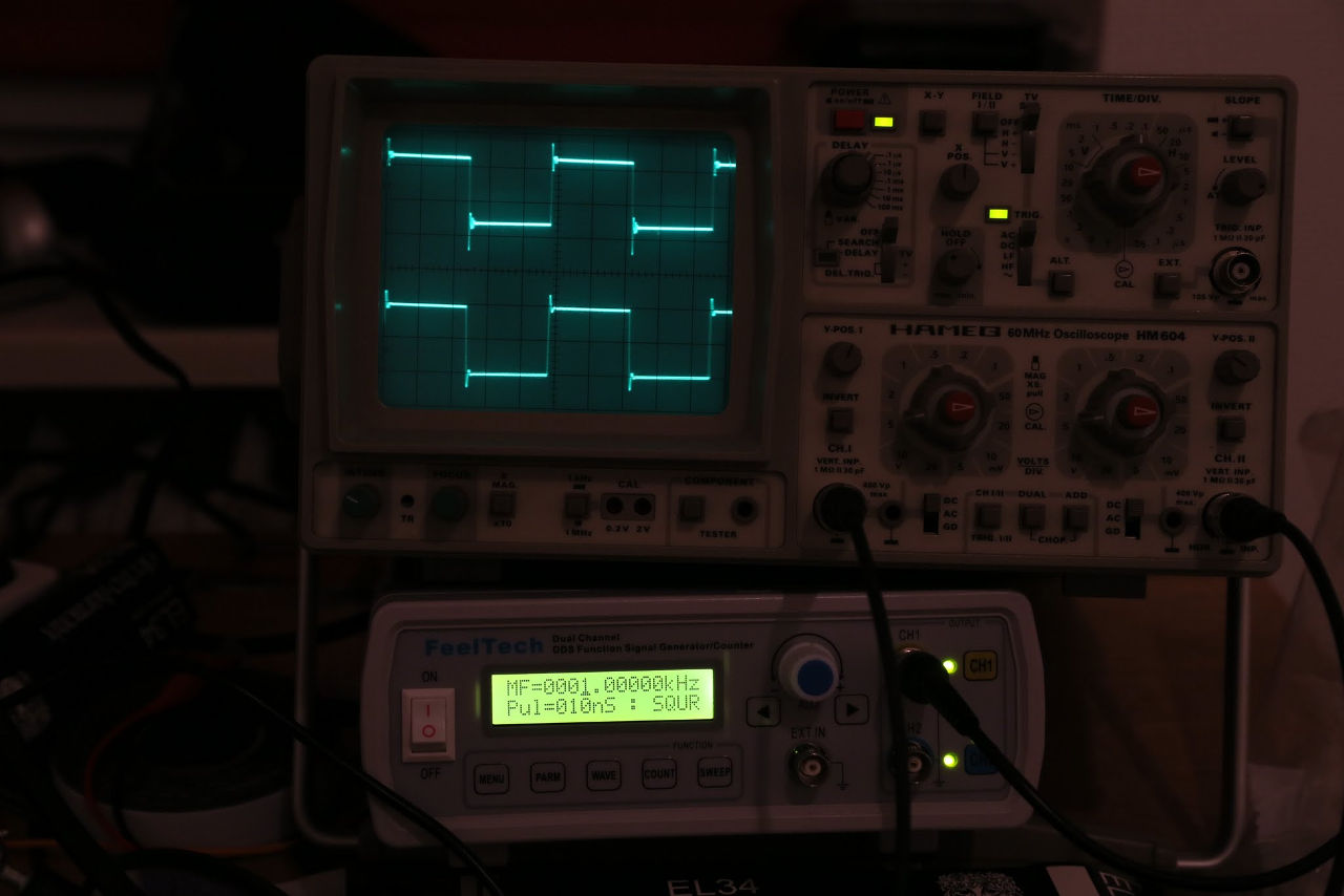

The oscilloscope screen shots show the square wave response during the amp's burn-in process (after 2 minutes from the first power up, capacitors not yet polarized, after 50 hours and finally settled after 100 hours). Any questions, comments, suggestions, etc, are welcome .

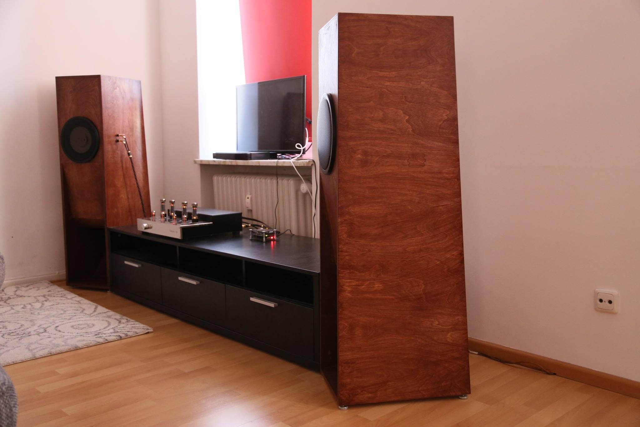

Oh, BTW, sound-wise, this is probably the best 30W amp one can get period. I'm using it with 98dBmW FE206En speakers (usually <1W, but sometimes at a very loud 15W of power), and the bass-mids-high dynamics, stage presentation and (lack of) noise is better than anything I've ever heard before. Can't imagine this being significantly improved by another amp, for sure.
A lot of hyperbole here, but as long as you like it, that's all it matters.
The oscilloscope screen shots show the 1kHz square wave response during the amp's burn-in process (after 2 minutes from the first power up, capacitors not yet polarized, after 50 hours and finally settled after 100 hours).
Are there electrolytic caps in the signal path?
… 98dBmW FE206En speakers...
More like 96 dB.

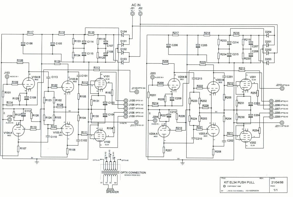

LOL, nope, of course not. You can see the four big golden ERO foil capacitors in the pictures. Those are the signal caps (1000V .33uF). They do polarize with usage, and the process takes about 100 hours, as seen on the scope traces.

The Audion Silver Night output transformers are for up to 50W.

Here is the schematic, btw... With autobias.

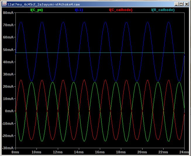

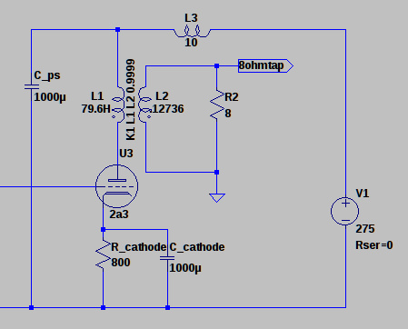

I and LTSpice would quibble strongly with that definition, but rather than start another endless debate just wanted to point out craft stores catering to jewellers carry 99.98% pure dead soft bare silver wire in gauges suitable for hookup for under $1/foot. It's cheap to try out. Higher purity is reportedly almost always NASA grade unobtanium or marketing fiction.
Well, what's the definition then? Original audio signal does not pass through the power supply caps, so they aren't in the "signal path". The output audio signal does pass through the power supply, so the electrolytic caps will influence the final output. Given the lack of noise, even with 96dB speakers, and even at very loud volume, there is no problem with the electrolytics there.

I rarely sweat definitions, almost always too much social and linguistic noise. Rather just look at circuit behaviour. Call them whatever you like, what really matters is dynamic audio current passing through the plate load is mirrored in the power supply and cathode caps. Below is a simple circuit thrown together to illustrate with sim results. Large dynamic audio currents flow everywhere, ironically least of all through the cathode bias resistor.
Looked at in the simple terms of, for lack of better label, 'introduced error' the PS cap would inject them in the least sensitive part of the circuit but it's also the greatest voltage swing. Potential cathode cap 'introduced error' directly effects the grid-cathode voltage and would be amplified.
Viewed from that perspective I never found it useful to define them as not in the signal path.
