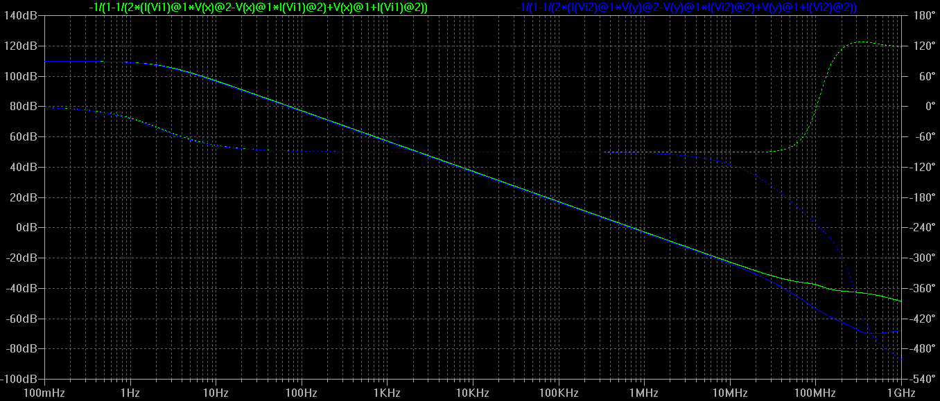

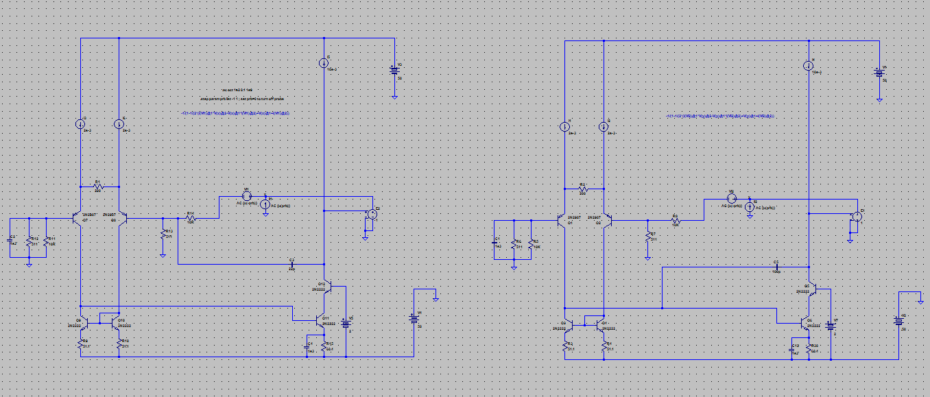

Profound apologies to you bob, Bonsai and others! I have run the simulations with LTSPICE stock BJT models and have found the following:
1) Pole splitting does occur in fact with MIC, which is correctly so-named by Bob.
2) Only a fifth of the compensation capacitor used in ordinary Miller compensation may be used with MIC for the same loop transmission. I don't know at this stage why this is the case. Any ideas anyone?
3) MIC is NOT lead compensation at all, although it appears to produce a zero far beyond unity loop gain frequency that does not occur with ordinary Miller compensation.
4) The MIC local loop is unstable and requires compensation.
Now, why I obtained results in 2004 that suggested that MIC is lead compensation with the output stage excluded and did not cause pole splitting, I don't know at this stage; I must have made an elementary error with my simulations. Apologies to all.:confused:

Glad you found you made a mistake and are man enough to admit that after all the arguing. Sometimes we just have to discover a problem ourselves before we can admit there is something that we just don't understand or didn't see.
Theses two point are linked , MIC loop has higher loop gain (hence the necessity of a lower cap) since the loop include the input stage that will add its gain but will introduce an additional pole due to the added ( of the same input stage) transfer function that is not present with
classical miller compensation(it is outside of this loop).

Mikeks, yes the MIC loop will probably require compensation.....Usually an RC combo across the LTP collector load is the best place to implement this.
It would appear placing shunt capacitance across the current mirror output introduces a pole in the local loop that worsens the instability of the local loop. :scratch2:
Adding a resistor in series with the shunt capacitance merely cancels that pole with a zero, which gets you right back where you started.

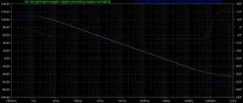

edit: For your loop gain, given the ideal buffer stage you don't need the current injection at that node. Neat thing about LTspice is after the dual run you can still plot just the voltage across the vsource for the voltage run or the voltage with the current source only, for a comparison to the dual source, or to see the individual contributions (just use plot setting-select steps or the @1, @2 selections).

... I have run the simulations with LTSPICE stock BJT models and have found the following:...
Nice work and informative. Well done all-round.
I assume the Green plot is the MIC? The global phase looks better than one could hope!
Mikeks, yes the MIC loop will probably require compensation. Bob has mentioned this a few times. Usually an RC combo across the LTP collector load is the best place to implement this.
Why do you think this? Prima facie I would expect the best way would be to have a little nested Miller compensation around the VAS itself. I previously asked Bob about this and he replied that he did the shunt load because it was simple when he already had a lot of innovation to work out.
Michael,
Thats why I lowered to the feedback resistors as they are part of the integrator with MIC, as well as encompassing more gain.
It's a function of the resistor values. For the usual Miller compensation, the ULGF is gm1*B/Cm. gm1 is the LTP transconductance; B is the feedback ratio which I have taken as approximately R7/R8? (can't read it) for closed loop gain >>1.
For the MIC, the ULGF is 1/(Cm*R14). R14 and R8 are the same resistor in the two circuits so can cancel out in the algebra.
For equal Cm in both cases, the result is 1/gm1 ~= R7. Since your 1/gm1 is about one-fifth of your R7, you need a 5x capacitor.
Hi Mike,
This is just standard lag-lead compensation, and it does indeed work well. The MIC loop is compensated for a unity gain bandwidth of about 10 MHz.
