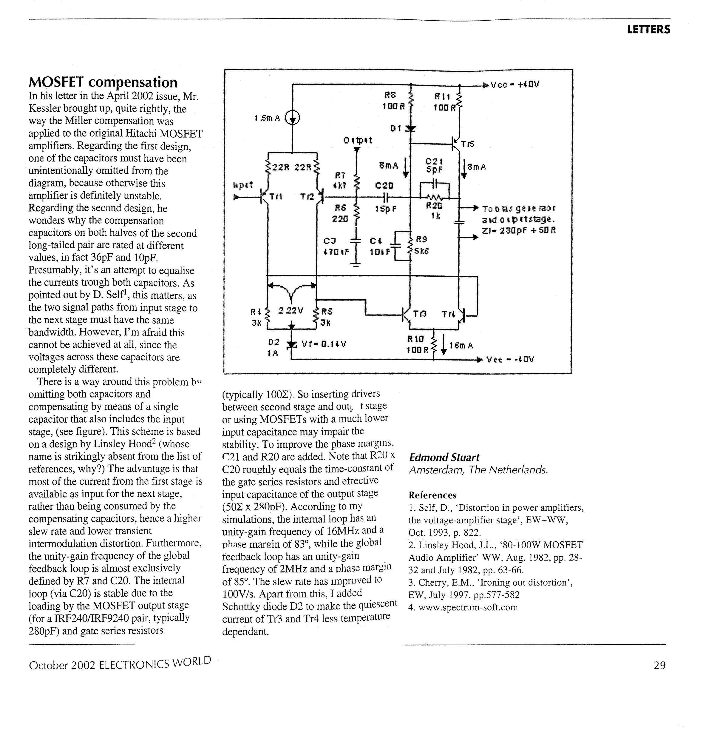

TMC
Hi Douglas,
First, apologies for the late response (due trouble with my PC*).
As for TOIMC, admittedly, that would be a more exact description, though it's still ambiguous. As David pointed out, there are also other transition schemes possible: Transitional Input Miller Compensation (TIMC), for example. But that's not the only one. Also a combination of the two is possible: input AND output inclusion. How we call that? Also TOIMC or TIOMC? And what about the combination two pole compensation (TPC) and TMC: TTMC?
Anyhow, most of us know what is meant by TMC, so let's keep it that way.
The idea was born somewhere in the mid-nineties, when I was thinking how to make Cherry's output inclusive compensation more stable.
I sent you the emails around February 2002. Perhaps this helps to find them again.
We have never discussed a letter to the editor. Maybe you confuses it with another letter (see picture below, a shortened version). That was about input inclusive compensation. But also in this case we didn't have any discussion about this subject, though you know about it, as you have listed it on your website.
Anyhow, it was you who told me that TMC was already invented by Baxandall. By then, you were the only one who know this. So no one else could have told me about Baxandall. This leaves no other possibility than our emails were about TMC.
Much depends on minor circuit details and how it was built. Too long traces/wires to the output devices for example, will be devastating. Also notice that Cherry applied output inclusive compensation in conjunction with shunt compensation by putting (small) capacitors between the base of the drivers and the supply rails. I guess without the latter has amp will also be unstable.
When? As I said, somewhere it the mid-nineties.
Hope you will find back the emails.
E.
*PS: I still have PC troubles. Just bought an Z77 Asrock motherboard. Regrettably, this MB doesn't work together with my PCI sound cards (a Lynx L22 and Waveterminal 192X). I get a lot of dropouts. It's due to the fact the chip set on this MB does not support (good ol') PCI. Instead, the PCI slots are connected via a flaky interface chip to the PCIe bus. Hence the dropouts. So anybody who's using PCI sound cards, be warned! When upgrading your PC, make sure PCI is supported sufficiently.
