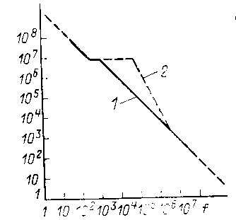

Dear Mr.Self.
pics posted I've found in a rather old book, 1983 to be exact.
It does look like TMC, although the purpose is(was) to design fast settling hybrid op amp...
Being sufficiently ripened I am just curious about the history of analog design.
Image #3 shows the circuit to be placed instead of compensation capacitor Coc1 @ Fig.1.
Boxes on Fig.3 show input stage (left) and VAS (right)
Fig.2 shows open loop gain.
Sincerely,
Alex

Dear Mr.Self.
Sincerely,
Alex
Looks like 2-pole compensation (TPC) to me.
