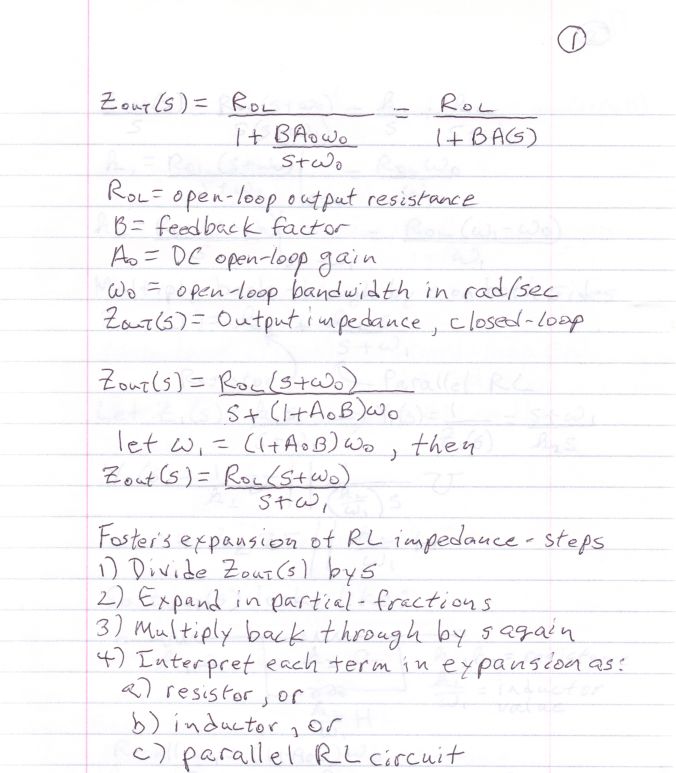

A while back we were talking about output coils . The subject of the output inductance of a feedback amp (without output inductor) came up. Namely, there's an inductive component of power amp output Z due to the feedback falling off as frequency increases.
I thought I'd try to find an equivalent RL circuit for the output impedance of such a feedback amp, based on a number of (really oversimplified) approximations and assumptions. The assumptions are:
1) Output impedance is purely resistive without feedback (yes I know this is not true in practice, but I'm looking for simple, first-order approximations here).
2) Open-loop gain is single-pole with DC value A0 and open-loop BW in rad/sec = w0 (= "omega naught")
3) Feedback factor = B is independent of frequency.

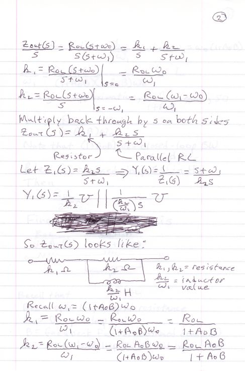

I did the derivation on paper using network synthesis techniques for RL circuits. I scanned these pages, as it's too difficult to do all the equations in the editor for the forum. Below is the first page of the derivation.

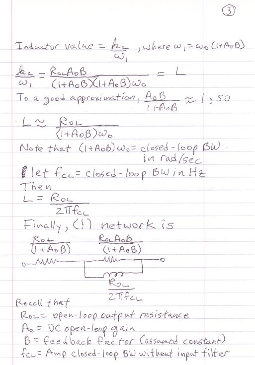

Here is the third (final) page of the derivation. You can observe that the value of the inductor of the network is:
1) Proportional to the open-loop output resistance
2) Inversely proportional to the closed-loop bandwidth (with the input filter removed)
The inductor value is on the order of tens of nH for a typical power amp. The formula for it is:
L = ROL / (2 * pi * fCL)
where ROL = open-loop output resistance
fCL = closed-loop bandwidth (with the input filter removed) = GBW / (nominal closed-loop gain)
Also note that the inductor is shunted by a resistor whose value is just slightly less than the open-loop output resistance (which could be quite small, especially in a design like the JC-1).

andy_c said:A while back we were talking about output coils . The subject of the output inductance of a feedback amp (without output inductor) came up. Namely, there's an inductive component of power amp output Z due to the feedback falling off as frequency increases.
Nice contribution Andy!!
Do you mind if I check, put in pdf and upload? It should take some days though because of other work, but think it's worth, after cursory review.
Rodolfo
ingrast said:Do you mind if I check, put in pdf and upload? It should take some days though because of other work, but think it's worth, after cursory review.
Hi Rodolfo,
Thanks for your kind words.
I'd appreciate it very much if you'd check my work, thanks! I found some errors when I was reviewing the scans, and you can see that I crossed some stuff out because of that. It started as a bunch of scribble that I tried to clean up to make the ideas clear to other readers, and in that process, some errors could have crept in.
Thanks!
andy_c said:
I'd appreciate it very much if you'd check my work, thanks! ...
Will mail you a draft for proofreading as soon as ready.
Rodolfo
