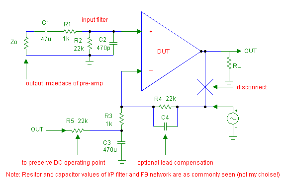

Hi Glen,
In addition to my reply #676, please have a look at the picture below, to make sure that we are not talking on cross purposes again.
Also, I have fiddled a bit with the "blameless" amp on my simulator. If R1 = 2k and C2 = 470pF, then the phase margin of the global feedback loop is 80 deg. If C2 = 0, then it becomes 75 deg. So there is a difference, admittedly, not that large, but I wouldn't call it "negligibly small". With your method, this difference would never be revealed.
Next, I made C4=2.7pF. Now, the phase margin is 92 deg. With your method we would still get 80 deg.
As said before, it is just as easy to do it the other (my) way, and (of course) it can be measured with the same equipment.
Cheers, Edmond.
G.Kleinschmidt said:Hi Edmond.
[snip]
If you're talking about the capacitor from the VAS to the inverting input, the same method works fine, but testing of the inner loop requires a bit of elaboration.
Glen
