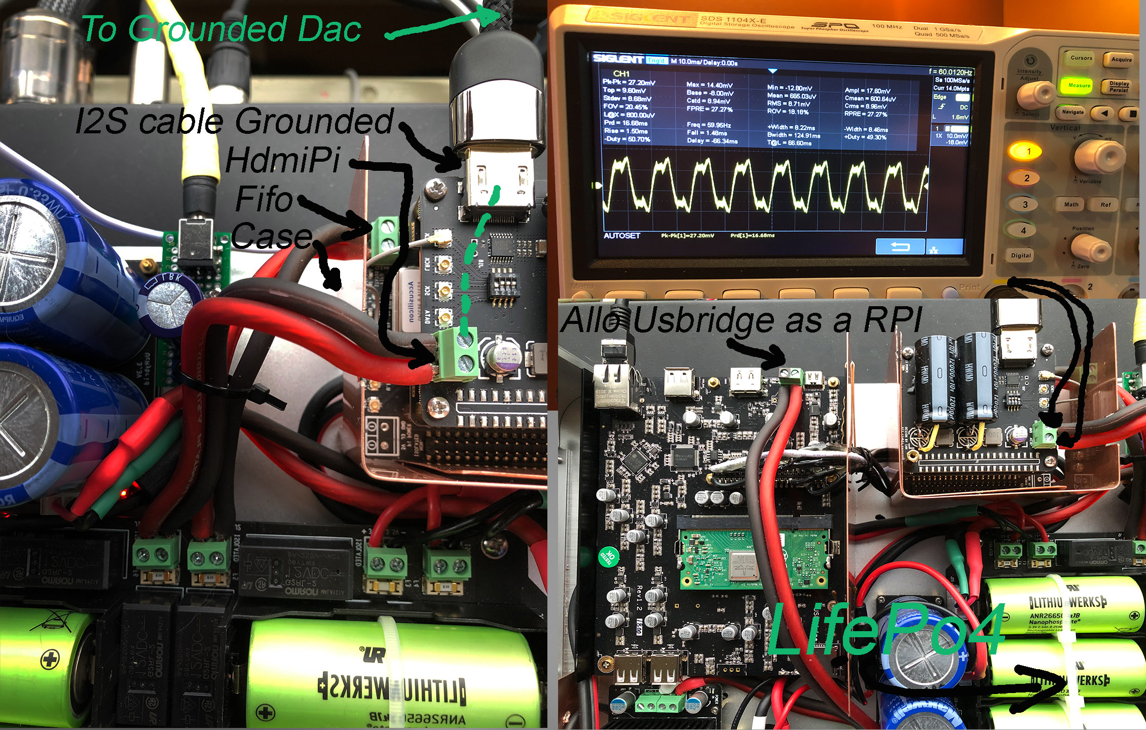

Ground question need some help
I need help figuring out how to ground my I2S streamer that I am building with Ian's parts.
Hoping someone or Ian can advise
I attached a photo collage of my system.
HdmiPi, Fifo 3, Allo Usbridge as RPI ,LifePo4, I2s Cable to my Dac
When I Attach the I2S Cable that is connected to City ground via the Dac it automatically connect to the Battery negative of the HDMIPI and introduce a 60Hz ripple on the battery line (I do not hear any noise) but I am concerned as we went to a great deal using Ian's amazing parts to have a ripple free power.
Big Questions:
1) Should all the battery negatives connect to the Chassis and ground the Chassis. that could be good and bad
2) Cut the I2S grounded Shield close to the entry, it will still be shielded but not connecting to the battery negative of my streamer.
3) What battery negatives should connect together, which of them should connect to City ground and how to eliminate ground noise.

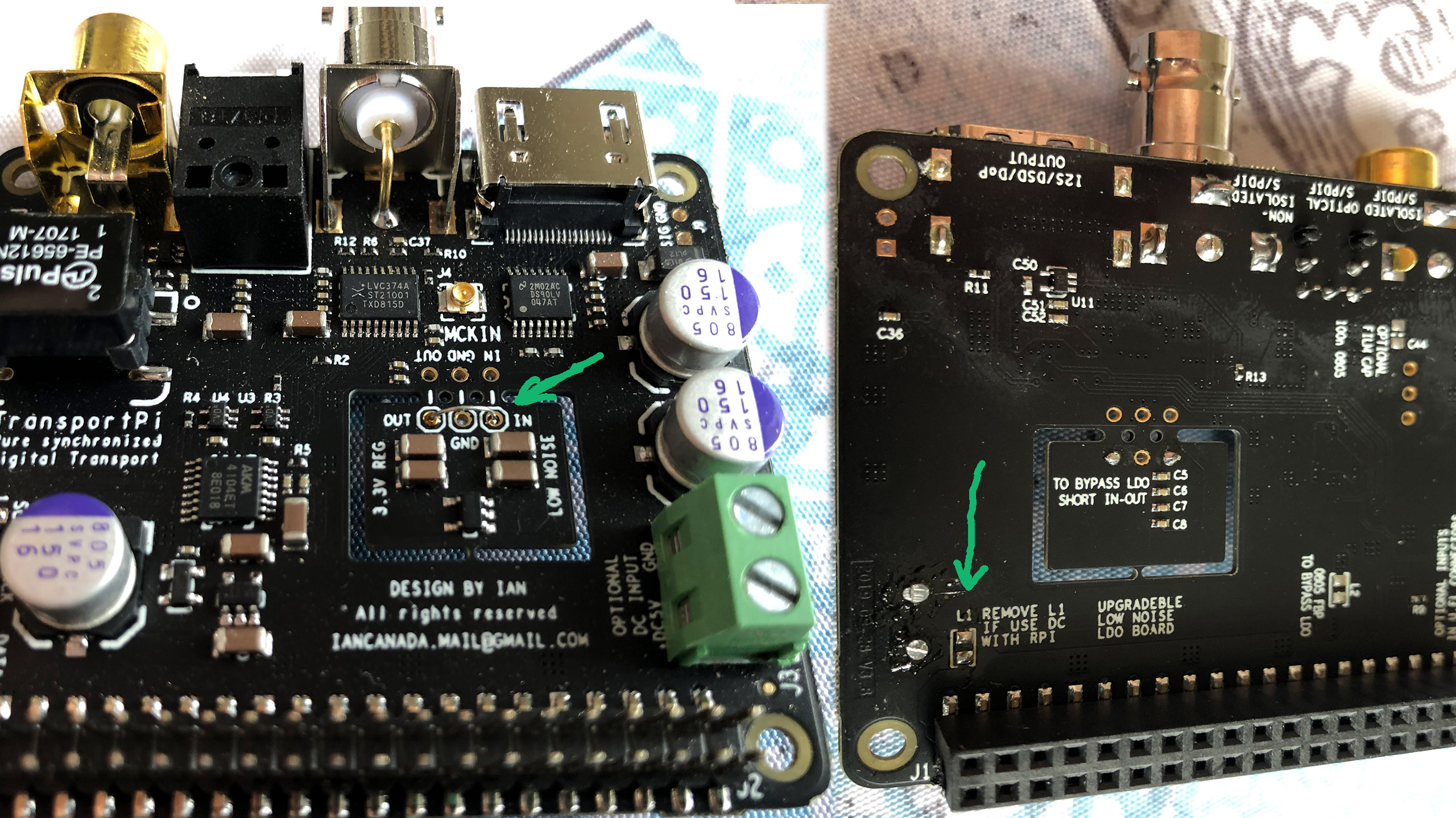

Don't forget to remove L1 from the TransportPi.

Is your scope grounded too?
It was grounded with a tip and barrel method, but you brought my attention to something.
I plugged the scope in the same outlet as the Dac eliminating all other connections more like a star grounding the noise dropped significantly to 2mv. bringing a separate ground from the same source to the hats negative poles dropped it down further to 1mv.
* But still should I let City ground connect to the hats negative poles?

Thanks for the heads up. I noticed this step in the manual but I could never locate "L1" on the PCB Layout (top) within the manual. I have not physically looked under the TransportPi yet (bottom).
Is "L1" basically that small board in the middle of the TransportPi with the labels "3.3V REG" and "LOW NOISE"?
If so, do I just solder a wire to "IN" on one end and "OUT" on the other end?
EDIT: I noticed in your photo the wiring on the TransportPi. Is this the step to remove "L1"?

If you want to use an independent DC power supply for TransportPi, you will need:
- Solder the supplied DC terminal connector to the position of J3.
- Remove FB L1 at bottom side of PCB if you don’t want this power supply connected to GPIO anymore.
- Feed good 5V linear/ultra capacitor voltage rail or 3.3V LifePO4/ultra capacitor rail to J3.
- If 3.3V pure LifePO4 or ultra capacitor voltage is used, it’s highly recommended to bypass the on-board low
noise LDO by soldering jumper wires between IN and OUT as described above.

I have a transportPI that I swapped with HdmiPI as I did not want the unneeded extra circuitry so I was able to take a nice photo L1 is on the back close to the input voltage
Thank you for taking the time to take a photo.
I always wondered where the "L1" was located...

Look at b and d.
I would suggest to make it optional. IME it can help, hurt, or make no difference. Have to try it under the conditions where the equipment will be used to see.

d. seems pretty straightforward. just need to solder a single jumper wire on two ends.
b. unsure how to remove. can I just pull out the metal piece off of L1? do I need to de-solder?
Note: I cannot proceed ATM because I need to purchase a second TransportPi. My current TransportPi is in production un-modified, so I don't want to touch since STABLE. But this will really be beneficial once I get the second TransportPi.
L1 must of course be desoldered.
