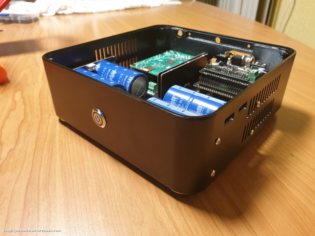

Nice. Thanks for sharing. I also plan on using cases also for my portable and desktop builds.
I hope to add an OLED screen in the next few weeks for the portable. Unsure if I'm adding a OLED, AMOLED or soon to be released 2021 iPad Mini for the desktop case.

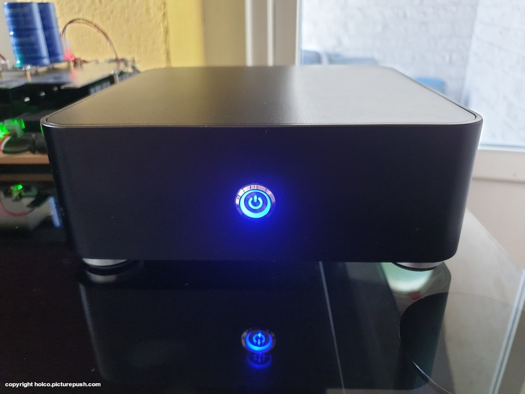

The power button cannot be underestimated. Either can a IR remote. Loving the power button on your video. I have one on the portable, but wasn't sure if it's possible on the desktop. Now it's a must have.
Hoping to start on MKIII/StationPi in about three weeks.

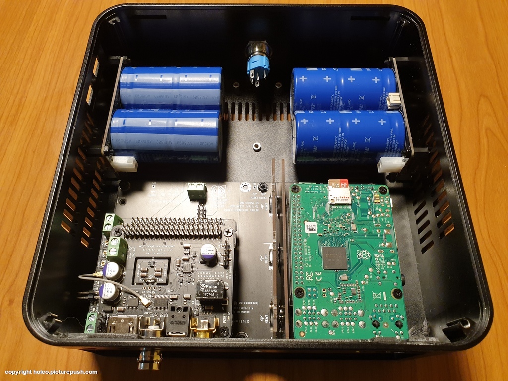

I received two cases. Immediately ruled out one as it's too large for application. The smaller case works out almost perfect, but a single 18650 or 26650 battery holder is too large. Even a 18650 with tab does not fit. Amazingly, I think a 26650 with tab is going to workout.
So I should get the best of both worlds now. Smallest footprint possible along with a 26650 battery @ 3x the power of the 18650 battery.
I don't know if the 'tab' idea would of hit me after just designing the layout. I would hate to resort back to the 1st prototype although it would be okay. Just fortunate to know the 'tab' option before designing layout.
1st prototype - 18650 battery holder and BMS on outside of case.
2nd prototype - 26650 battery with tab and BMS on inside of case.
Both prototypes similar size.

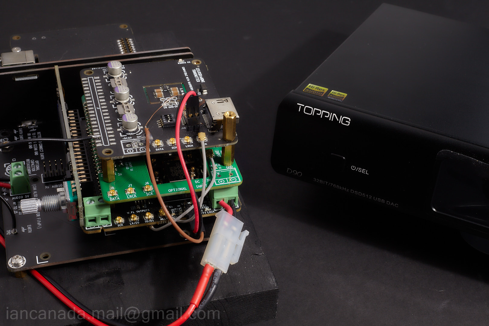

Fix Topping D90(D70) HDMI I2S/DSD popping sound problem by HdmiPi MkII

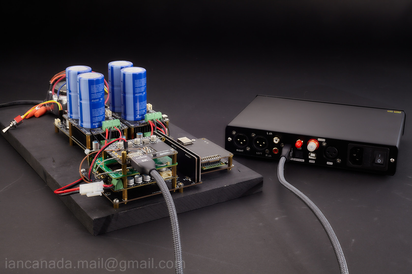

Topping D90 is the lowest price AK4499 flagship DAC. For evaluation, I bought one months ago . The sound quality is good for me. But still not as great as I expected.
Fortunately it has a HDMI I2S input, all significant sound quality related signals such as I2S/DSD and MCLK can be fed externally. That's a great potential.
Both PCM and DSD sound quality really got improved after I connected my FifoP Q3 digital transport to the Topping D90 through a HDMI cable. I'm really happy with the improvement. However, the biggest problem I've found is that it generates loud popping sounds in speakers when switching between PCM and DSD, or start/stop a DSD music. Topping D90 FW doesn't mute the DAC at those moments. That problem would be totally unacceptable.
After doing some research, I found Topping D90 has a MUTE input signal connected to the PIN16 of the HDMI signals. I believe I can fix this problem by making use of the MUTE output (isolated) from my FifoPi Q3.
So I made some modifications to my HdmiPi board. Please see the attached pictures for the details. After I connected both MUTE and DSDEN signal from FifoPiQ3 to the modified HdmiPi, the Topping D90 DSD popping sounds were gone. This problem was fixed perfectly! I can enjoy the improved AK4499 sound quality now. That's so great!
Some settings of Topping D90 DAC needs to be changed from default, otherwise the left/right channel will be reversed.
Hold the power button when you turn on the power switch to enter the setting mode,
1. Change setting 8 to REV
2. Change setting 9 to DSDR/DATA
The modification job is not that easy because the HDMI connector pins are very small. I'll implement this feature in my new HdmiPi MkII transmitter design very soon.
This feature may apply to Topping D70 and many other I2S/DSD DACs with HDMI input.
Stay safe and enjoy the weekend DIY at home.
Ian

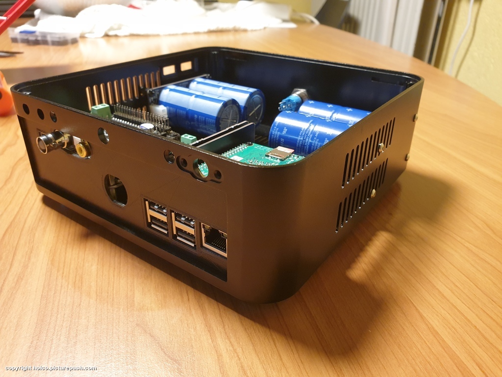

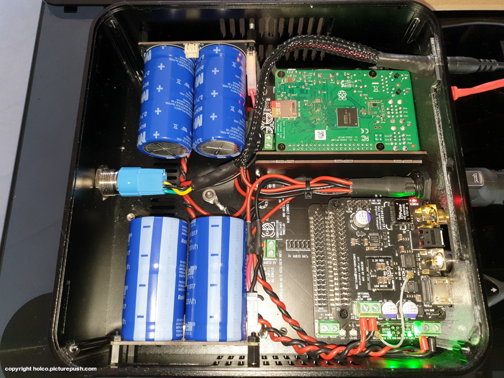

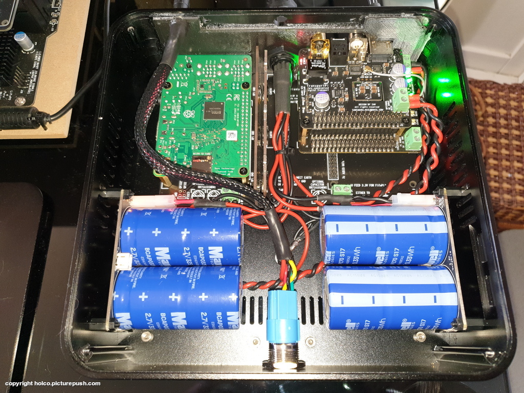

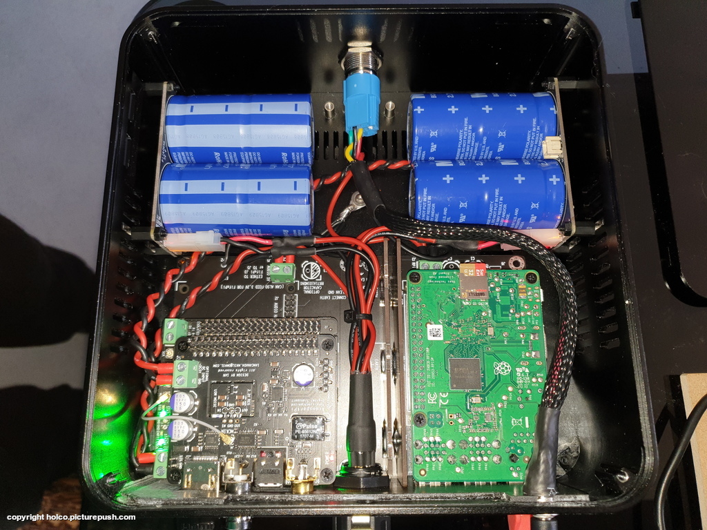

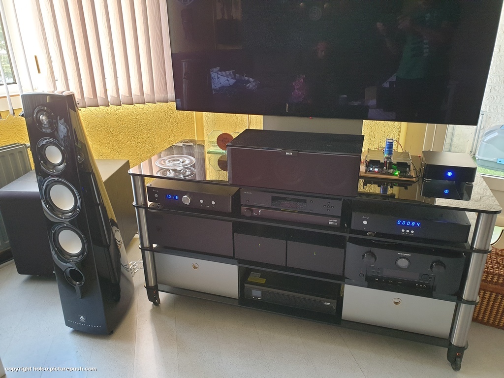

Some more pictures of the final result, also the grounding improved because I did not realize that the StationPi has 2 different earth screens (TP1 and TP2), 1 specifically for the RPi and 1 specifically for the right side where the FifoPi and the TransportPi house, the star earth point is now on one of the metal inserts that are pressed into the bottom as standard.
To create more space for the coax spdif output with some fine tuning regarding the dimensions, I also 3D printed a new back plate.
The power switch LED is a bit too strong so I have to come up with something about that.
The Raspian still sounds like a Swiss timepiece :worship: so as far as I'm concerned, this conversion is more than successful 🙂
