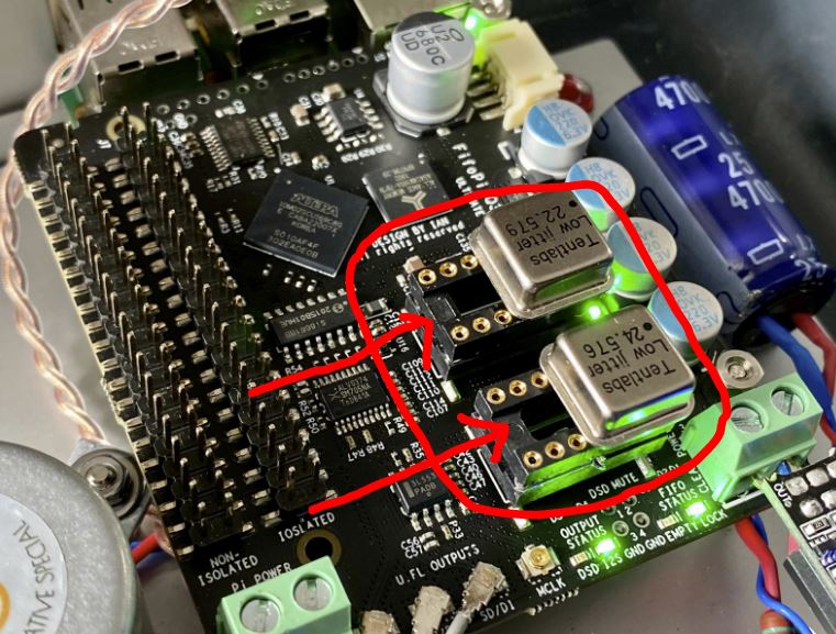

Dick from Audio creative (Link to their Site) tested the new Q3 with the DIP-8 size Tentlabs XO clocks and used a DIP socket in between which is a great and clever trick to overcome the fact Ian moved the middle pin away in the new version. Below the DIP Socket he soldered two wires from the clock to the outer pins.
This combination works sound wise great with the DDDAC1794 setup – so good to know for everyone liking the Tentlabs XO clocks or even having them lying around from other projects :cool:
That's a very smart solution, Thank you so much for sharing!
