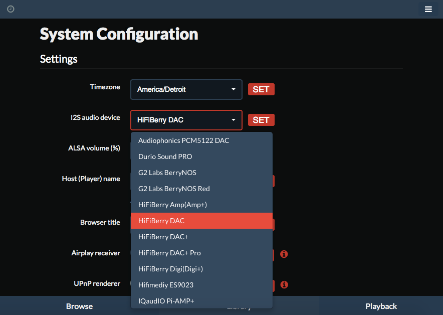

I don't have the FIFO yet but I got the RPi2 talking I2S to my old CS4303 board by using the Max2Play/Squeezeplug package. This allows you to change the config without having to use command line. And I'm just a lazy guy
I just selected one of the HifiBerry options as the output. It should work for any other I2S interface as well since it doesn't involve any dedicated driver software.
Since Max2Play also supports MPD, it might be a solution for the Volumio or Runeaudio (or other MPD based implementations) users out there who are not so experienced with Linux.

I'm Tim the dev for Moode Audio Player. If one of you would like to try FIFO II with Moode, just select Hifiberry DAC from the I2S dropdown menu and reboot.
If it works, I'll add FIFO II to the menu for next release of the Player. If there are issues contact me via tim at moodeaudio dot org and I'll be happy to help troubleshoot

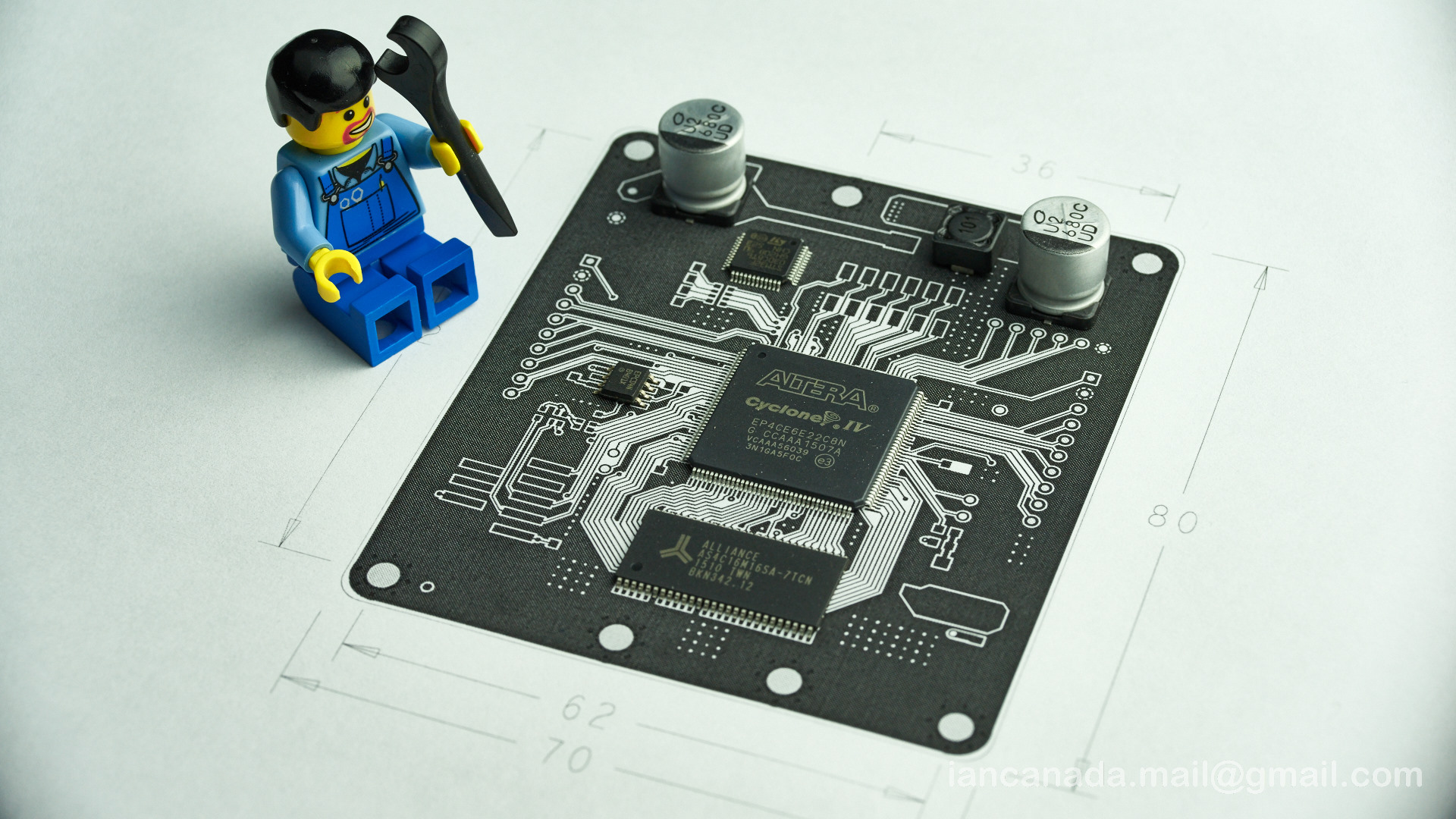

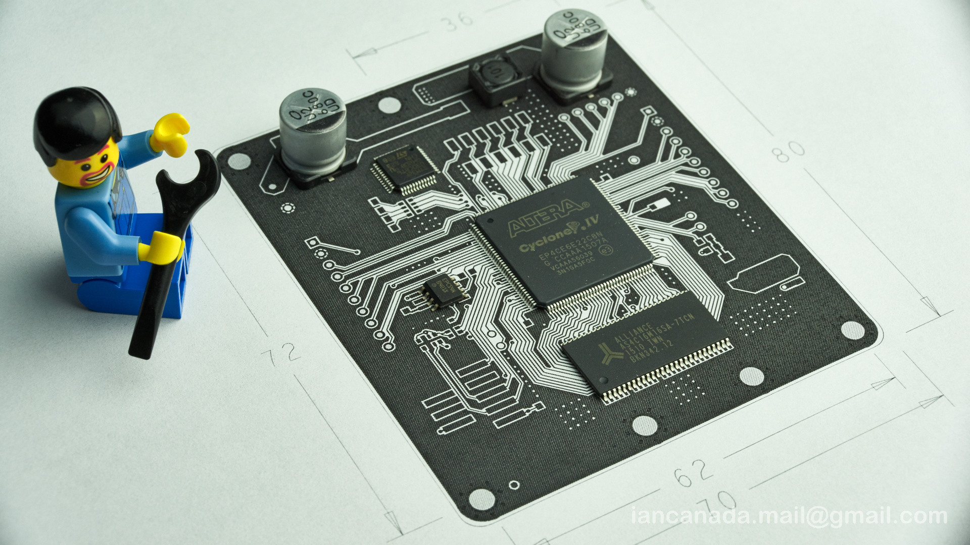

Ian multi-channel I2S/DSD FIFO KIT is under developing and coming soon

Basically, the multi-channel I2S/DSD FIFO KIT will have a Cyclone IV FPGA device, a 256Mb RAM, a 32-bit ARM Cortex processor and on-board isolators. To achieve even better sound quality, the new clock board will work in remote mode and can be placed very close to DAC (or be integrated as part of DAC). An optional control panel/TFT display will be designed as well. Run from iPhone of other mobile devices is also possible.
Please see the pictures for more details. Prototype PCB was done! FPGA design was done and fully tested. ARM software is under developing. See, I’m very close to finish!
New update will be posted very soon.

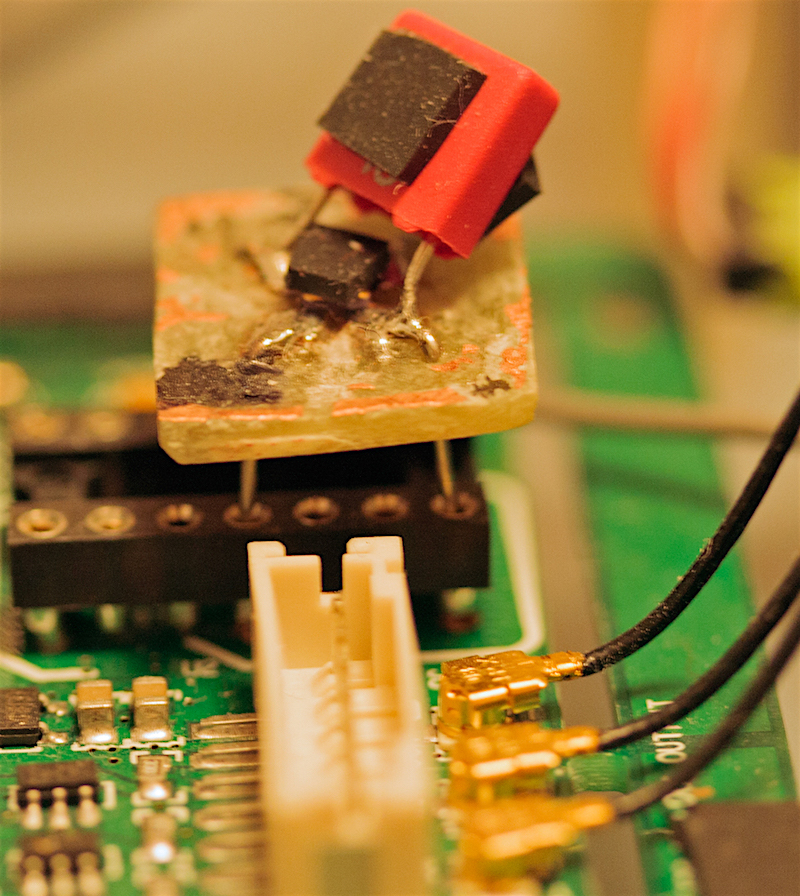

I have successfully used a NDK osc on an Ian clock board. I checked the original clock spec and compared it to the NDK pin for pin. Then designed a small board to accommodate it. It works.
Hi TNT, so you just used the NDK osc, with 10nF between pin 2 and 4 as described in the datasheet and connected this. Nothing else?I have successfully used a NDK osc on an Ian clock board. I checked the original clock spec and compared it to the NDK pin for pin. Then designed a small board to accommodate it. It works.
This is what I did, but didn't work. Since these oscs are sooo tiny, I just soldered one. The other still was the supported one. Could that be the issue?

Hi, [emoji3] thanks for the pic. Not pretty, but working. Not bad. So it should work here. I'll try the second.It isn't pretty but on the other hand, it's a test
Sound however was best yet. Only to be superseded by Andreas clock that I have on the backlog.
Sorry for the sorbothane damping pads...

Thank you! Just saw that I have used 100nF instead of 10nF. This might be the reason for not working. Unfortunately I don't have 10 nF . So I have to wait [emoji20]. Thanks for your help. Good luck to you! ErnstThe soldering is a challenge. How to check continuity to "legs"? How nit to heat fry it?
