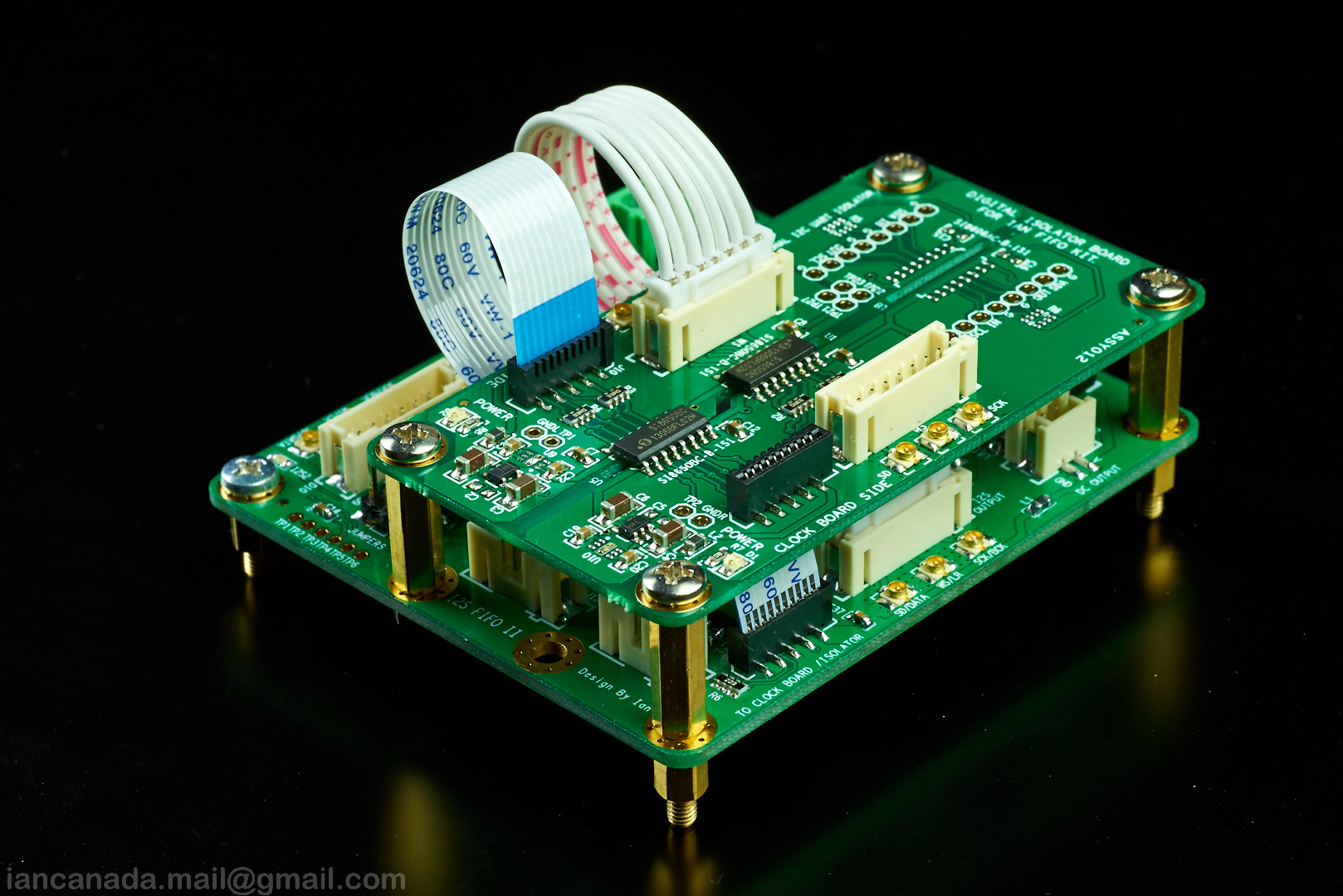

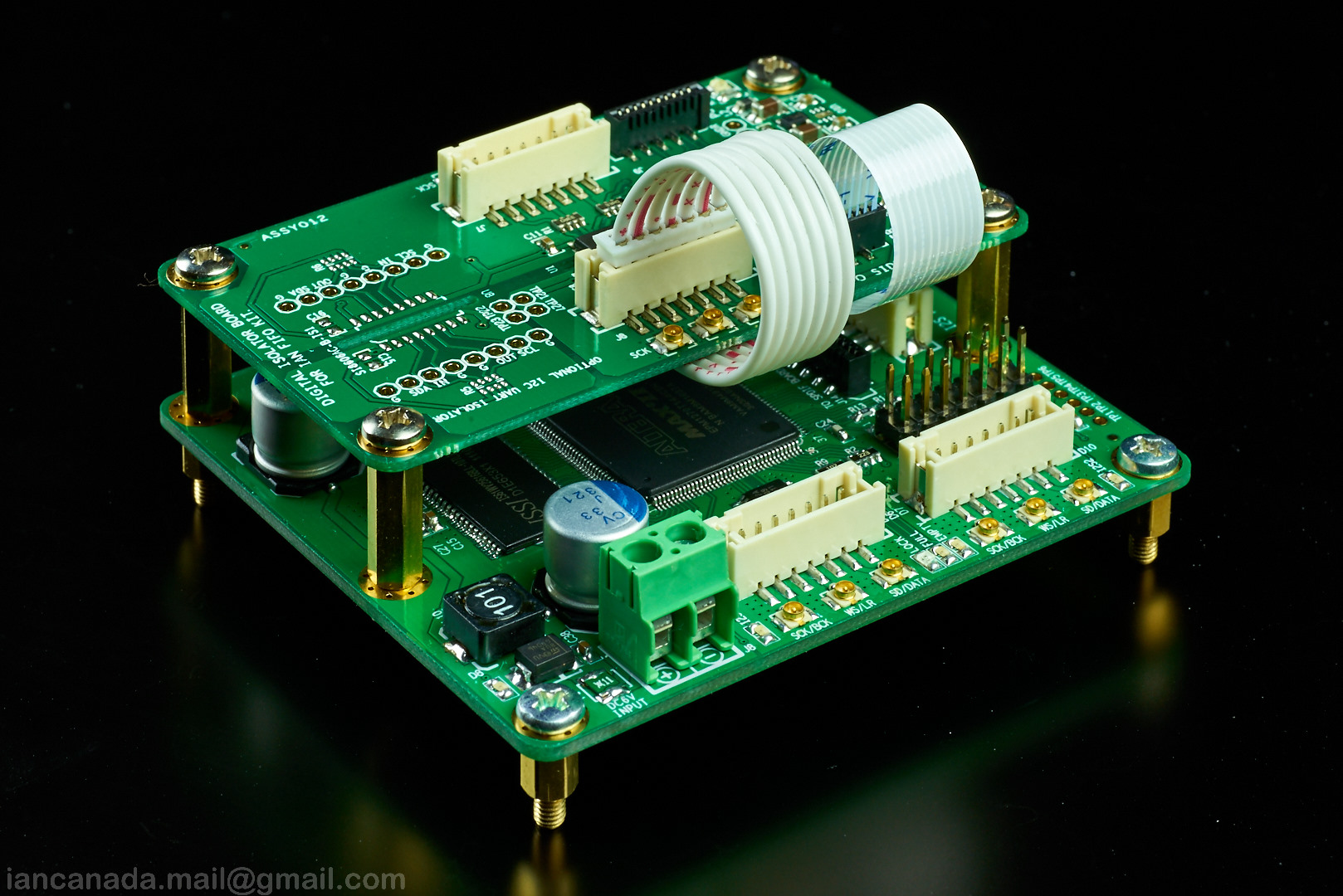

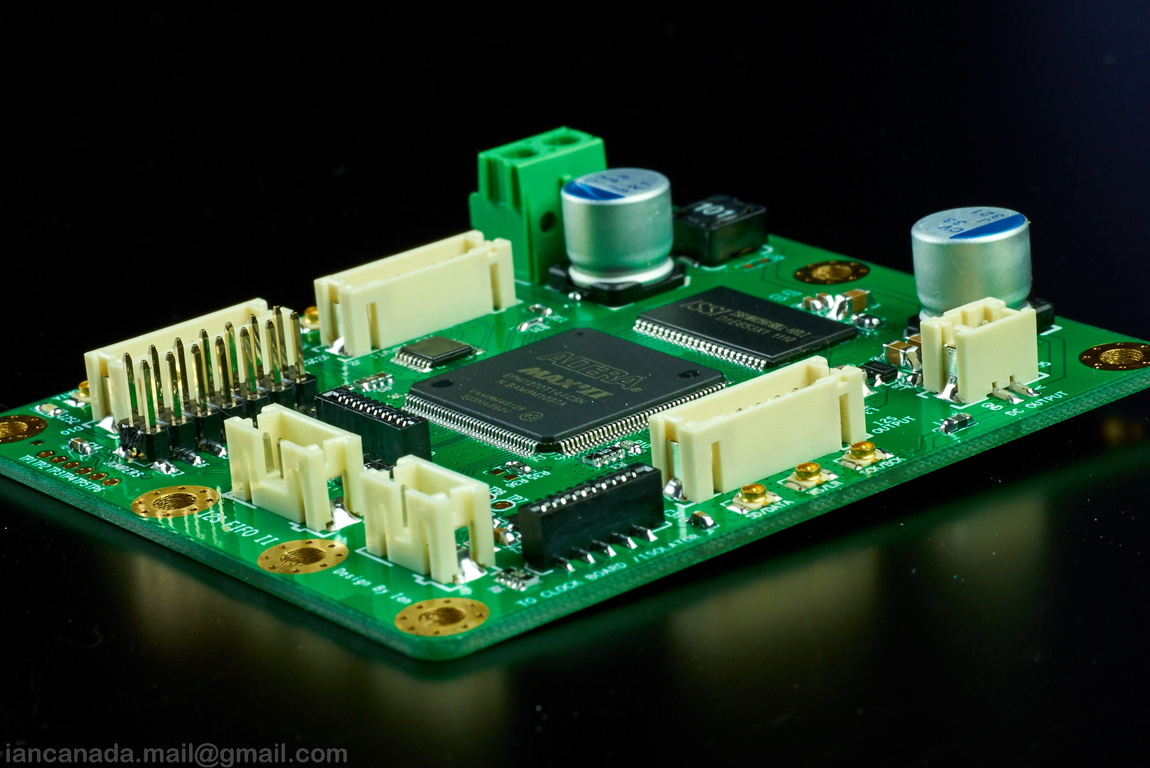

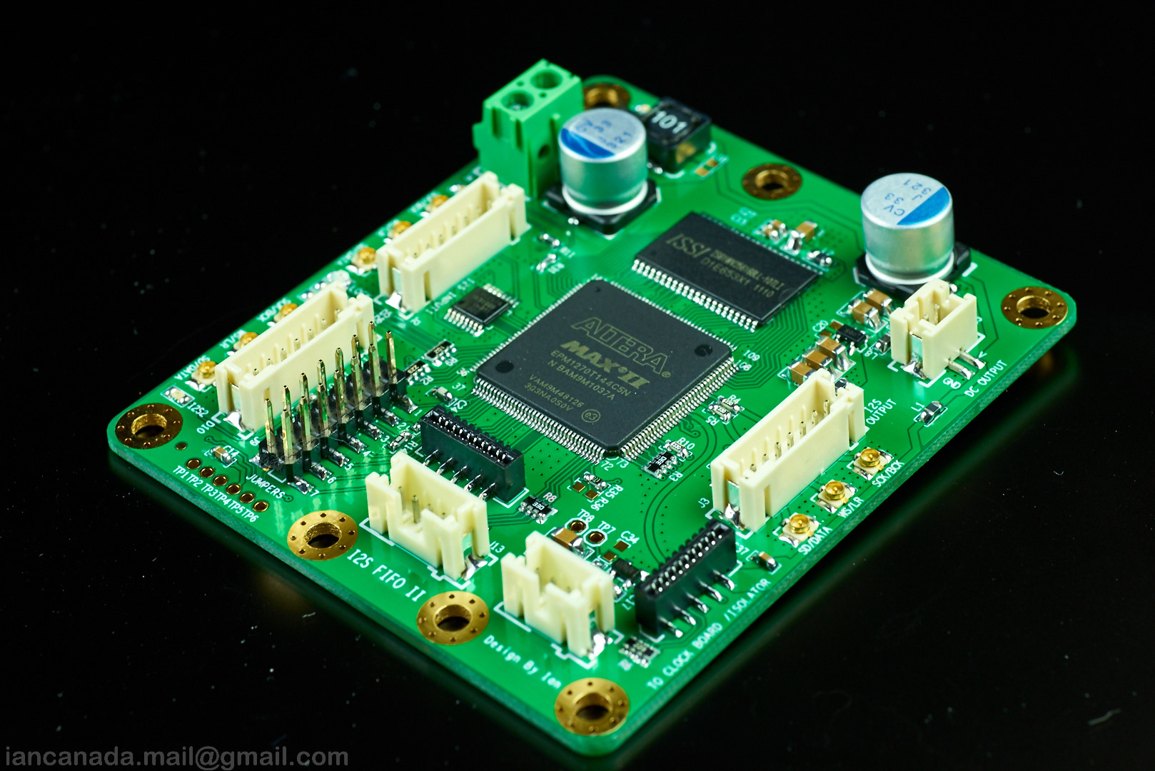

New Ian I2S FIFO II (1)
New I2S FIFO II design and prototype testing were finished. Production order was placed last week. Hopefully I can receive all them by the end of next week. I’m trying to make them available for the next GB as soon as possible.
Addition to FIFO I, it has two I2S input ports. Both of them are rated up to 384KHz, they are 3.3V logic but tolerant to 5V logic. Back door is no longer needed for another I2S source, such as an USB interface. A jumper or a toggle switch can be used to change between I2S inputs.
Glitch free function was designed into the internal switching logic. When a new I2S source is switched to, FIFO output will keep working without any stop but data signal will be 0 until new I2S signal is locked.
Each I2S input connector has a LED to indicate the working port. Both switch and LEDs can be accessed from jumper connector, so it is possible to connect them to a front panel.

Raspberry Pi Question
Ian, those boards look really great.
Would it be appropriate to use the I2S FIFO II and the Dual XO II together with a Raspberry Pi 2 and a suitable DAC to create a networked audio player? Is there anything else that should be considered, such as an isolator?
It seems that this may be a good combination to allow the use of different DAC boards and to enjoy audio fun.
Thanks BryceJ,
Yes, FIFO II can work with Pi 2. Together with a carefully designed DAC, it can be a good player. An isolator is a good choice to cut PC/MCU ground for an audiophile system.

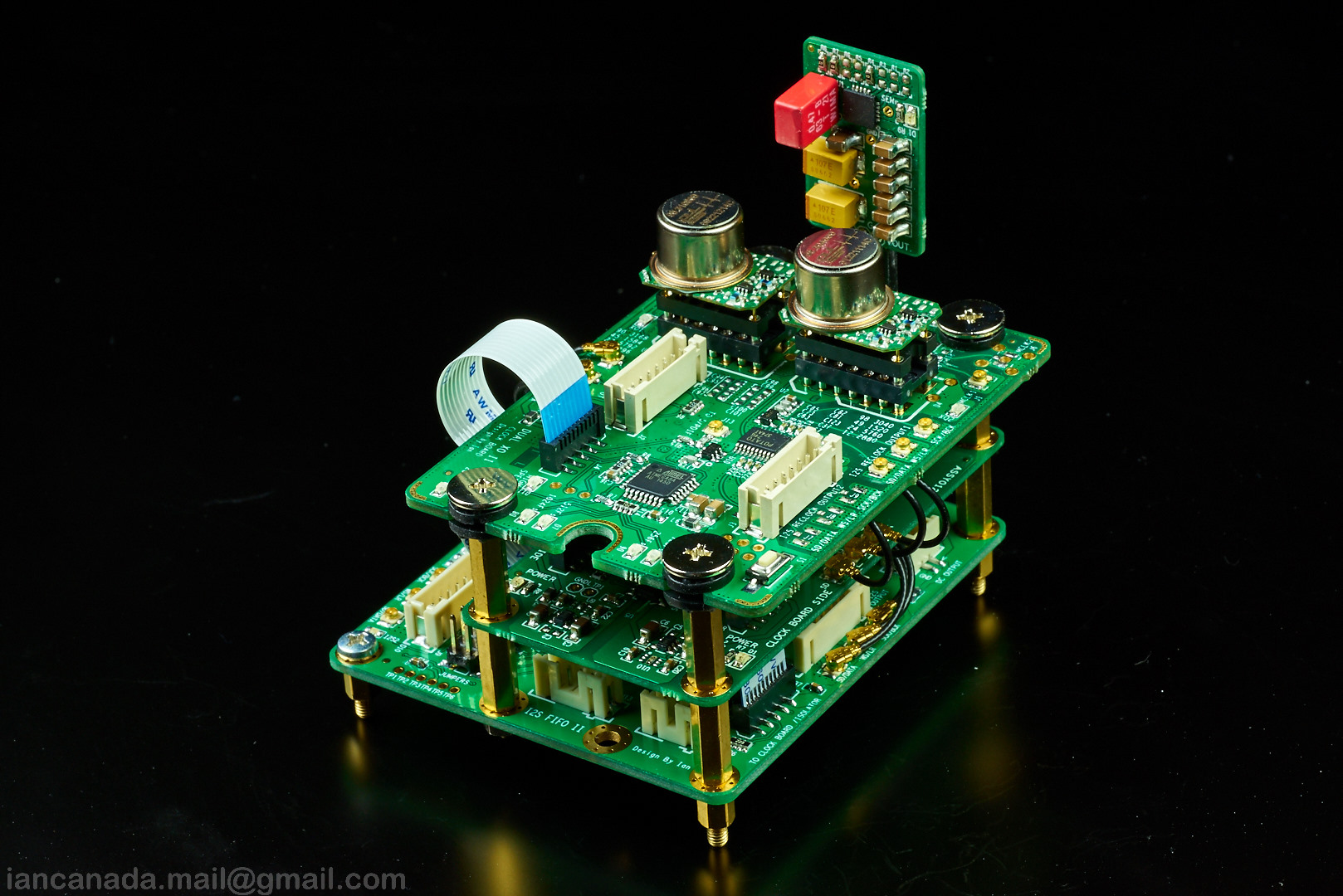

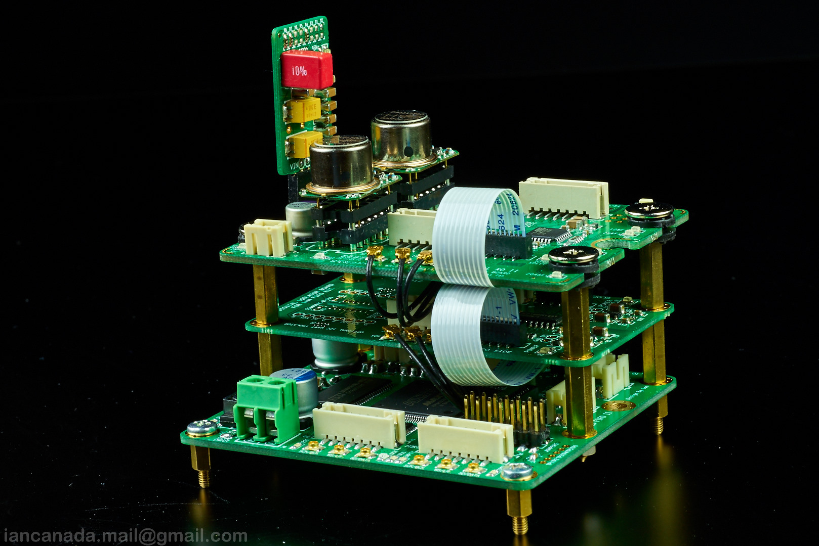

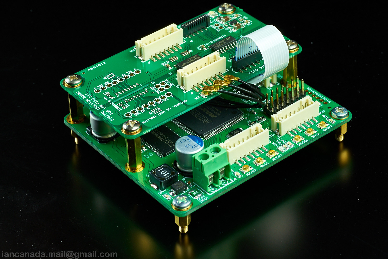

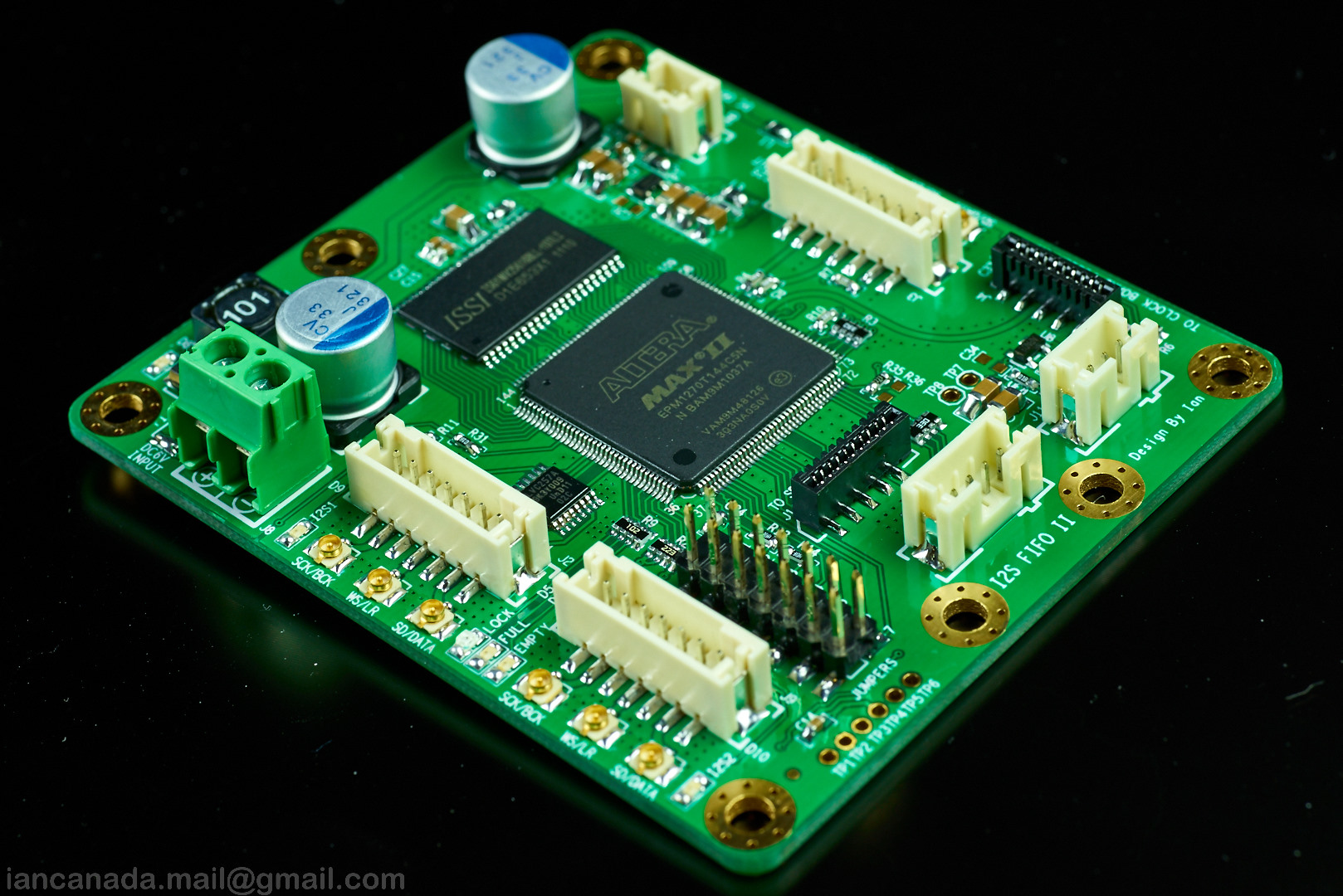

New Ian I2S FIFO II (2)
Dimensions and mounting hole positions are fully compatible with previous FIFO I. To save DAC space and get better integration, more mounting holes were added to make it possible to stack isolator board and clock board on top of it. But it’s quite flexible according to your project. I2S input connectors, power connectors and jumpers of FIFO II can still be accessed from the edge in this case, since boards on top are smaller. The new anti-vibration grommet solution of Dual XO II also works very well for this configuration.
Both 7pin PH2.0mm cables and u.fl cables can be use to connect I2S signals before clock board without affecting sound quality. For 384KHz stream, u.fl cables could be slightly better on signal integrity. However, u.fl cables are highly recommended for any signal after clock board.
