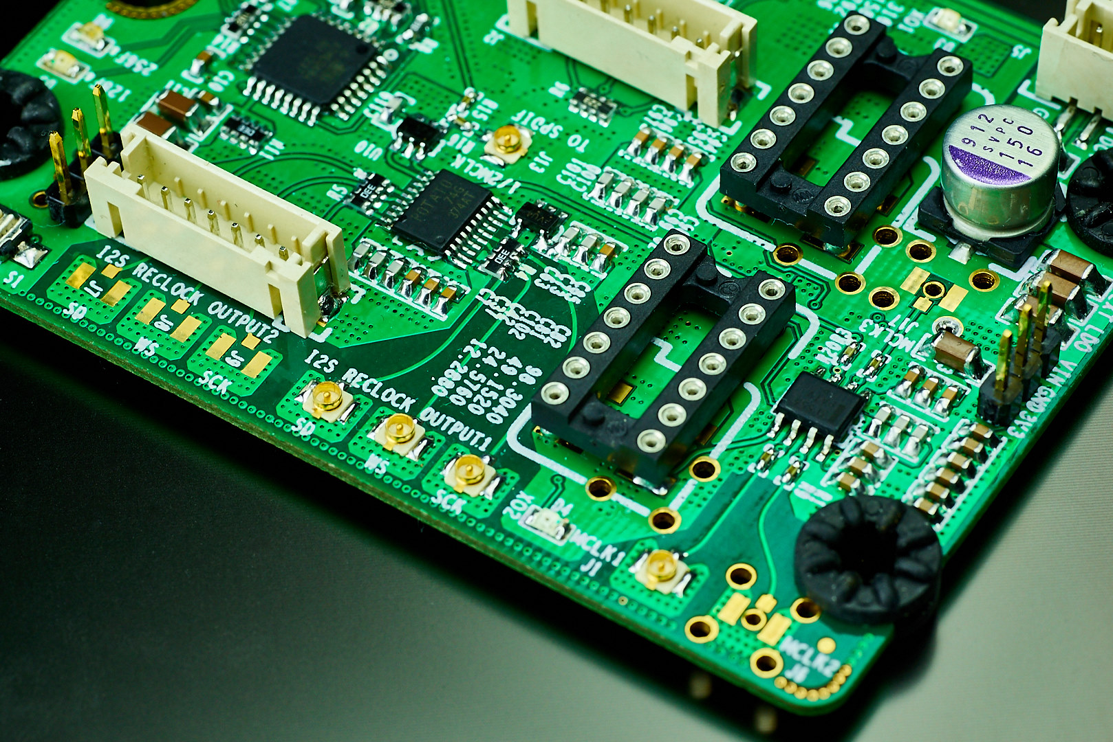

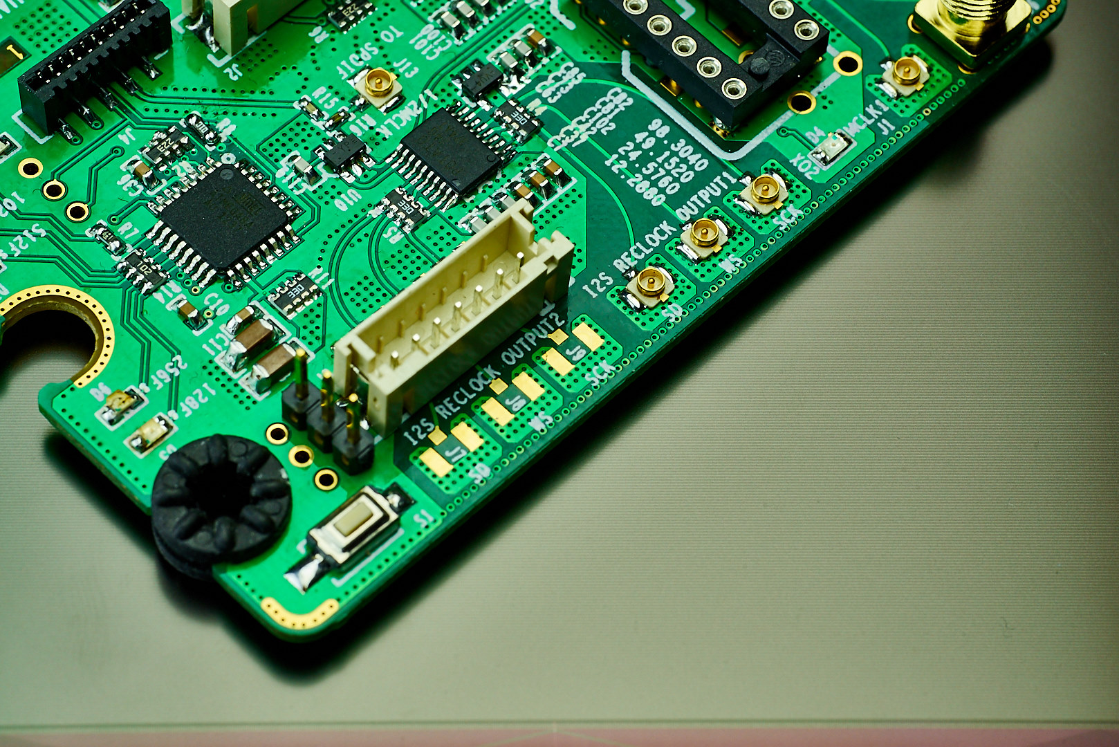

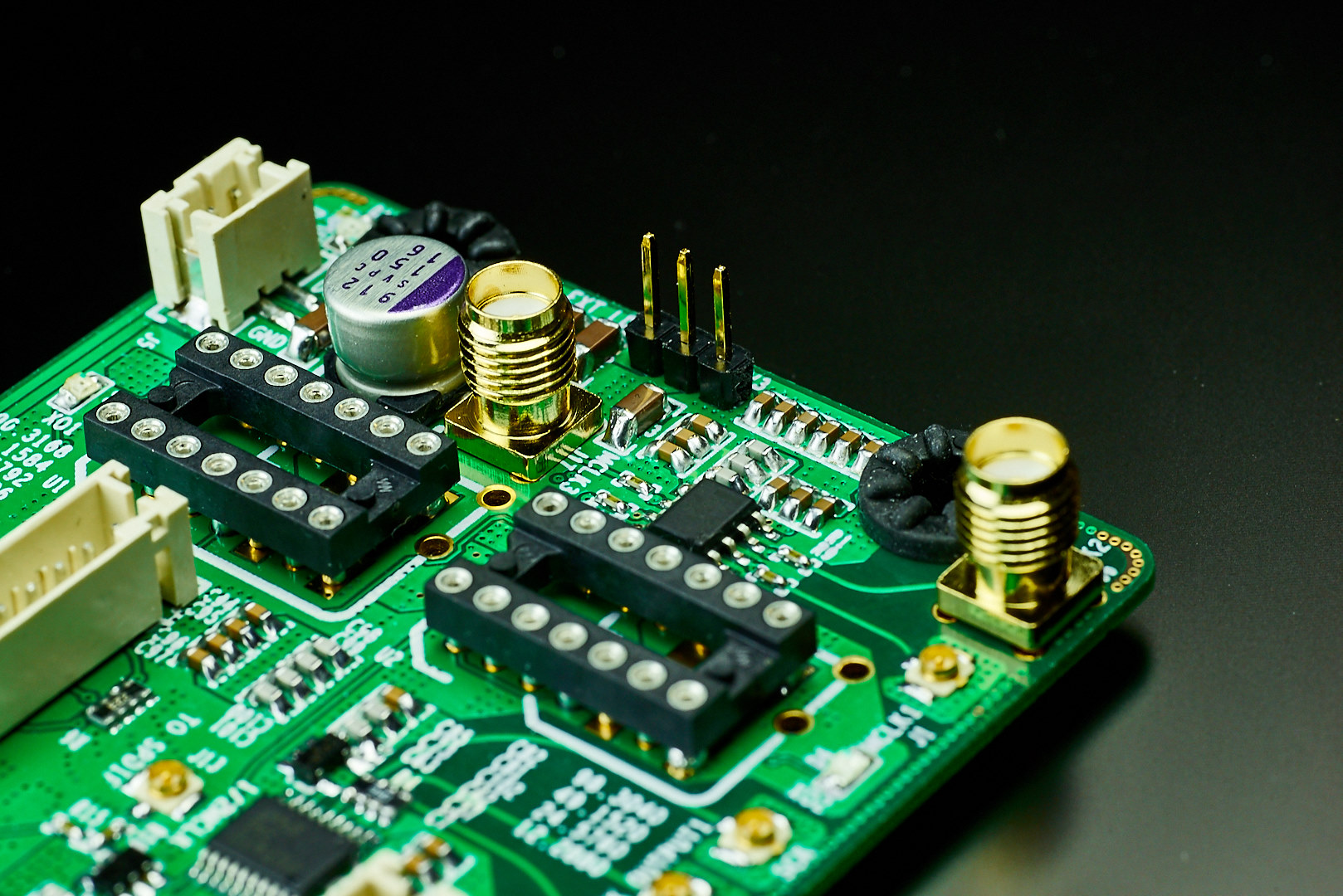

Different from previous version, Dual XO II natively supports DACs in dual mono configuration. It has three MCLK outputs and two groups of I2S. Signals to both left and right DAC functionally are equal, but independent from each other. Reflections from one DAC will not affect the other one.
All of three MCLK outputs are compatible with u.fl socket. But two of them have reserved SMA connector footprints. Just in case more reliable and higher quality SMA coaxial cables are used in some applications.
I2S output signals, one group is in u.fl socket, the other group in PH 2.0mm connector but with reserved u.fl footprints. You can use either of them for normal stereo DAC. You will only need both of groups for dual mono DACs. Please keep in mind using same length I2S cables in this case to ensure signals arrive at same moment.

New Dual XO II clock board prototype (5)
@Zoef

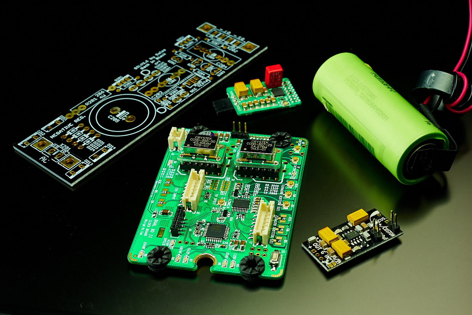

Just like my other recent designs, to get rid of the limitation, on board LDO was removed from Dual XO II clock board. Power supply is now open to LifePO4 batteries, external LDOs, shunt regulators, third party low noise regulators and other high performance power solutions. It’s really fun trying different PSU solutions to feel the change of sound and to pick up your favorite one.
If you want to use OCXO/s, please just make sure your power supply has enough current to run the oven/s.
The input voltage is now up to what power supply you are using. But if it is possible, pick up the lower voltage for safer.
Once you are happy with your power supply, solder it directly to the clock board would be suggested. It’s better than just using a connector.

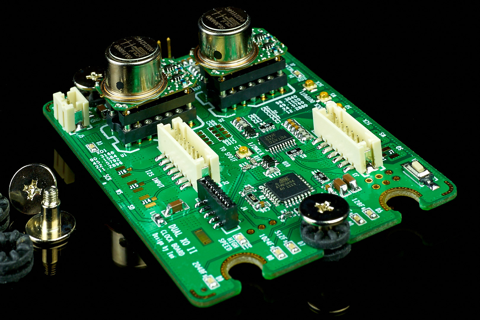

Hi Blitz,
Dual XO II was designed for those who are now on the waiting list. Actually I can just simply duplicate the old version without doing anything else. But I picked up the more difficult way, spending time and money to re-design/upgrade it to Dual XO II.
Just couldn’t help trying to design a perfect clock board for FIFO project, though I understand sometimes it’s really hard to achieve.
If you are happy with your Dual XO, then you don’t have to upgrade to version II, except you want to use 90/98 MHz XO, or you are running dual mono DAC, or you really care about the 2% (for me)improving on sound quality.

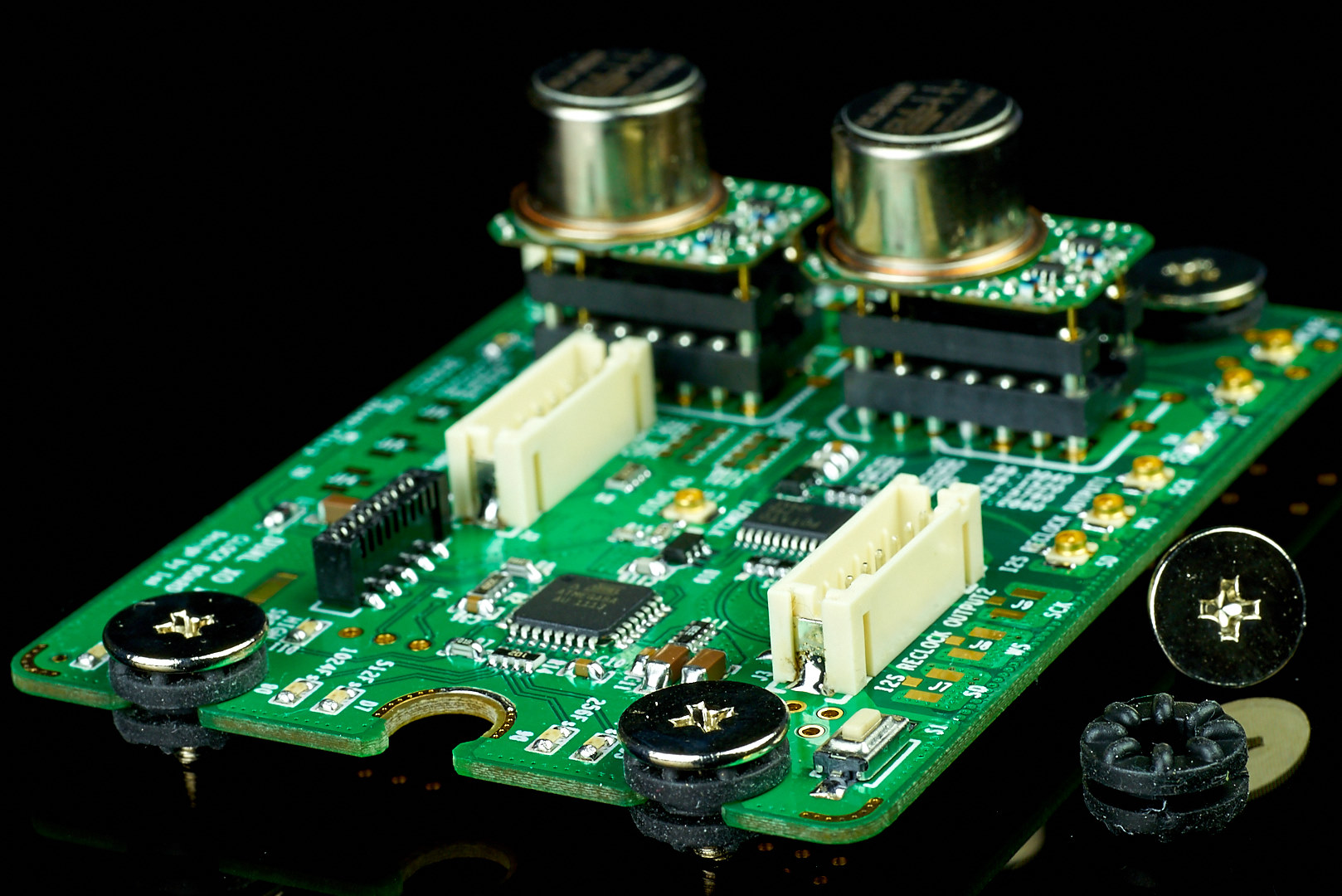

New Dual XO II clock board prototype (6)
XO is based on mechanical oscillation of crystal. Anti-vibration solution is always very important to a low jitter design, though the vibration frequency could be much lower than the XO.
Rather than previous rubber ring, a new anti-vibration solution is introduced into Dual XO II, which is anti-vibration grommet. Screws and fasteners are standard parts that can be easily sourced from Digikey or Mouser. They can also be picked up from used CDROM/DVDROM drivers. No longer need to struggle with finding out suitable and durable rubber rings.
New solution is compatible with Dual XO screw positions and can use both four points and three points support.
Ian
