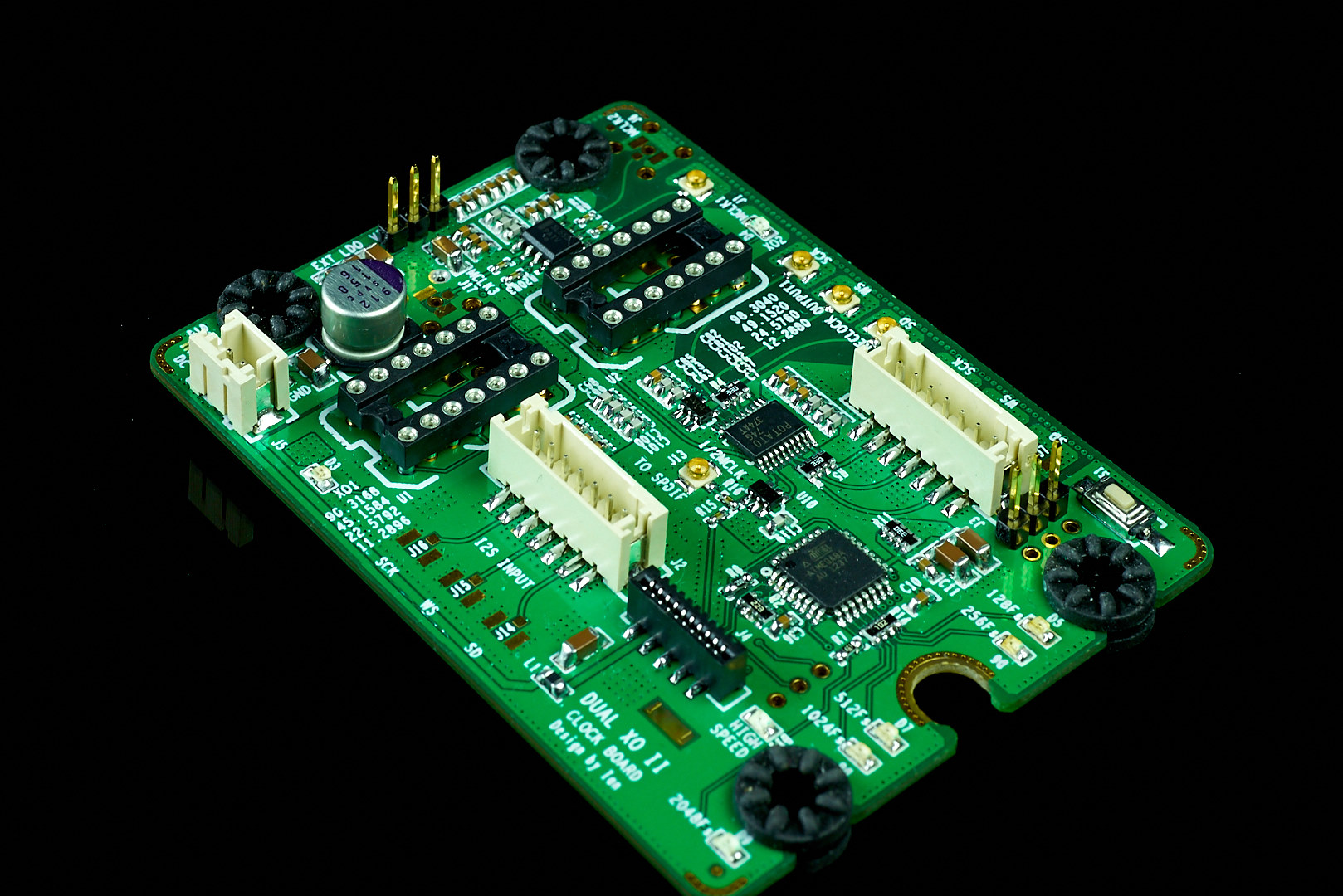

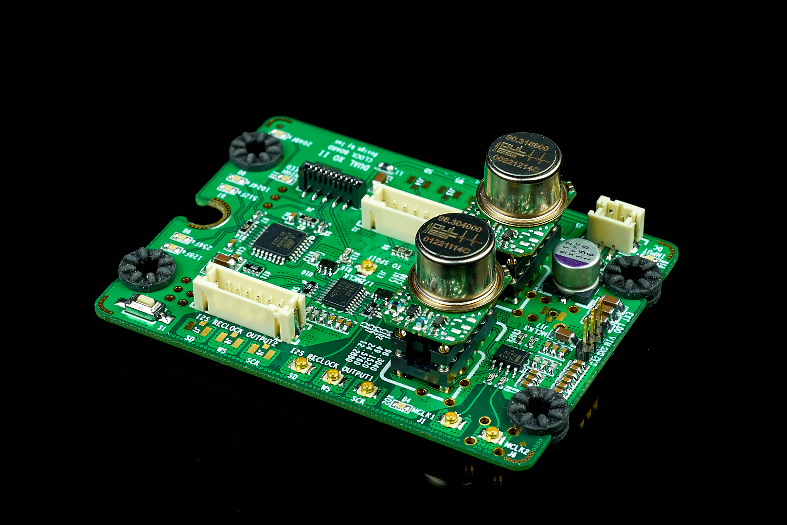

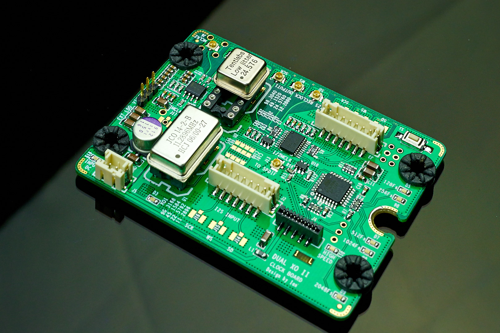

New Dual XO II clock board prototype (1)
It took me three evenings to assemble three Dual XO II prototypes :). Too many SMT components on both sides.
There are many improvements on new Dual XO II. I’ll list them one by one.
It’s the first clock board which can support XO frequencies from 11.2896 to 98.3040MHz, including OCXOs and external oscillators . So, with it, we can play with a large variety of XOs to have more fun.
Firmware was upgraded for more smart. Different frequency XOs can work together at same time. No jumper is needed any more for frequency selection. They can be recognized automatically.
Ian

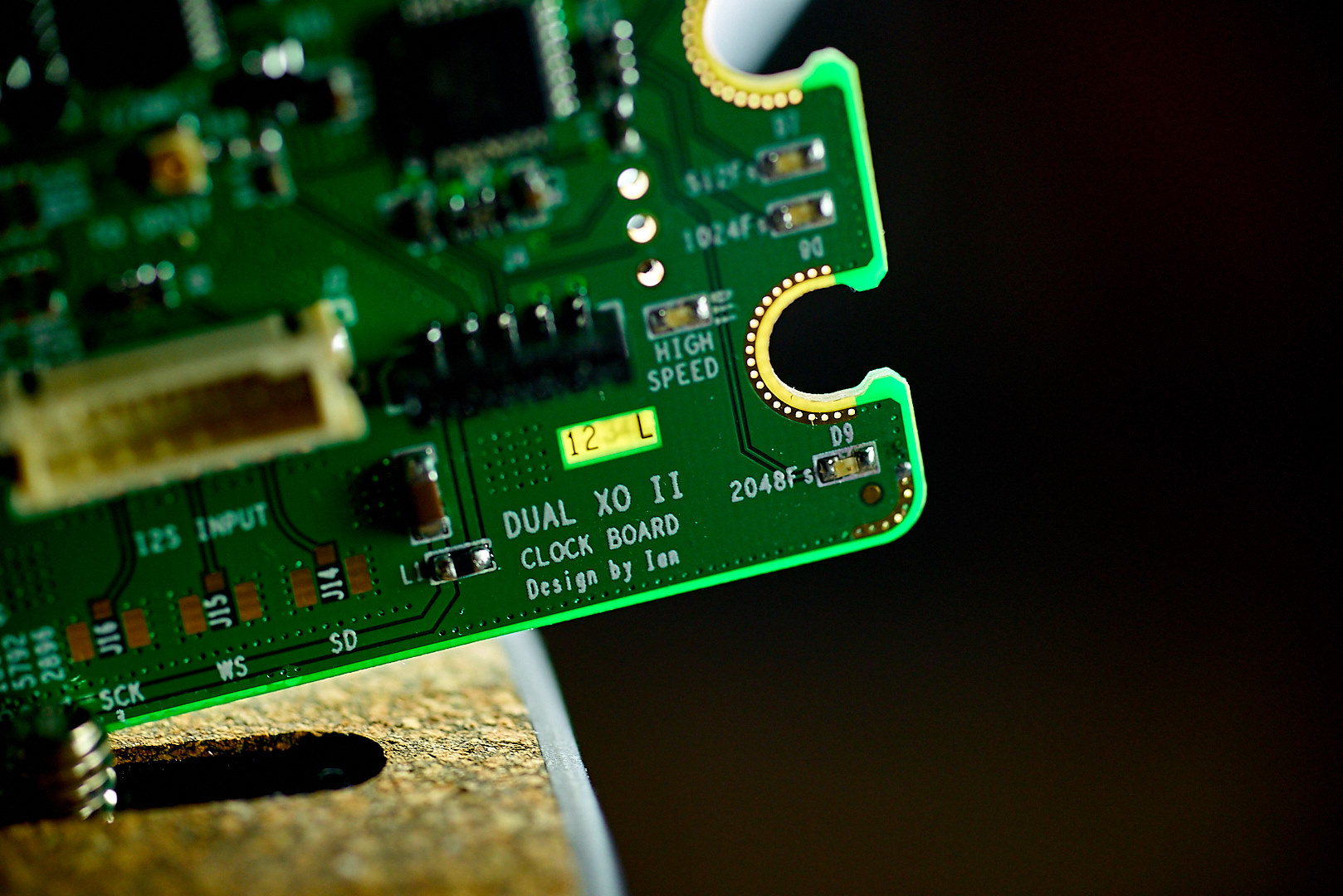

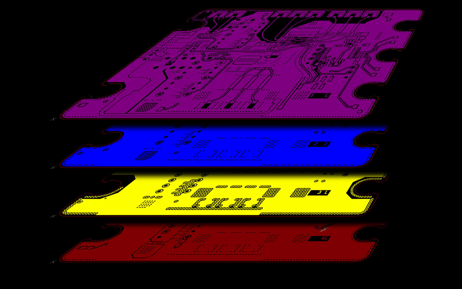

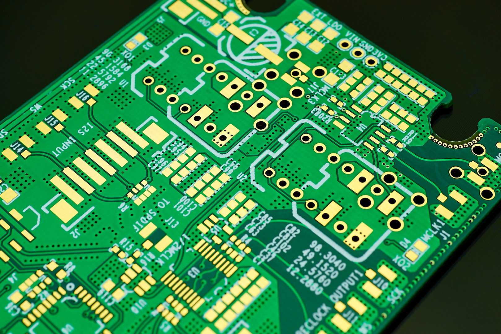

New Dual XO II clock board prototype (2)
To make it optimized to low jitter in such big frequency range, I have no choice but to use four layers PCB, though the cost can be increased a little bit.
SI performance will be much better than two layers, such as impedance control of high frequency signals, lower power supply noise, whole GND plate and many others.
Ian

Ian,super board and photos. I like also soldering very clean :worship:
Thanks clsidxxl,
After assemble all SMT components (before connectors), I just put the board into a small zip bag with some isopropyl alcohol for 5 minutes. The board will become very clean. And you just need very small amount of alcohol.... My another secret :D
Ian

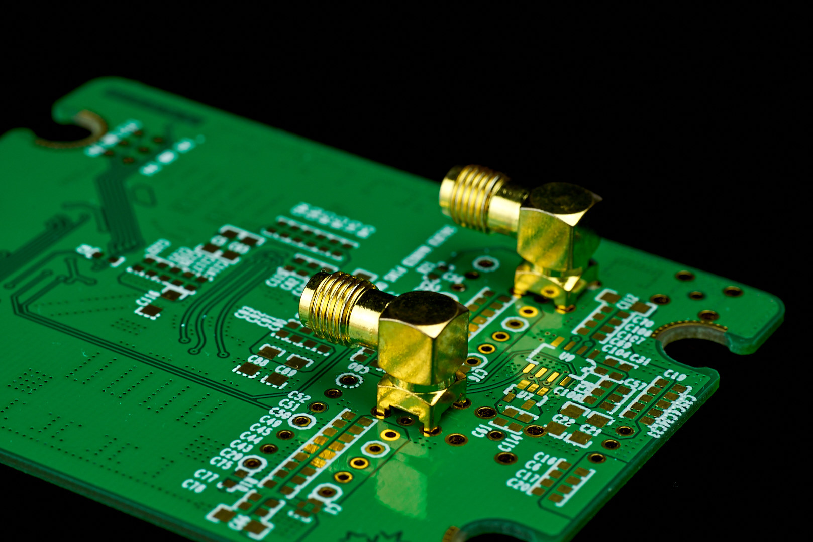

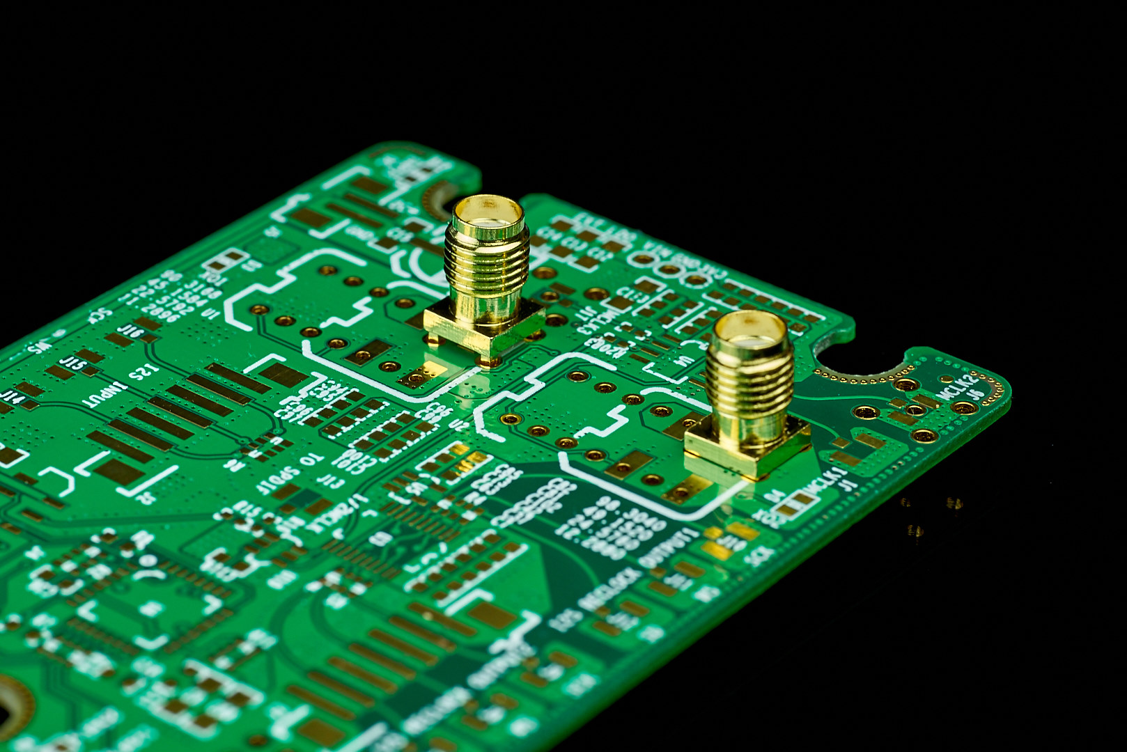

New Dual XO II clock board prototype (3)
Besides standard DIP XO sockets, two SMT XO footprints are reserved on the new Dual XO II clock board. So we can solder SMT XOs, such as CCHD957, CCHD950 or 5X7 and other sizes, directly onto the PCB to eliminate negative DIP pins.
Two SMA input connectors are also reserved to work with high quality external XOs. However, if you want to have both kinds of standard DIP socket and SMA connector to work with different XO solutions, you can assemble SMA connectors at back of the clock board. In this case, SMA connectors have to be soldered first. Right angle SMA connector would also be recommended to save space under the clock board.
You might already be noticed that all reserved XO connections are sharing same clock pin. It could be possible to place them separately at different position, but I jute don’t want to do anything which can probably degrade the quality of clock signals.
