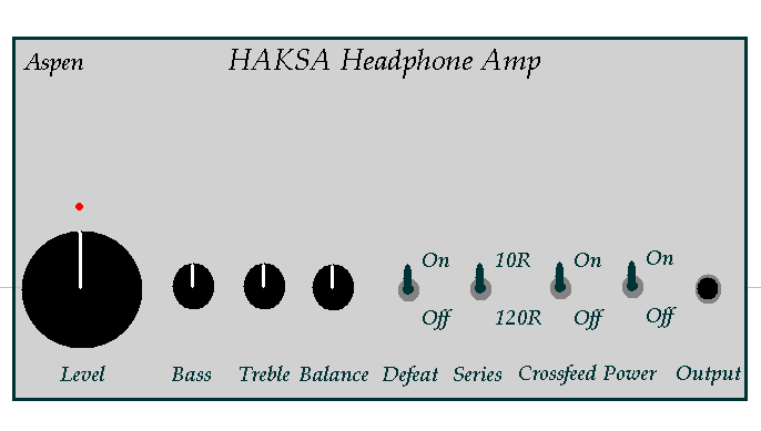

John Heisz - I want something from you. Get up out of the long grass and tell us what it will look like. I like wood as well around the outside. But think in terms of practicality so that any idiots can make it look really top-notch professional. Don't be tempted to use tools that they don't have.
Hello
Here is my face plate suggestion. I use a grey color to imitate an aluminium face plate. I made it for standard on-board switchs and pots and head-phone plug, for sure the size of the face plate need to be adjust since I do not know the size and position of the Pcb.
Since there was a balance control on the last Haksa schematic, I've include it in my face plate suggestion image.
The guy's can buy a pre-cut aluminium plate and use Letraset letters for all the writing on the face plate, so no need for special tools.
Or a group buy can be set to have it made from a case a company.
That's a first try, so any suggestion are welcome and anybody can modified that image for better results.
Bye
Gaetan
Bye
Gaetan
I would use a switched headphone jack and use it to power on or off the unit when the headphones are plugged in or unplugged. This encourages the user to put the phones away after use, instead of having them plugged in all the time. Exercises the contacts inside the connector and keeps the mechanism working and the contacts clean.
It also eliminated a front panel switch.
Crossfeed switch on the front but the lesser used 10/120 on the back panel. Volume control centre with switches and jack to the left and tone controls to the right.
Hello
Good suggestions, better to wait for mores suggestions from the guy's and Hugh before modifying the image.
For the volume control, I was finding more nice to put it on far left, I know that some Aksa amp did have it in center but they have only one button.
Thank
Bye
Gaetan
