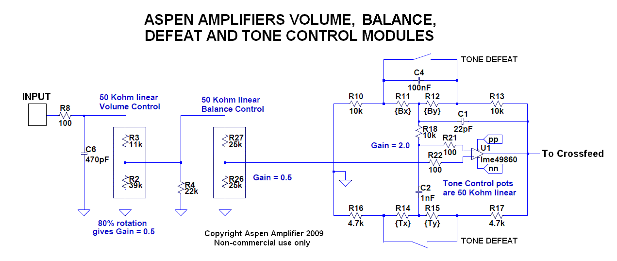

Folks,
Next instalment of the Headphone Amp, which I've sadly neglected the past week, my apologies. This incorporates the volume and balance controls, the Baxandall non-inverting tone control module with IC at the heart, and the tone defeat switches.
I'm indebted to Paul Bysouth, a clever Melburnian engineer whose input has been extremely helpful. Thanks Paul!
Next and last to address is crossfeed, which I will implement before the power amp rather than after.
Comment invited,
Hugh

Hello Hugh
I know that you are very buzy with the assembly of the Soraya 2009, so it's very normal that you have less time for the Haksa.
Nice tone control, good thing to ad the C2 local HF feedback.

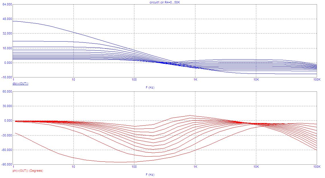

This is the response of the new schematic posted above but turning the pots in opposite direction. Sort of tilt I guess.
Not something I am used to, but maybe you guys have built and listened to it, it may be the next best thing since sliced bread.

I have looked again at the tone control section, and here are the results:
Output for 1V45p input (0dB) into 10K load:
Controls FLAT (midpoint on linear pots) Gain 6dB, -0.1dB points at 20Hz and 1MHz
BASS BOOST: +6.2dB at 50Hz (-31 degrees phase shift at 64Hz)
BASS CUT: -4dB at 50Hz (+21 degrees phase shift at 10Hz)
TREBLE BOOST: +5.9dB at 10KHz (+35 degrees phase shift at 10KHz)
TREBLE CUT: -4.1dB at 10KHz ( -15.5 degrees phase shift at 3.9KHz)
DEFEAT ENABLED 6dB gain with -1dB point at 12Hz
Phase shift +10 degrees at 40Hz and -0.15 degrees at 100KHz
This is not graphical, but measured straight off the simulation (LTSpice). There is not much boost and cut, certainly, but it is functioning as it should.
I had not intended to put in a tone control in the original circuit, but this is a good one though the effects are not pronounced. It is a non-inverting tone control too, which is an advantage. I will continue investigating.
Hugh

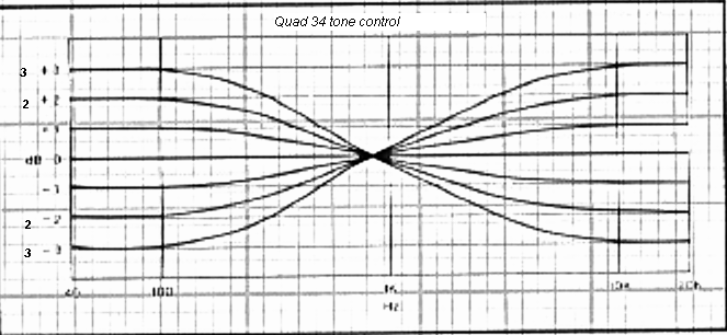

High Hugh, there is no problem at all with phase shift. There is not a filter in the world that does not produce phase shift. I have no real concern with the tone control, just that it modelled in a way that I was not accustomed too.
Quad did their tilt control and people loved it. If it sounds good then it must be good.
Peter Baxandal probably had the same response when he first introduced his bass and treble control.

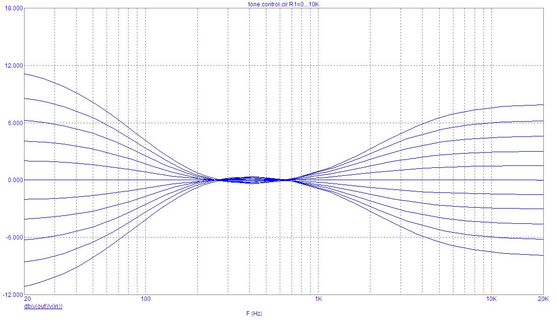

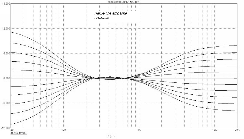

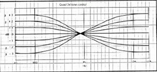

Hello
Looking at the Quad tilt control (the first image), it have only -3 and +3 db of cut and boost.
So the Haksa tone amp (the second image), do have more db of cut and boost.
The first look at the Haksa tone amp curves was a surprise for me but the Haksa tone do have quite enough db control for our usages.
And both Quad tilt and Haksa tone curves are more gradual than the Baxandal tone curve.
Bye
Gaetan

Thanks Gaetan!
Very nice graph, you did that in Tina?
When you gun for more cut/boost with the circuit used in the HAKSA, when controls are flat there are serious discrepancies in the FR. With the values chosen, there is no such effect, but cut/boost are limited, also by the non-inverting issue, which is not usual for a conventional Baxandall and I wanted to avoid. Without the small 22pF cap on the fb loop of the opamp, there is serious gain peaking, but with it, all is well.
Merci,
Hugh

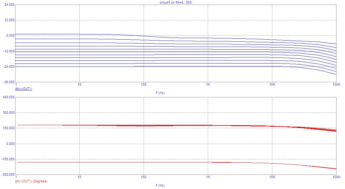

Geatan,
your HAWKS response curve is not representative of a tone control using a non-inverting gain stage.
Firstly the non-inverting gain stage gain ratios will not give you equal boost and cut, moreover as you adjust the pots you will also create an output offset as you imbalance the inverted input with respect to the non-inverted input.
Furthermore you have two separate phase responses one for the high pass which is incidentally is around -180 deg and the low pass which is around +180 deg.
Please post the circuit that gave you the HAKSA response because simple arithmetic does not agree with Tina the ballerina.
The reason for choosing an inverted gain stage in particular to get the boost and cut ratios symmetrical around zero, one can precede it with another inverted stage if for some reason one can hear that the music is inverted, which is a little doubtful.
Kind regards
Nico

Hello Nico
I have installed the Tina-TI simulator to replace my old Tina 4.15.
But the Tina-TI simulator are doing some free games, the FFT was very erronous lately, and now the response curve seem to have problems, so yesterday night I did post a question on the Tina forum. It's the second times that I need to uninstall and reinstall my Tina-Ti simulator.
Thank
Bye
Gaetan
