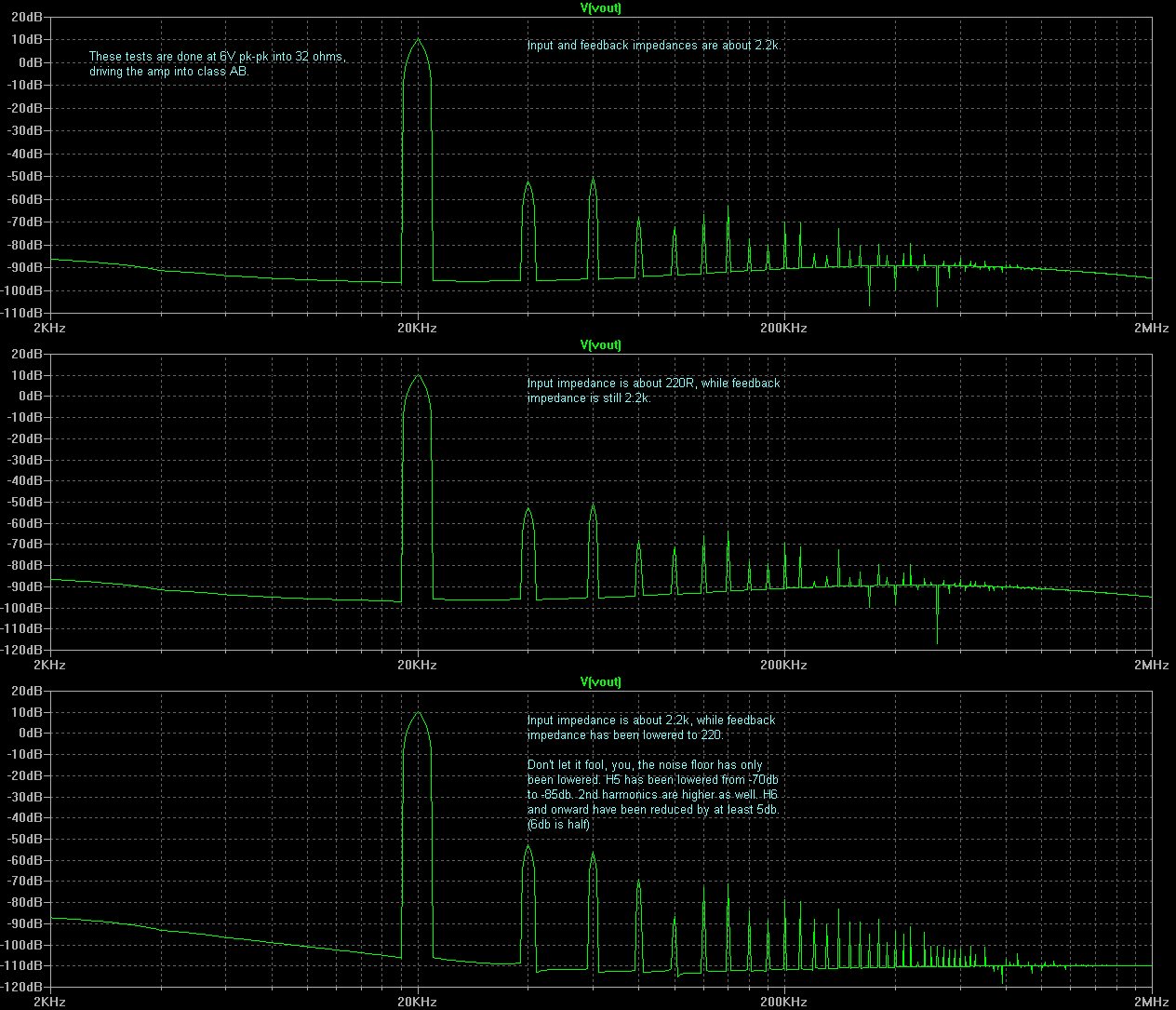

I'm working on it, Hugh.

I see. I'll have to try it one of these days to amuse myself. I've been fascinated with the idea of current feedback for some time. (maybe current feedback is desirable for electrostatics since they are principally capacitive, while loudspeakers are principally inductive. Although as you say, they have been designed for voltage drive)
Here is the result. I used 2.2k and 22k feedback and shunt resistors to provide a voltage gain of exactly 10, then modified as described by dividing these values by 10 (giving 220R and 2.2k for either input or feedback side).
- keantoken
- keantoken
Reading your post again maybe you missed my point.
My observation with amplifiers in voltage feedback mode is that distortion doesn't increase with voltage output, but with current output. As long as the output current is the same, distortion will be close to the same regardless of output voltage because current has more affect on linearity of the VAS and OPS than voltage does. Because volume is not entirely dependent on voltage, the amplifier will be putting more current through lower impedance headphones in order to produce the same volume. This means that the amplifier will produce higher distortion into low impedances than into high impedances. However if we use current feedback, the amplifier will output the same current for any given headphone, regardless of voltage, which will make the amp itself more consistent between headphones. I'm not suggesting that it would make the headphones themselves perform better.
I'm not suggesting we make a change, since as you said the mass majority of transducers are designed for voltage feedback. I just wanted to clarify.
And, I have to admit I made a mistake simulating the feedback network impedances. I didn't increase the phase lead cap accordingly when I lowered the feedback impedance, which is the reason the simulation is so optimistic. If I change the cap to its proper value, 50pF, there is only slight improvement.
So the increase in performance on the bottom graph is actually due to the phase lead cap being lower than it's proper value. Hugh, you said that having lowest possible lag compensation increases SQ, and these simulations reflect that. With 50pF being the "effectively same" amount after this mod, we can decrease it to say 33, 22, etc. whereas before trace capacitances were an issue and we would be using very low value caps. Is it reasonable to decrease the phase lead cap now providing we decrease feedback impedance as shown? I could tell you myself if I could get the loopgain simulation to work, but I can't.
- keantoken
