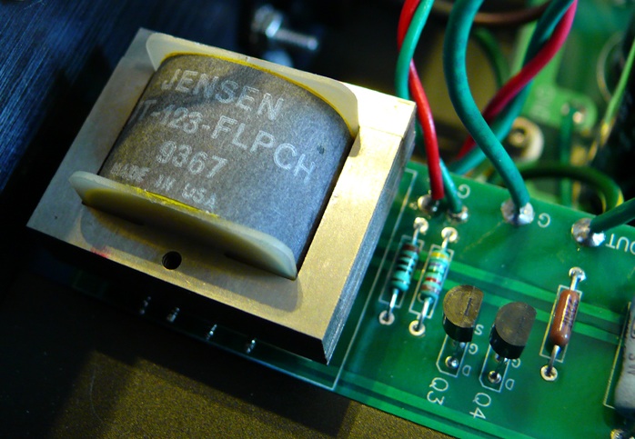

The JT-112-LCF (which is marked JT-112-L on the tape) will soon be known as the JT-123-FLCF as Jensen informs us they'll be renumbering it in the near future. It's just a matter of wire termination vs. PCB pins. I'm sure they will understand what is intended should anyone order the old part. For those building a PCB, the FLPCH is the applicable part.

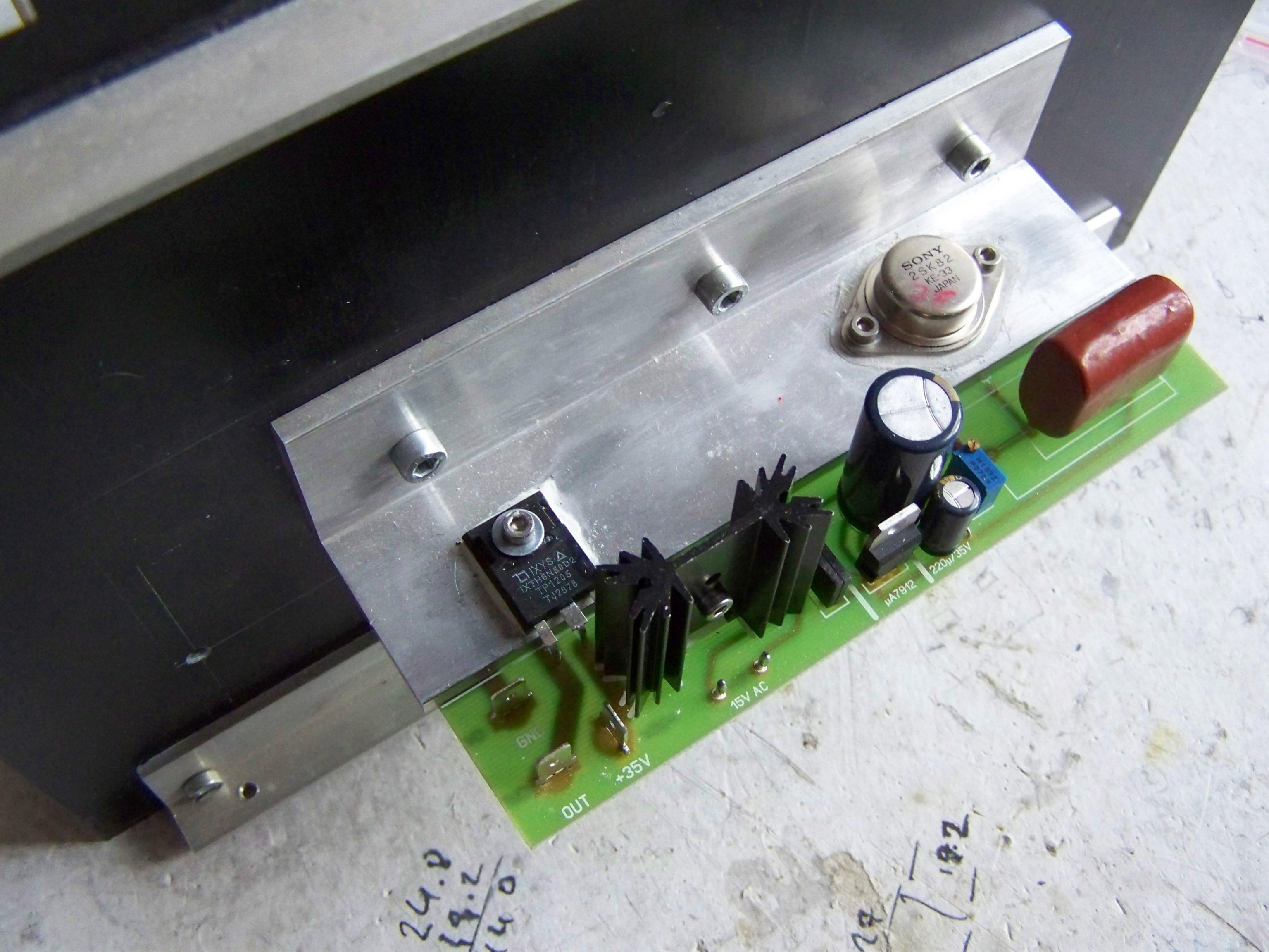

The IRF240 and IRF9240 (TO3) are hard to get, any suggestions? Just use an IRFP device? The TO3's will look nicer, I know....

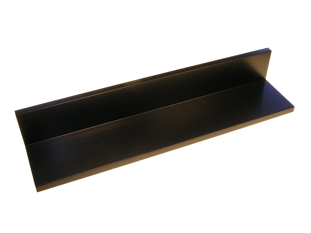

I can get L-profiles which are thick 5mm, Is that enough for a good heat transfer to the main sinks? Or should I look for thicker ones?

* The IRF240 and IRF9240 (TO3) are hard to get, any suggestions? Just use an IRFP device? The TO3's will look nicer, I know....
**I can get L-profiles which are thick 5mm, Is that enough for a good heat transfer to the main sinks? Or should I look for thicker ones?

*use IRFP
** 5mm is thick enough

There is no need for TO3 cases. You can easily use MOSFETs with plastic bodies.
