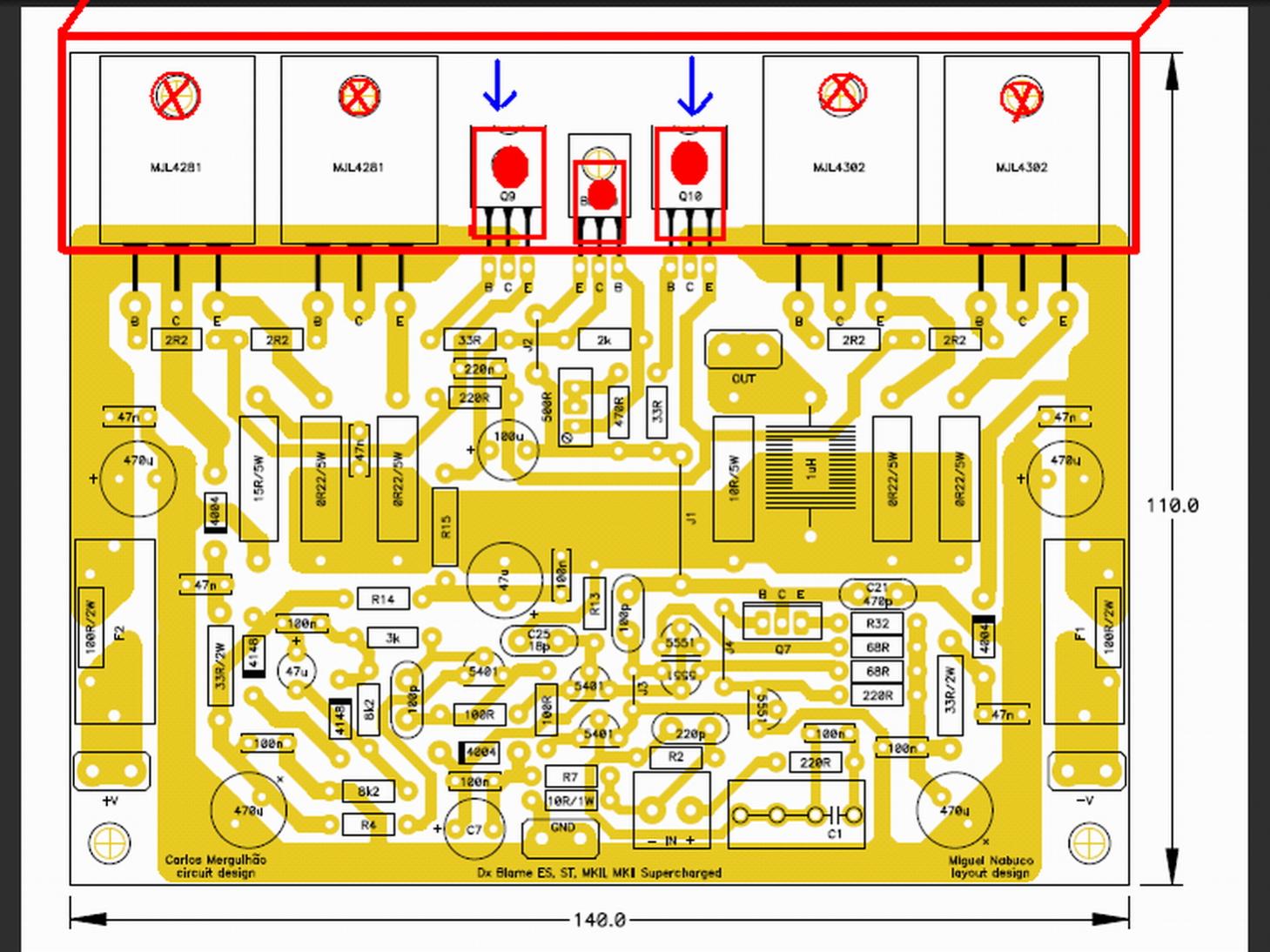

Any possibility of having the New PCB in pdf format? I am sure there is a lot of DX builders that want to make their own PCB's , like myself. Anyway I can not wait for the group buy. I want to start assembling as soon as possible.:D:D:D
Macd:):):)
Yes!...of course!.... i already told Mitchel to do that as soon as possible
He delayed because we were decidind about to lower the drivers and VBE limiter transistor.... we found that a short against the " L " adaptor was possible.
Soon you gonna have it dear Macd.
regards,
Carlos
