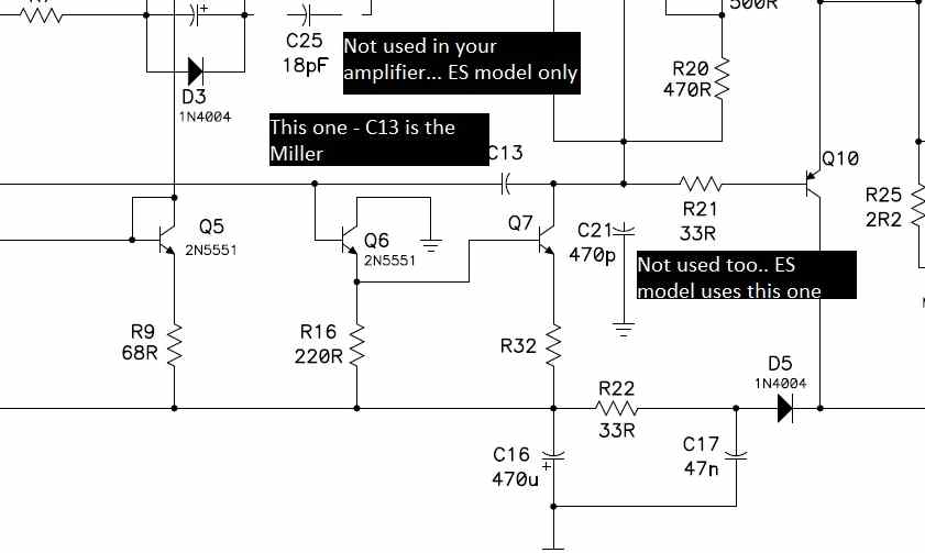

I worked on my supercharged this weekend. I checked every transistor.....all is okey. I changed Q7 from MJE15032 to MJE15030. My DC offset is now -30mV and not 100mV. I measured voltage on bais transistor and is 2.4V. Set bias to 1mv over power transistors and both positive and negative give's the same reading. Now I connect a signal and sound seems ok, but when I look on my scope my negative voltage swing or sine wave have some oscillation on. I will get a function gen tonight and test properly. All resistor and cap values are correct. What can cause my DC offset to be negative? Can you supply me with a schematic diagram with voltages to measure and check my voltages. Other then my DC offset and oscillation on negative voltage swing everything looks ok. I will post some high quality pictures of my amp. Maybe someone can see something.

Where is Miller one....
Try to increase the compensation capacitor, the Miller one.... increase it soldering other unit in parallel or substituting it to a higher value... 150 to 220pf may be interesting.
regards,
Carlos
Hi Carlos.....sorry for the ignorance, but which capacitor in the circuit is the Miller/compensation capacitor. There are 2 x 100pF caps is the circuit.
macd:confused::confused::confused:
This one...increase it to 220pf if you find AC voltage
In your output terminals without signal entering the amplifier...if AC appears, this seems the amplifier is oscilating..then proceed the capacitor increasing..if no AC is present..then no need to replace.
