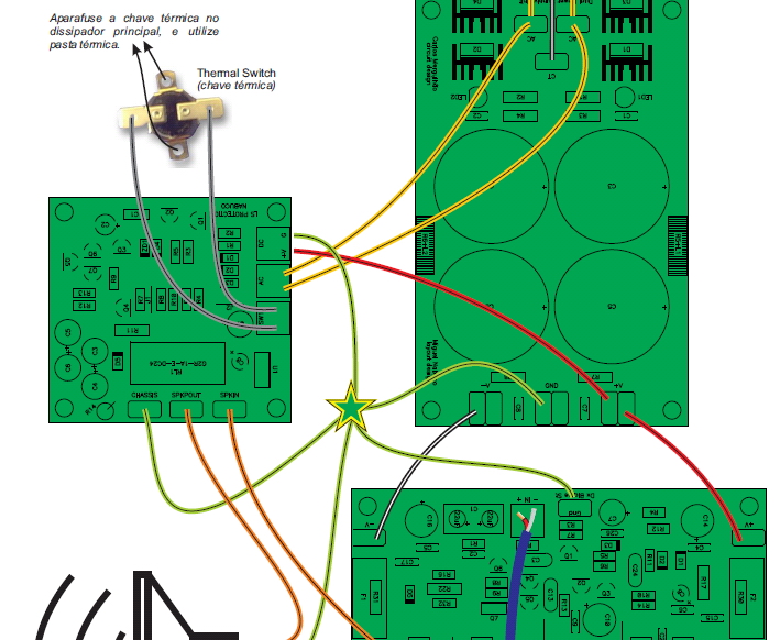

This Diagram shows one chanel. When using 2 chanels does there need to be 2 star points? Or can I just use 1 star point? I will be using 2 transformers, 2 amplifiers, 2 powersupply, and 2 speaker protect boards.As Mitchel gonna reduce it to fit forum maximum size.
regards,
Carlos
Anyone can feel free to answer this question.
Regards
Niss_man
Clean and neat
For a clean and neat amp, make them separate. Being a single case, the effect will be the same, I suppose.
Max.
Regards
Niss_man
Max.
How are your two Star grounding points going to be safely connected to the Chassis Safety Earth?
Consider this scenario:
a pre-amp or other source component with Left & Right channels having a common Signal Ground for both channels.
Now bring this into a two channel, two star amplifier.
No Ground loop.
Connect the two star grounds to Safety Earth. Do you have a ground loop with an enormous loop area that stretches all the way from the source signal ground to the amp Safety Earth?
No Ground loop.

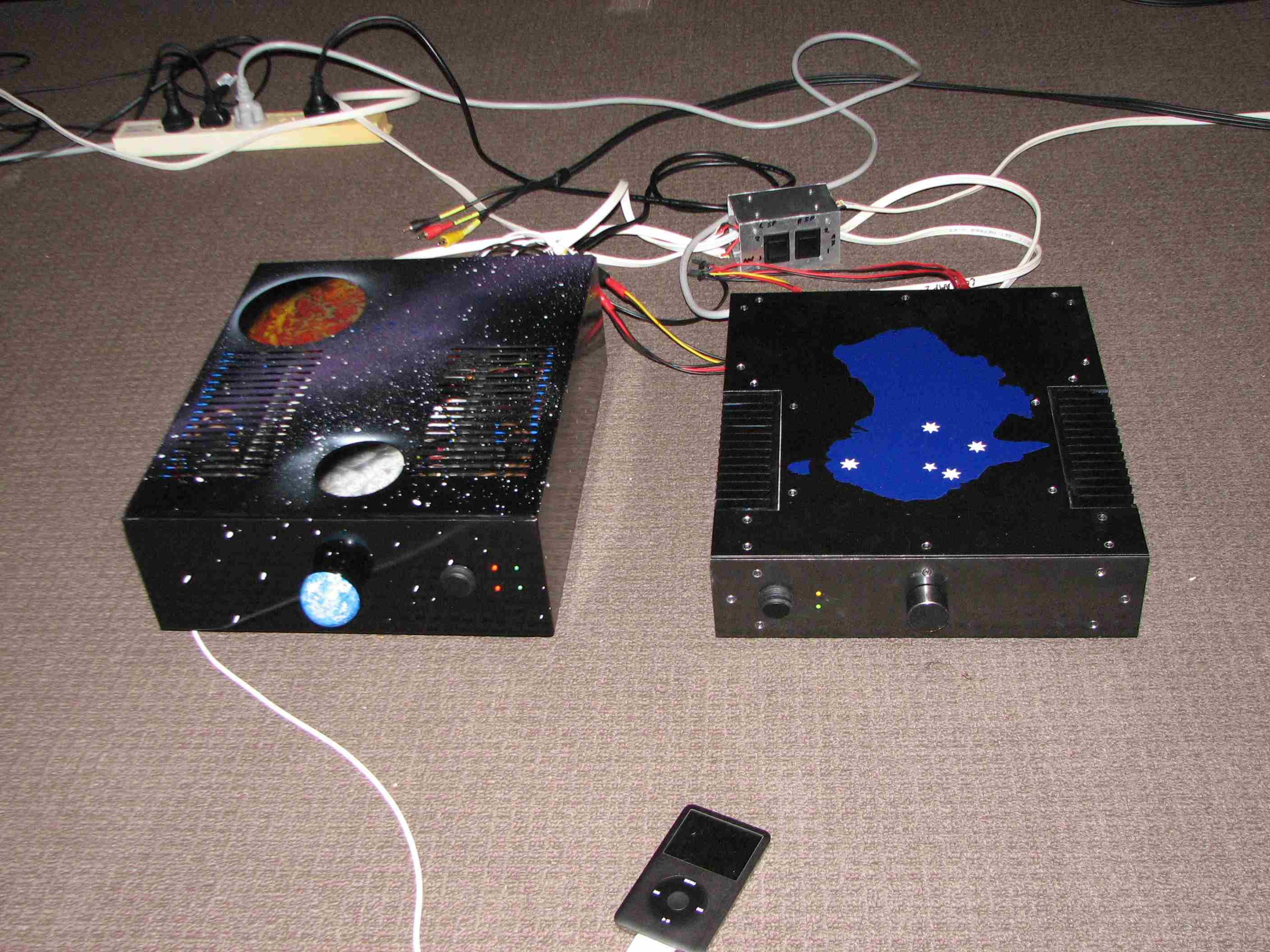

Have built the Blame ES using old symasym chassis on the left. Blame ST on right. Found I had wrong terminations on volume pot on left amp. It is this reason I have removed a previous comprison from U-tube. I am currently comparing between ES and ST. Much more difficult hearing comparison (quite similar). Hard to pick one from another both are excellent.
The new ES has speaker protect and power supply from mitchel and amp boards from Taj's design. Thank you to both.

Have just finished my new comparison between ES and ST models. Used the db meter instead of camera for better sound quality than last video. Tell me what you think.

Nice video. I hear more treble in the Blame ST. The Blame ES has a slightly richer tone. Bass in both sound the same. You have some great speakers mate !!
LOL... you are good Chlorofile .....
The amplfier(s) do have good energy , very good Niss man , Uncle charlie ..
Bravo ..
Now for a big one Uncle charlie ....
very nice tv
I don't know for sure but it seems the amp on the right (blame st?) have slighly less sibilance than the left amplifier.
Can you tell me what's the econd song you played ?
