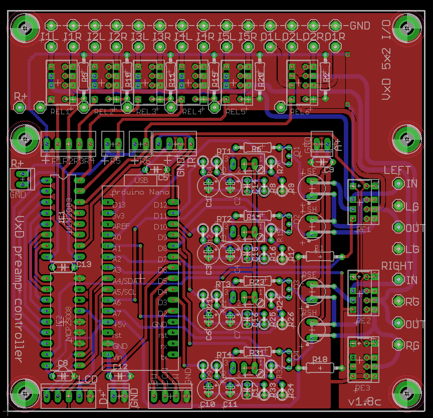

Ultra cost-effective all-in-one, single-ended, 5x2 IO integrated, non-latching relays 10X10cm pcb
Since we are paying anyway for 10x10cm board with chinese PCB manufacturers, why not use the extra space
Takes also 4.5V NAIS AGN200A4H sub-miniature relays I happen to have bunch of

Bug, and possibly a nasty one. When VxD is powered down with volume at 00, and then it turns on, at fist step of volume increase, there is max volume burst that lasts split second.
Can someone check if this is something I introduced with many changes, or is it with original code as well?
Anyone?
Anyone?
Just checked and mine does this as well.
I normally leave the unit powered on anyway so hadn't noticed this.
Chris
Sounds like a full power blast which can be pretty bad. In general, power down sounds dirty too, nothing is muted. I am thinking about separate, always on power supply for arduino which will also allow power control via remote and solve all the transient power issues as well.

Fair enough. I suppose I'm looking at it from a slightly different angle then as my power amp takes 100W at idle, so the few watts consumed by the LDR unit is not significant.
