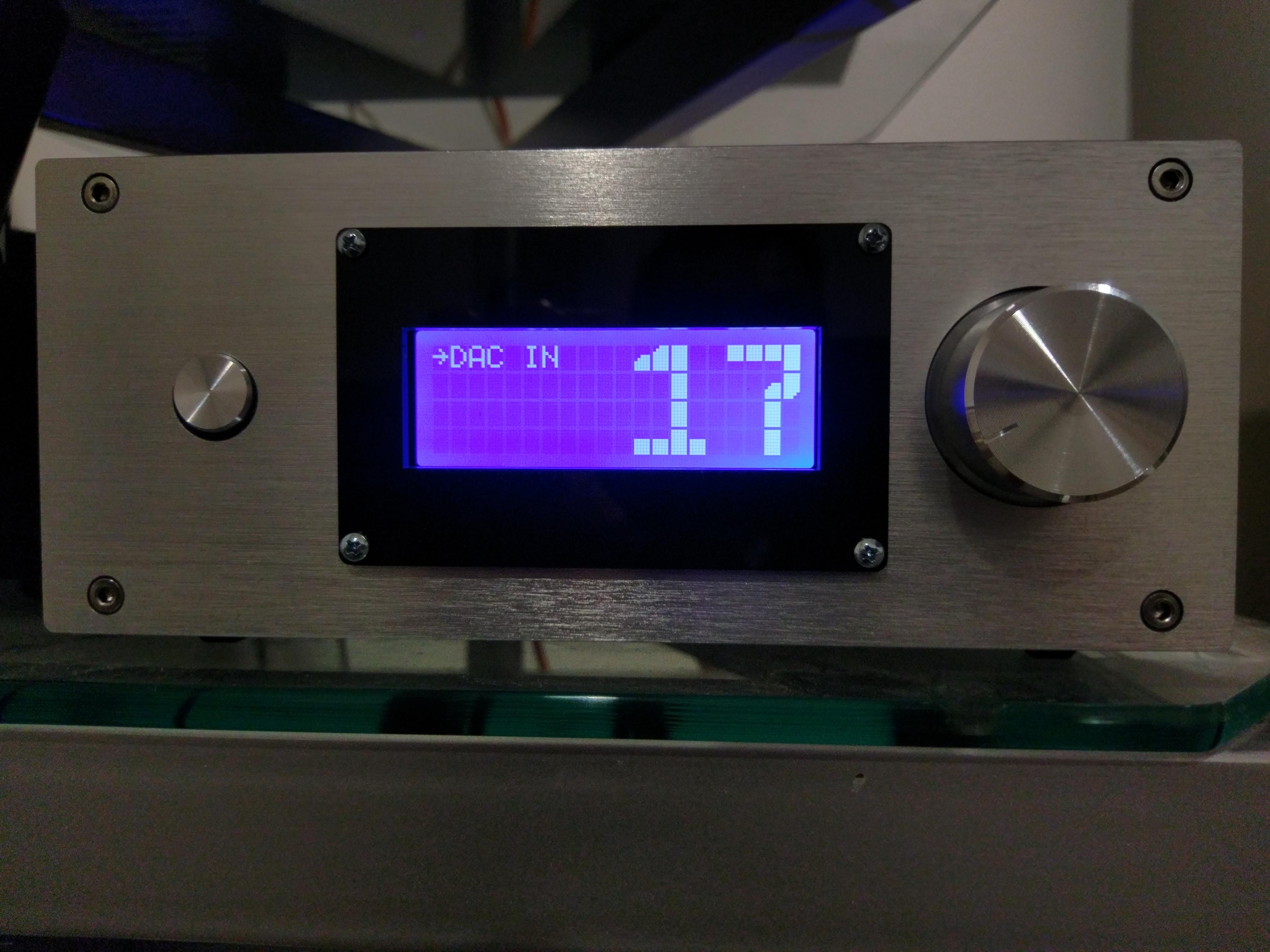

Finally making some progress getting this into case...
