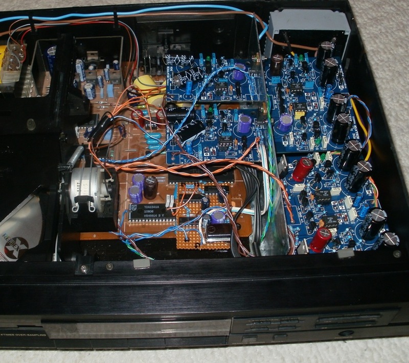

Here's my "Practice" machine, a CD-65 II. Usual Philips PCB and A/B/C chips. I've just finished it, not had a chance to listen to it for extended periods.
Mods are:
- Cut out plastic base and replace with 18mm MDF
- Blu-tack on the underside of the disc clamp
- Removed the voltage selector
- Polypropelene output caps
- Polystyrene filter caps (waiting on the last ones to arrive)
- 2 additional transformers (30VA 6-0-6 toroid and 30VA 15-0-15 sealed)
- Os-con/Silmic/Cerafine coupling caps on the board
- LME49720 op-amps
- "Q-mini" 15V/-15V regs fo analogue state
- "Q-mini" 5V reg for SAA7220
- "Q-mini" 5V reg for SAA7210
- "Q-mini" 5V reg for TDA5708 and clock circuit
- "Q-mini" 5V/-5V/-15V regs for TDA1451
- Full DEM reclock using 0.3ppm TCXO
- 220nF decoupling caps on the divider
In the Arcam I plan to use a discrete output stage, but there isn't much room left in this Marantz case for a different I/V stage.
I plan to perform very similar mods to the Arcam but plan on using Salas shunt regs. Are there any other mods people would recommend?

I have no experience of the "Q-mini" regulators. What is their current capacity? I ask because the SAA7220 is a current hog and sucks about 200mA, which means that all three leg chip regulators need a very hefty heatsink. How is the temperature of the Q-mini feeding the 7220?
For completeness, you could separate the digital and analog rails and give them their own PSU's (and a separate regulator for each power pin of each chip).
For the CD65II, the LME49720 dual op-amp is a very nice but I have found that the LME49720HA, in a metal can, has better focus and bass slam and clarity. Subtle but discernible.
The transport in the photo looks like the CDM4/19, the same as the Arcam transport, so it will probably have two TCA0732 servo chips. These are fed by and unregulated nominal + and – 10V, but closer to 12V when measured. A useful mod is to add –ve and +ve regulators to each chip. I have used 7906/7805 fed from the raw supply and it makes a discernible improvement in base clarity and in focus.

Thanks Joe, all of the regs are capable of around 800mA apparently. In this player I installed a metal bracket/heatsink and the output transistors on each reg are attached to that. The heatsink gets only warm to the touch. The regs supplying +/-5V have their own 30VA 6-0-6 toroid and the +/-15V regs have their own 30VA 15-0-15 potted transformer. The toroid and another dual reg board are hidden on the right hand side. The SAA7220 and SAA710 have dedicated regs on their 5V rails, the TDA1541A has three dedicated for 5/-5/-15V. Another is for the clock circuit and the TDA5708, and the last dual reg is for the op-amps, so 8 regs in total.
I'll have a look at the servo chip, thanks. I'm just starting to bed the player in, with so many new parts it will probably take a while...!
The DEM clock made a massive difference, this was one of the first mods I did (I wanted to get this working before I added all the regs)
