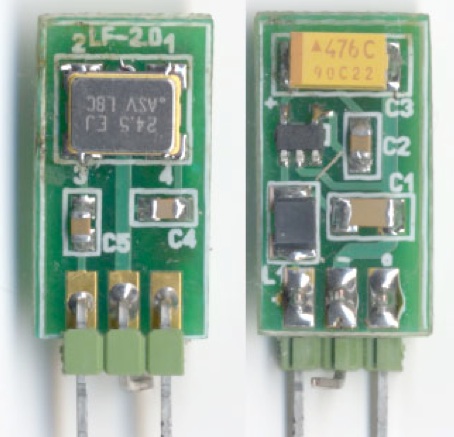

Hello Simon,
I have found the 4mHz crystal on the cpu of the Rotel and it is actually a ceramic oscillator, not a canned crsytal. On the Arcam schematic it appears to be part number 1503.
Tent labs does not sell 4mHz XOs, and there is nothing much on ebay, but I have found a 4 pin XO at RS. Its part number is 226-1976 (AU$7.25). I will get one of these and mount it in a socket with its own clean and quiet supply. If it makes a noticable difference I can then hunt down a really low jitter XO and swap it in the socket.
I would be interested to hear if anybody else has done this mod or is contemplating it?

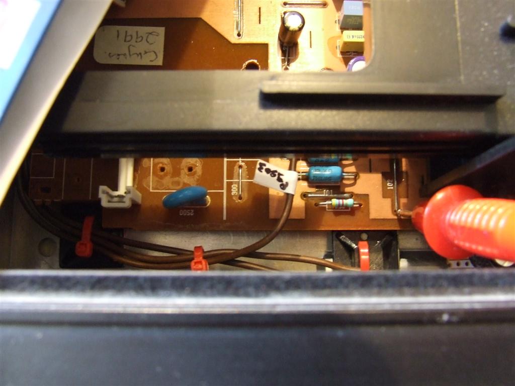

Well I've done some listening to a few CDs and it's sounding great and not skipping or dropping out, and doesn't overreact to physical knocks either. The adjustment seems to have worked well enough, for now.
In the picture the wire link with the probe on it shows where to test for focus offset voltage. The other probe goes to ground. You can also see the 4.7K (laser current adjustment) and 22K (focus offset adjustment) trimpots.
Simon
Simon

The Rotel manual specifies a "Sony type 4 (YEDS 18)" test disc to use when checking laser and focus voltages. I haven't got one but used a normal music CD to reset my the Rotel''s voltages a while ago. The procedure is the same and test voltages are the same. The trimpots on Rotel are tin can type and adjust up through a hole in the board I have drilled holes in the bottom of the case to make this job easier (if I ever have to do it again). The pots look like 500mw type to me.
Did you change the trimpot on the focus offset? There shouldn't be any megaohm values there. For long term reliability I would change the pot, even though its a pain to get at.

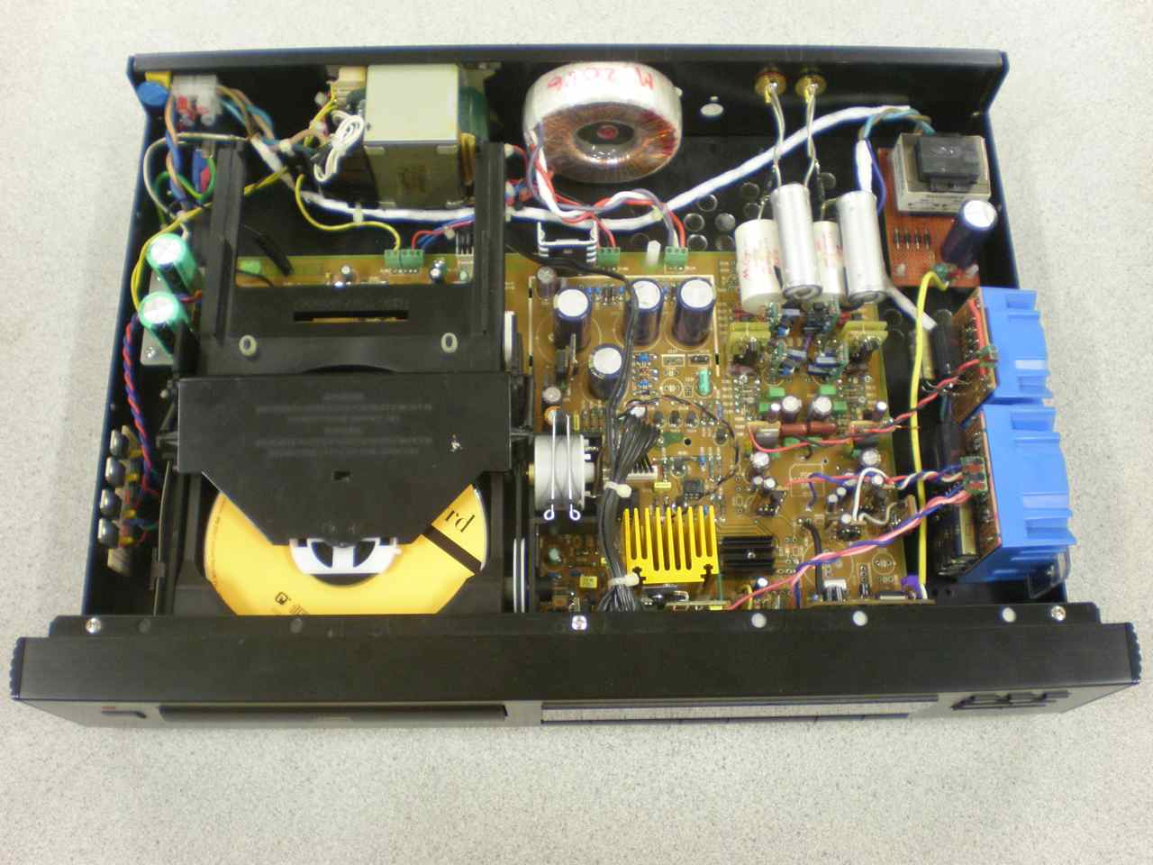

I installed a 7909 and 7809 regulator on each of the servo chips (TCA0372). It may be only wishful thinking, but it seems that the base has tightened up a little more and the presentation is just that little bit more dynamic. It also seems that instruments and voices are more clearly defined, or perhaps more 'separated' is a better description. The improvement is subtle, but my wife noticed it and told me it sounded a bit clearer than before.
The Rotel transport section is so similar to the Arcam and so it seems to me that the Arcam should show similar improvements.
I also added +ve and –ve 5V regs to the TDA8808 Photo diode signal processor (Arcam IC 6501) and the TDA8809 Radial error signal processor (Arcam IC 6503). However, I can't claim any perceptible difference in performance with this mod. It didn't hurt but it didn't help.
The only things left to do on my Rotel is to reclock the 68HC05C8 processor (Arcam IC 6530) and give it a separated +5V reg. Then I will rebuild the SPDIF out.
All of these mods are common between Arcam and Rotel.
I have included a photo of the Rotel, which has a total of 5 transformers, and now 21 regulators. The analog out is a FET stage based on a Nelson Pass paper and sounds better than any IC I have tried. The output caps are Mundorf bypassed with Russian teflons. Very nice.

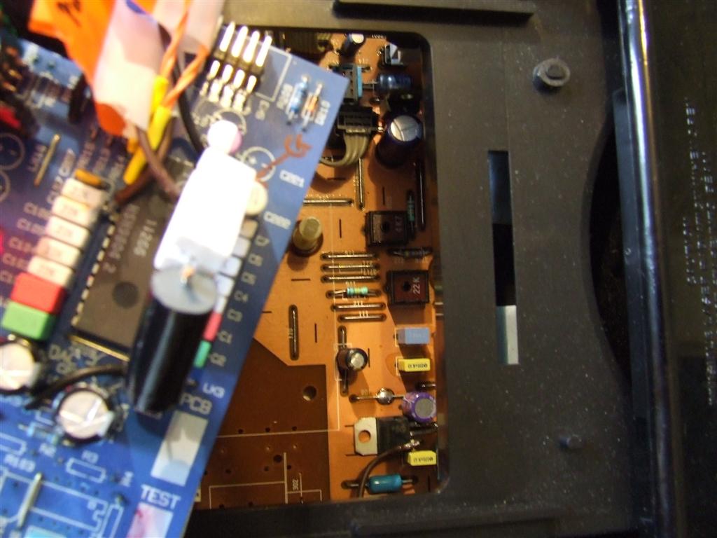

I've had a little time and inclination to look at my recently-stopped-functioning Alpha today. It stopped playing a few weeks ago and I thought it was due to the draw not closing right or something silly like that. Sadly it's not so simple.
It will occasionally read the TOC and once on the "test bench" it started to play a CD. This rules out broken PSU wires or badly broken signal connectors or tracks.
I removed the front panel to access test mode and got Error 2: No Track Loss signal at start-up. Not massively helpful.
I thought the laser was probably dying and I then remembered I had a CD52 and that had a CDM4. Sure enough it's even a CDM4/19 like in the Alpha, albeit visually subtly different in places. Anyway, the laser comes out with the sled and can be swapped so I did that... only to find the same fault. I then put my Alpha's laser in the CD52 and it works faultlessly! So my fault isn't the laser.
I'm now stripping down all my mods etc that are in the way of the "mono board", and I will remove that 22K trimpot that seems to be faulty. Maybe that is the cause of the failure, given that focus test point reading of 7 volts....
I just need to find a suitable trimpot to order now.
